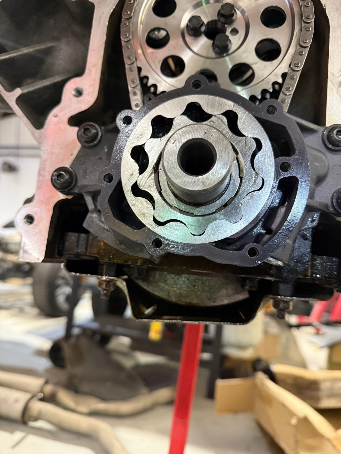

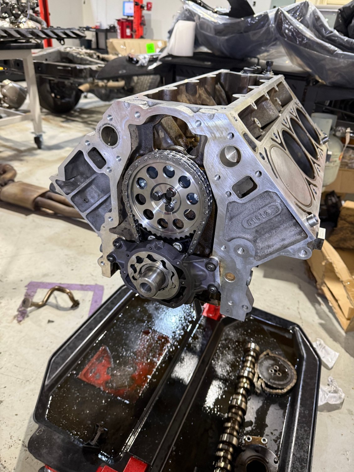

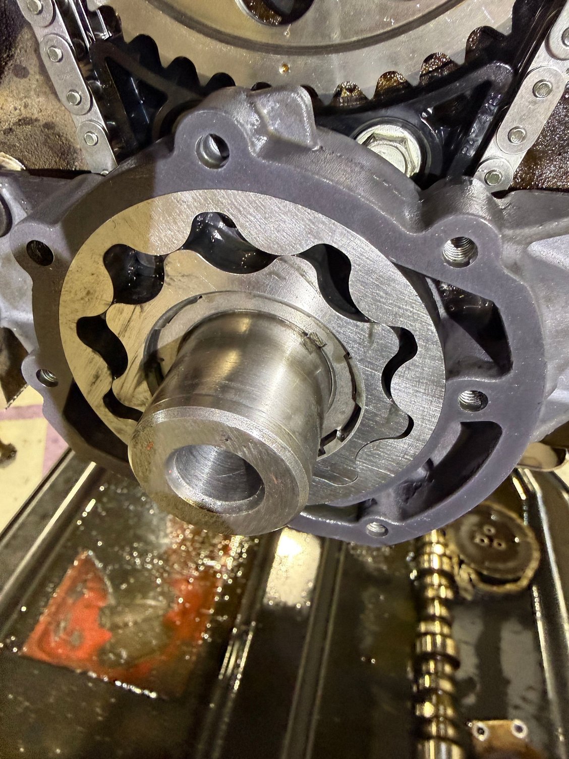

Oil Pump Help
Hi all, just wanted to confirm that my oil pump is sitting right. I’ve got a crow cams double chain equipped underneath my Melling 10296, I’m running the included spacers that came with the chain kit in order for the pump to clear the assembly but now the pump does not sit flush on the crank gear. Just wanted to confirm that this was due to the spacers and won’t be an issue.
Note: I’ve checked for pump being centred and can move the large gear in and out no problem 🙂

Did you use feeler gauges to centre it?

Are the spacers positioned correctly on the pump backside......only reason i mention it is because Beater Bomb had oil pressure issues due to the spacer covering a portion of the feed.

The lack of "flush" won't hurt anything, in and of itself.
Make sure your crank damper can go all the way down into the pump gear and tighten against the little sleevie thing, so that it doesn't bind up the drive gear, which is supposed to "float" freely on the sleeve.
yep - made sure that pump was centered usuing 0.05mm shims all around (0.002 inch)

I have a Cloyes DBL roller and the 10296 pump on my LSX build. I did not take my pump apart to use a feeler gauge or shims and for all I know mine looks similar to what you had going on there. IMO there was still plenty of engagement on the oil pump gear.
