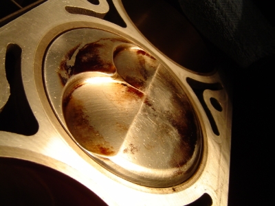

Attached is a pic of a domed piston similar to what JRP is running. +6cc's.
Attached Thumbnails Preferred method for high compression?-dsc00612.jpg   Preferred method for high compression?-dsc00613.jpg   Preferred method for high compression?-dsc00617.jpg

Looks like the majority here is small chambers. The problem with that is the more that you mill, the thinner the head surface, more possibility of a crack. If you mill too much, the heads sit lower and the intake bolts and ports don't line up. Maybe that is not a problem on LS motors?? I like big domes, and deep pockets for valves. If you have ever had a valve hit a piston due to a weak spring, you know what a disaster that is. Big domes, heads not milled, everything bolts up fine. What I am reading here is that there are performance gains with the small chamber..
