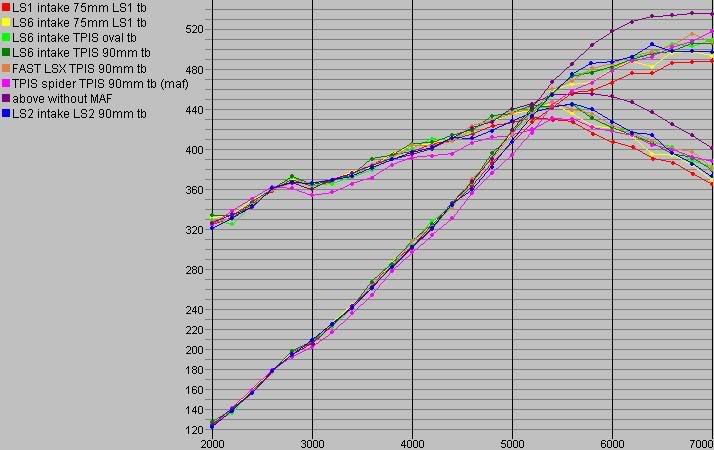

I did a quick search on this but only found comparisons of the LS6 and the fast intakes. I am installing a MS3 cam and UD pulley and wanted to know how much better the flow is on the LS6 intake. Money is an issue as this is a big job and then on top needs to be tuned, so is it worth the roughly $350 for a used one? Can anyone show dyno charts or at least give me first hand knowledge? Thanks!

http://www.tpis.com/plog/index.php?o...Id=14&blogId=1

Thanks not super clear to me but it looks from the article that the LS6 doesnt really make a difference till 5k rpm?

that more clear?

ls1 - ls6 makes a solid and worthwhile difference. It will really make a world of difference once you cam the car.

Yeah that graph helped me really see it better. I think I will get it one now, cause I dont want to restrict the cam.

looks like removing the maf is better than having a good intake? or am i misunderstanding, what intake does my 2004 gto engine have?
