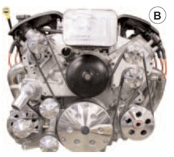

Did you try Street & Performance?? They have all kinds of pulleys etc.
