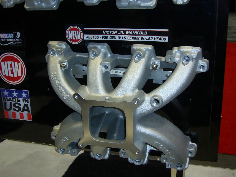

Hopefully someone has a setup like this and can give some good input..
I currently have the L76 Intake on my L92's.
I was thinking of going to a Victor Jr. for them Heads, keeping it EFI and getting some Fuel Rails for it, and then using my 90mm Throttle Body with this Elbow..
The Cam I have is a 243/247, .621/.612, 114+3 LSA
Compression Ratio is about 10.7:1
Does anyone think that I will see a gain going to that setup from the L76, and where do you think it would be?

I guess Edelbrock plans on releasing this in early January.. this was the one that I had found doing my Research..
