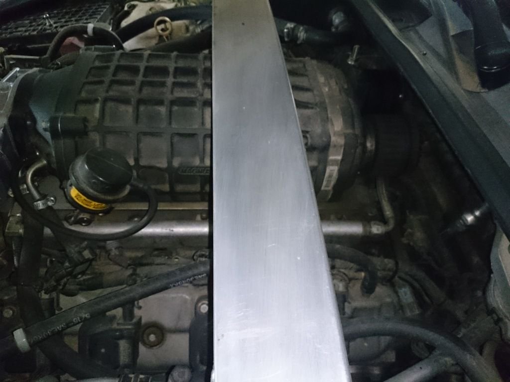

for those cubes and boost you will either need to run both valve cover existing ports to the can OR use an oil fill adapter like -8 or 10 to give adequate venting of the engine to the can.
pcv can will do a better job at idle and part throttle to keep venting from happening into the engine bay.
the particular hose connections are best determined (at least by me) if i can see the engine bay. are you sure each valve cover only has one barb?

custom intake with barb:
driver side - valve cover barb - vacuum ports at maggie snout:
passenger side:
engine bay:
