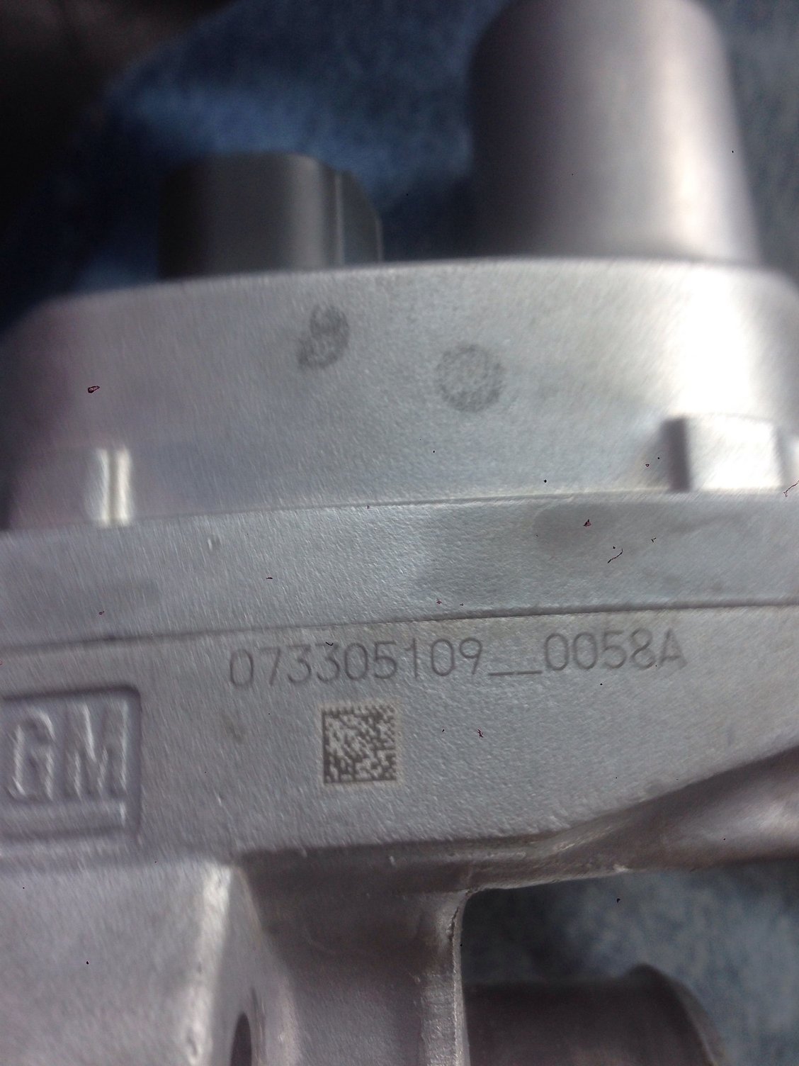

I bought a used FAST 102 intake and he also sold me a throttle body that he was calling a LS3 tb. part number on it is 073305109_ _0058a. I cannot find anything on this throttle body and need to know so I can sell it. I got a ported LS2 tb to install instead. any help would be greatly appreciated. thanks!

I can't see where that's a valid part number. 90% of GM numbers will be 8 digits. some wheels and some older parts are 6 or 7, however I haven't seen many new parts come through that aren't 8. stock camaro LS3 throttle body number is 12605903.

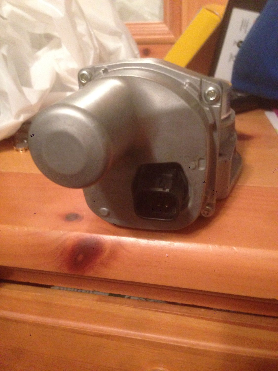

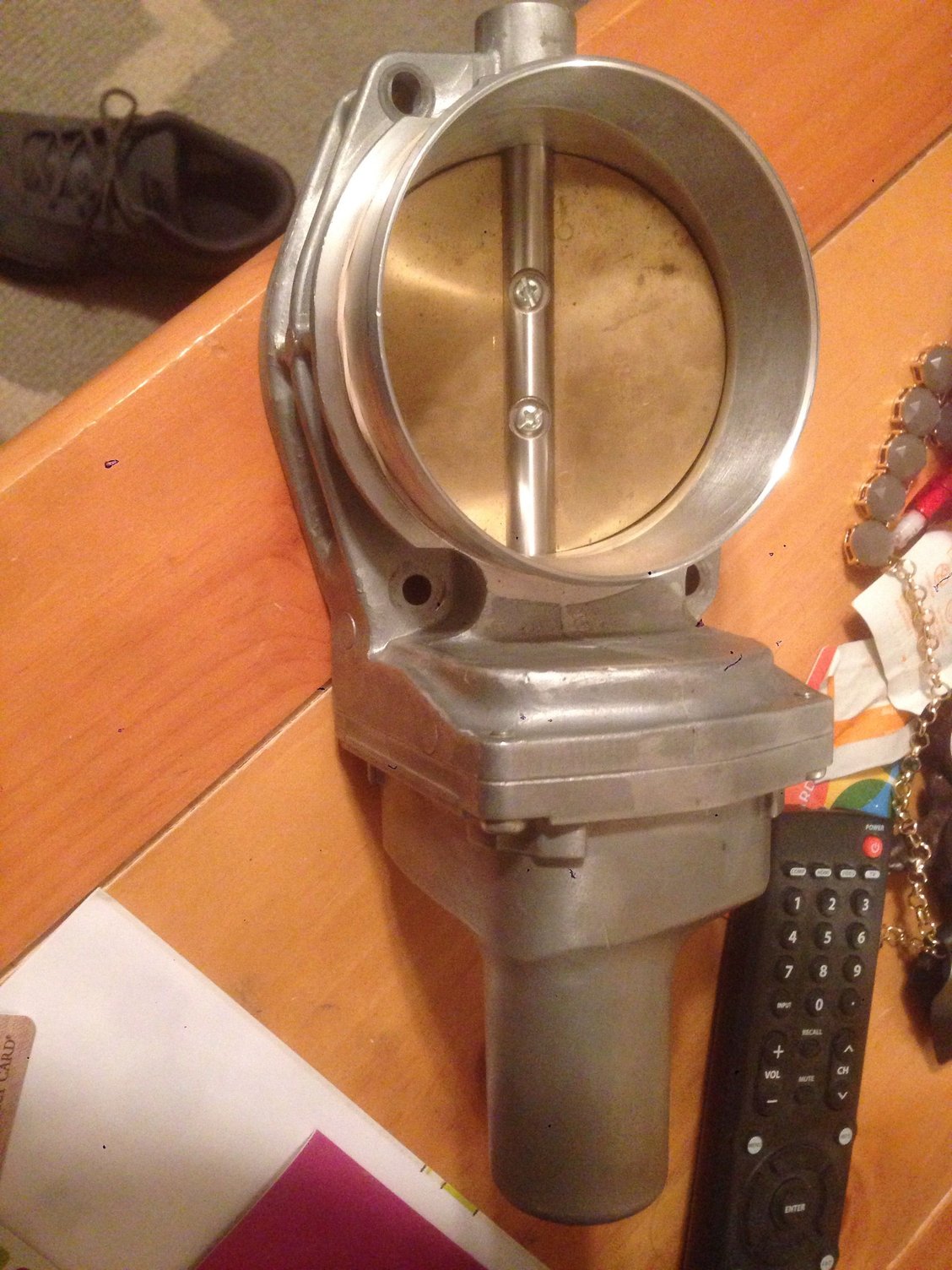

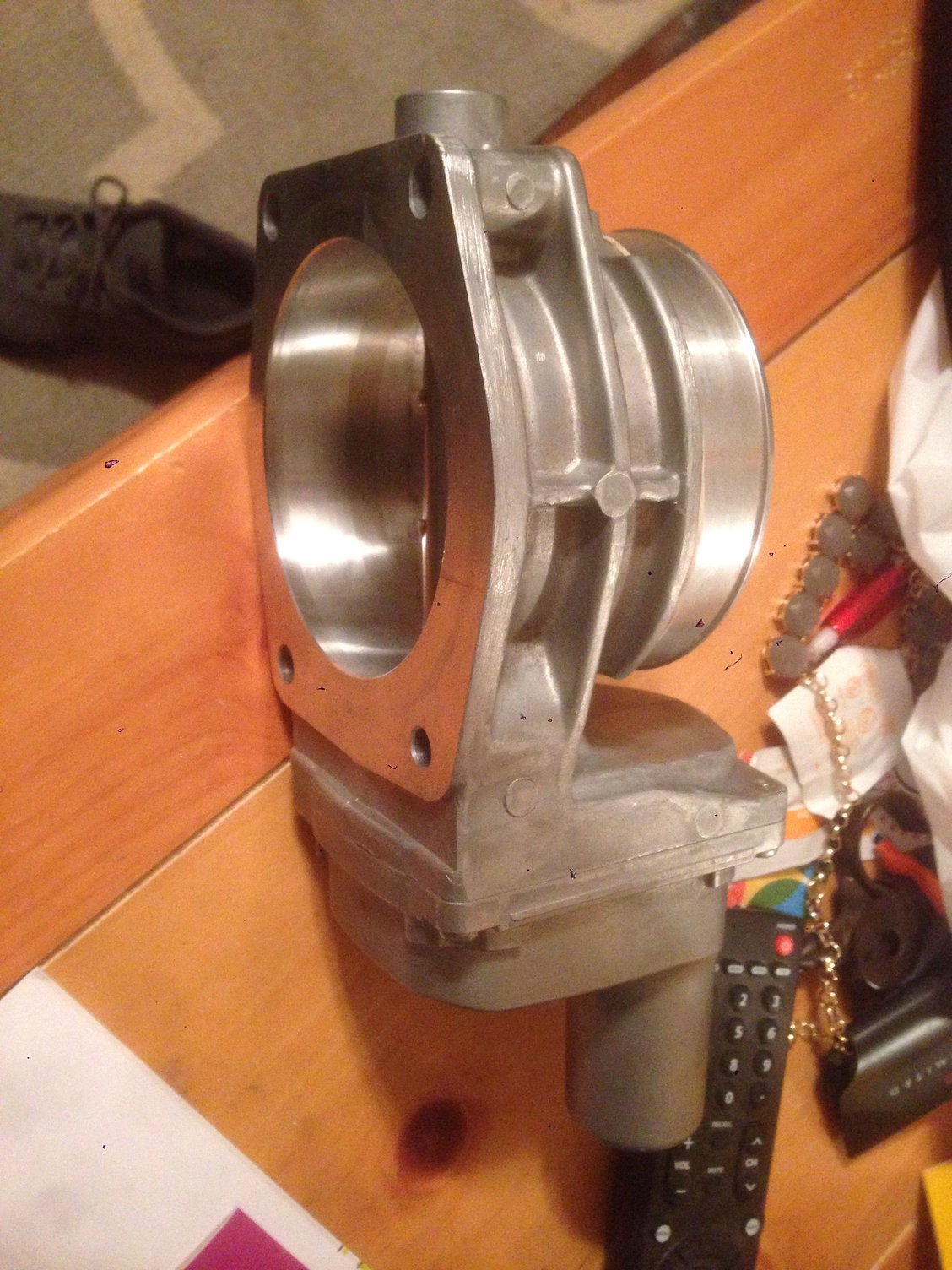

Here are the only numbers I can find

have you tried scanning the barcode below the numbers with a smartphone? that may provide some insight. i can see the GM logo cast in there, but that number simply doesn't work. are there any other numbers cast into it like the GM logo?
Old Jun 12, 2015 | 02:17 PM
klowry06's Avatar
Joined: Jun 2015
Posts: 4
I've tried to scan the barcode but it's extremly snall and my phone won't focus on it. And no there not any other numbers on it. I'm puzzled

how about a better picture of the throttle body overall. I've looked in our catalog at work as well as a casting number search and come up snake eyes for that number.

Old Jun 12, 2015 | 11:13 PM
Matthan's Avatar
Joined: Jun 2015
Posts: 36
Default Need help indentifying LS3? throttle body
I dunno man, I'm stumped. looks like a stock piece to me.
Old Jun 19, 2015 | 05:37 AM
427 zeo6's Avatar
Joined: Mar 2012
Posts: 131
Gold throttle blade.....its a LS3/LS7 throttle body.
