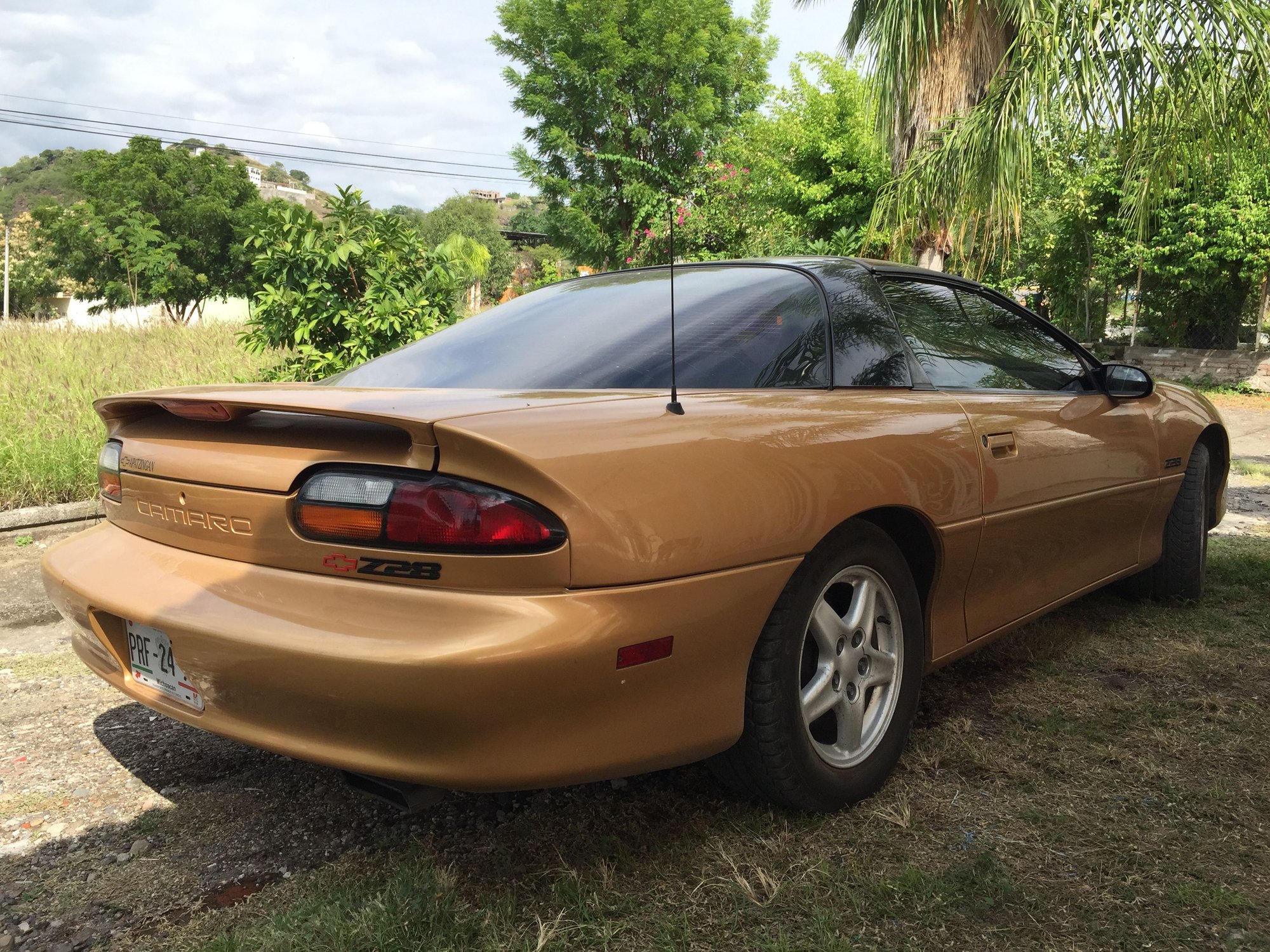

Nice ride btw! That color is pretty rare isn't it?

Alright thanks for the info. Yes it's the rare sport gold metallic color, with only 17k miles. It's a 1 owner car as well.
