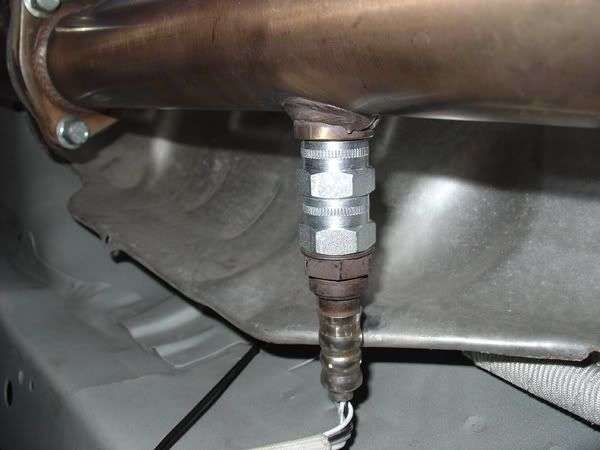

Originally Posted by ICRAZY6
It will be fine. Something you could do to get rid of the SES light is to connect the O2's but zip tie them up under the car. Only problem there would be if they got wet.
OR try this.
Old May 6, 2016 | 05:48 PM
imma_stocker's Avatar
iTrader: (19)
Posts: 1,155
Likes: 37
From: Country
Go buy 2 "spark plug non-foulers" from your local parts store. Drill them out and tap them to match your rear o2 sensors. Then install your new spacer to the exhaust and sensor into the spacer.
Should be this when you're done...

^ ive seen that, people space them out and put them back in. I think I'll give that a try. See what happens, was just worried about messing something up lol. And I know my car is definitely not lean, she gives a good spew of soot on the rear bumper after about a week, she's going in for a re tune after my trip to the cruise in two weeks.
