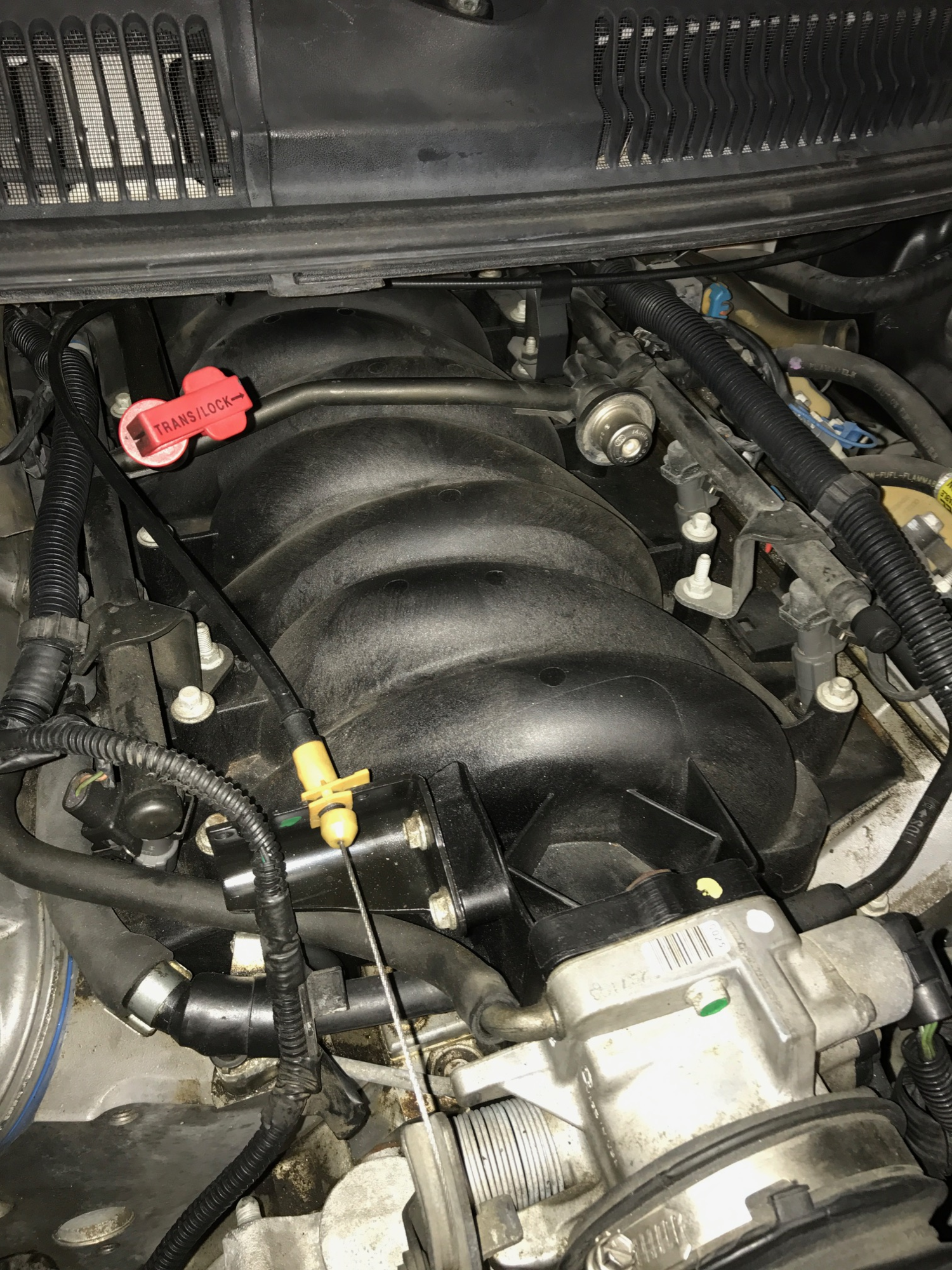

bought this 01 Z28 and was told it is bone stock but my intake appears just a tad different than other LS1's ive seen. Do i have a different intake than what was originally on a stock LS1?
Old Apr 29, 2017 | 10:39 AM
Posts: 22,291
Likes: 3,615
2001-2002 Camaro LS1's came with the LS6 intake manifold. Cool, huh? Now you're only a cam and set of 243 heads away from an easy 400HP...
