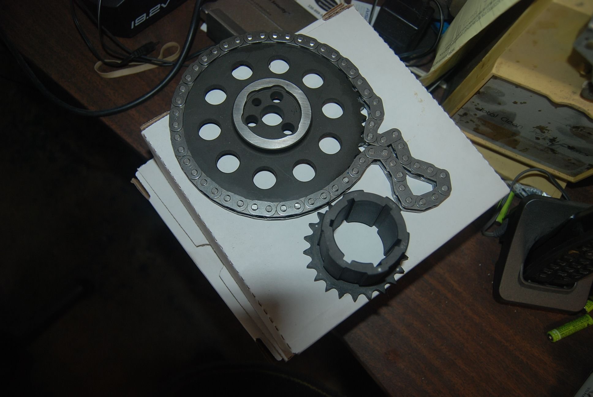

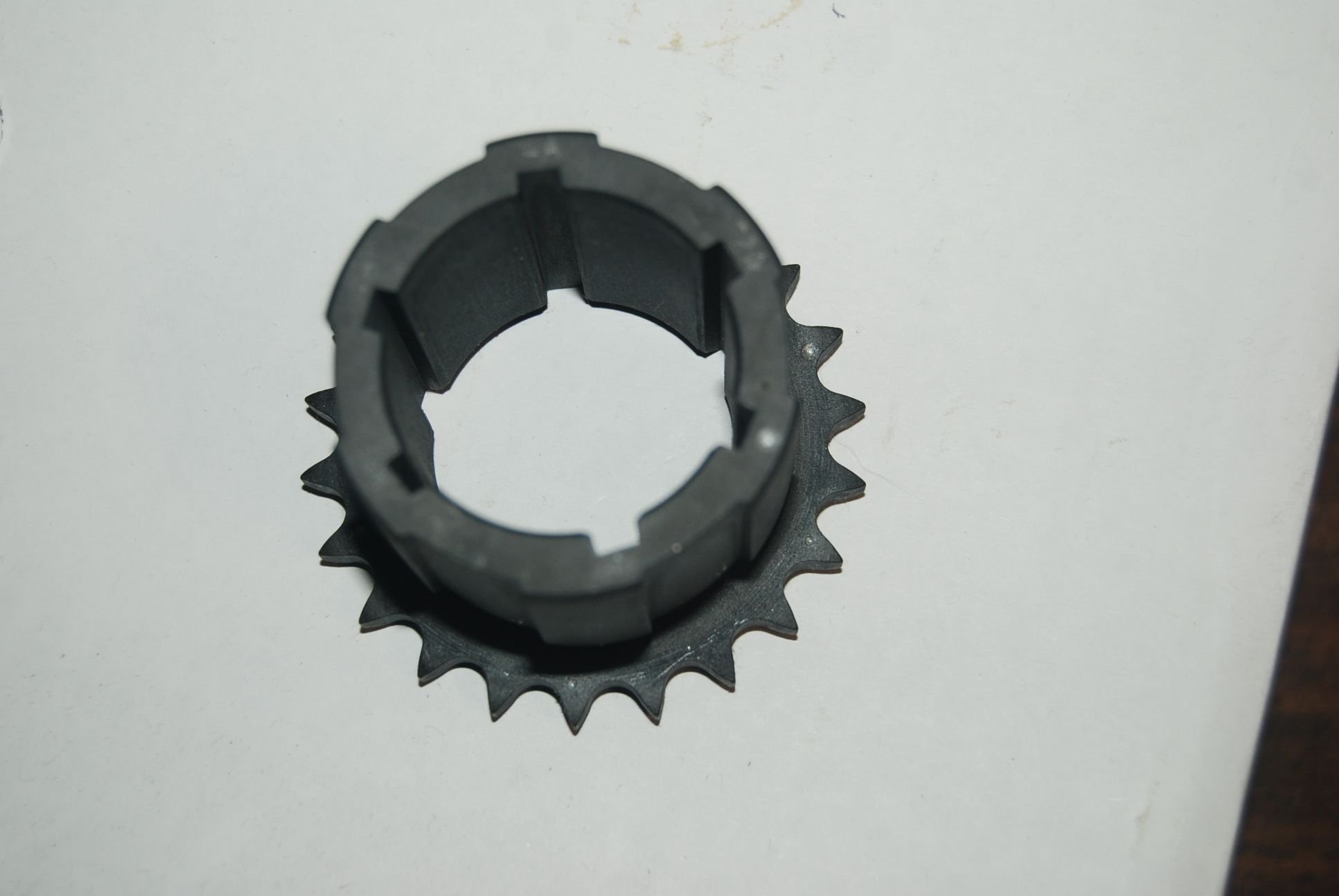

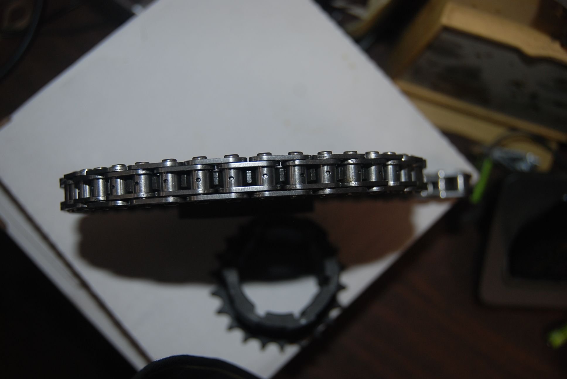

Hi Getty, YES agreed, you will need to fit a 1/2 Moon Cam Timing Sprocket.
I sell the Avon Billet Timing set for a cost of $158.00 + USPS of $10.00 shipping.
YOU WILL NEED to switch the TWO OUTSIDE wires side/side for the NEW front cover sensor. (push-to-seat)
