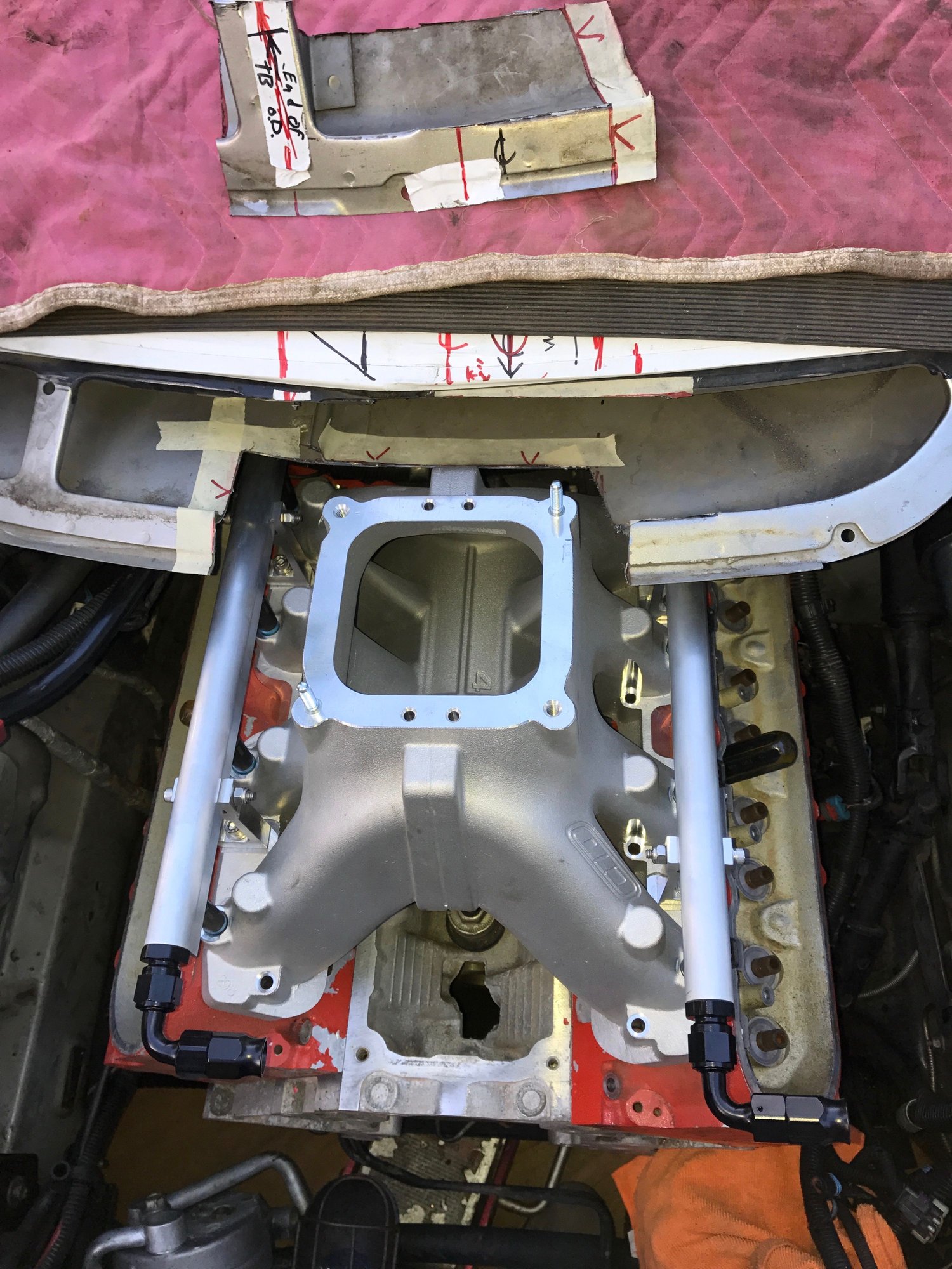

Old May 26, 2019 | 05:02 PM
GtoProject's Avatar
Joined: Oct 2011
Posts: 175
Likes: 21
From: Eastern PA --> Southwest VA
Finally got it done and on the dyno. Dyno numbers were garbage as I was chasing oil leaks and electrical issues. Finally got it all figured out but as hitting a wall just at convertor flash, turns out my high mileage truck coils are starting to take a dump and aren’t able to spark the plug enough overcome the cylinder pressure. I currently have coils on order so power numbers are unknown for now. Otherwise the car runs great, it’s actually very bearable considering a 4000 stall, spool, and a giant cam. Throttle response is very good considering the 4500 accufab as well. After the dyno I took the car about 450 miles on the highway and averaged almost 19 mpg with a stalled 4l60 and a 9” with 3.89’s on 93 (this was going from sea level to about 2500ft elevation), I am impressed to say the least.
The wiper had to be moved over 4”", the wiper arm had to be extensively modified, the cowl was cut significantly, a custom offset 4500 dominator filter base was fabbed, and a new water drainage system was fabricated for the cowl. It all just fits under a vfn 6”" cowl hood with a 14"x2.5" filter with a filter top. Wipers look and work just like factory from the outside and you honestly can’t really even tell they’re moved unless you’re looking for it, wipe pattern is dead on. Overall I think the entire project turned out well, I’m just waiting on coils and a real dyno number, should be capable of low 10’s in full street trim n/a.

Here is my new setup retaining a stock height/stock deck block. It does have a MWC k-member now, but the engine is sitting in the same location as stock on ict billet solids. With my accufab 4500 I have plenty of clearance between my hood and the throttle body, with a vfn 6.5" hood. I have enough space that I'm sill able to run a 14x3" filter on a modified 4500 filter base and still retain the wipers. You should have no issue fitting under a 4.5" hood without a filter and still getting adequate airflow. A 4150 should be about the same height, depending on what you use and what spacer is also used. For max clearance I'd suggest just running a 4500, accufab was the shortest I could find at the time, but I'm not sure if there are many other options even now. I run this daily on the street throughout the year in Virginia and I haven't had any drivability issues since I got my tune figured out.
