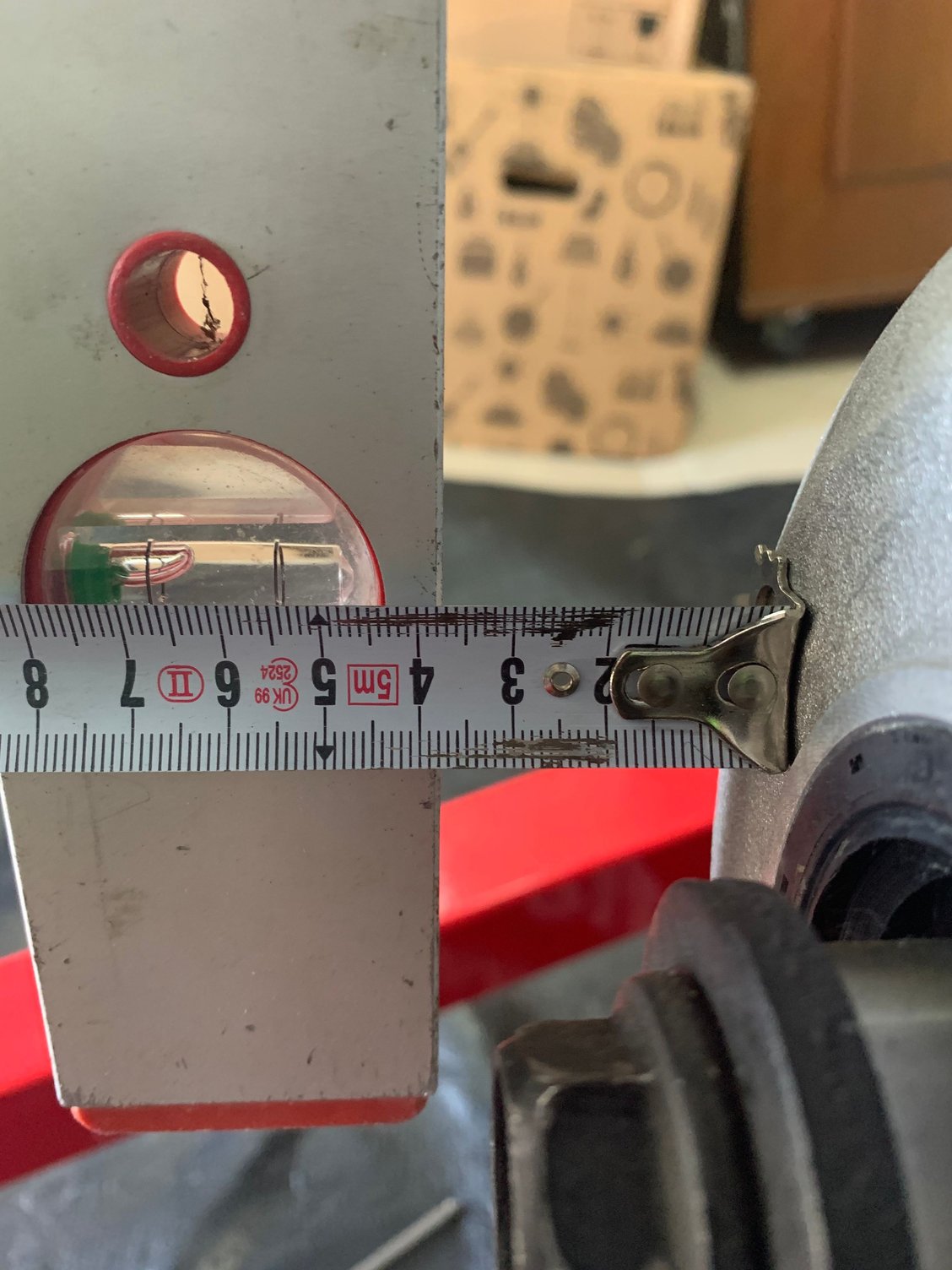

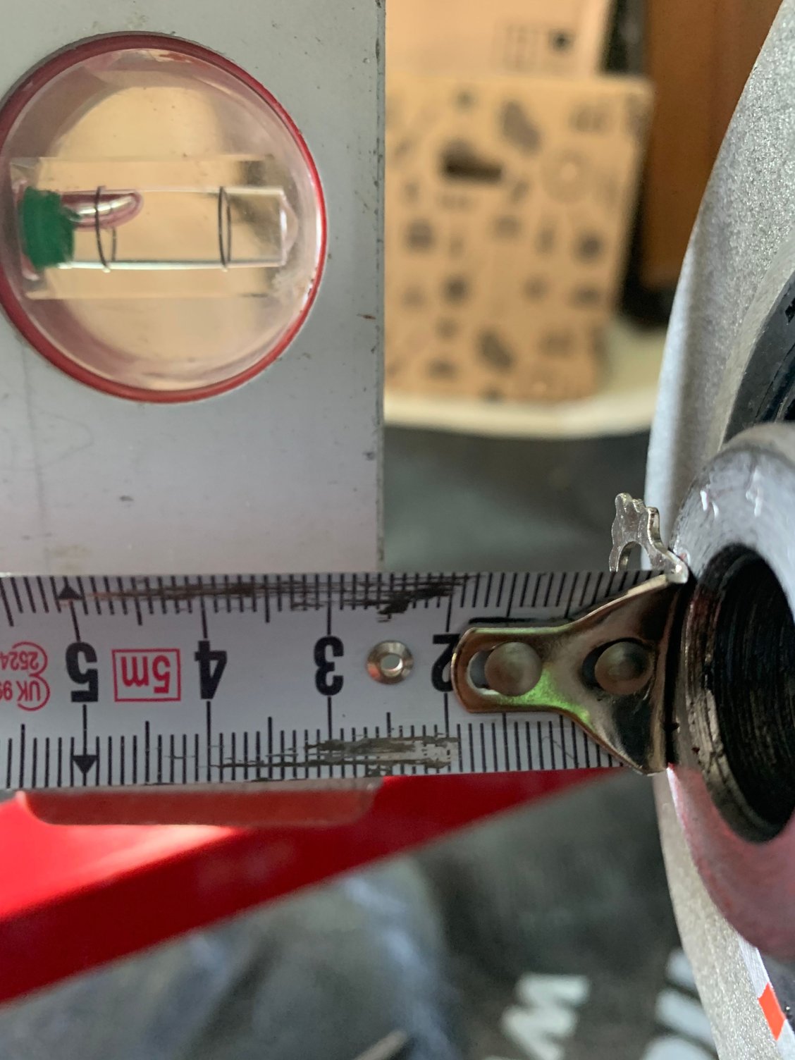

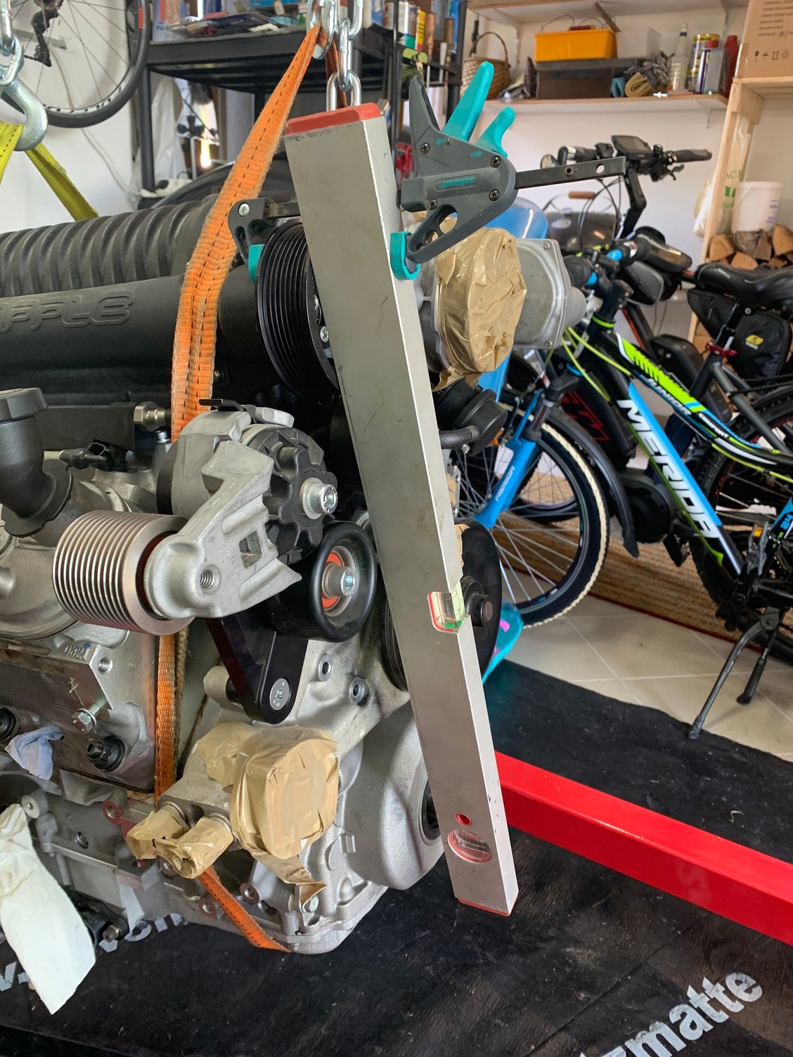

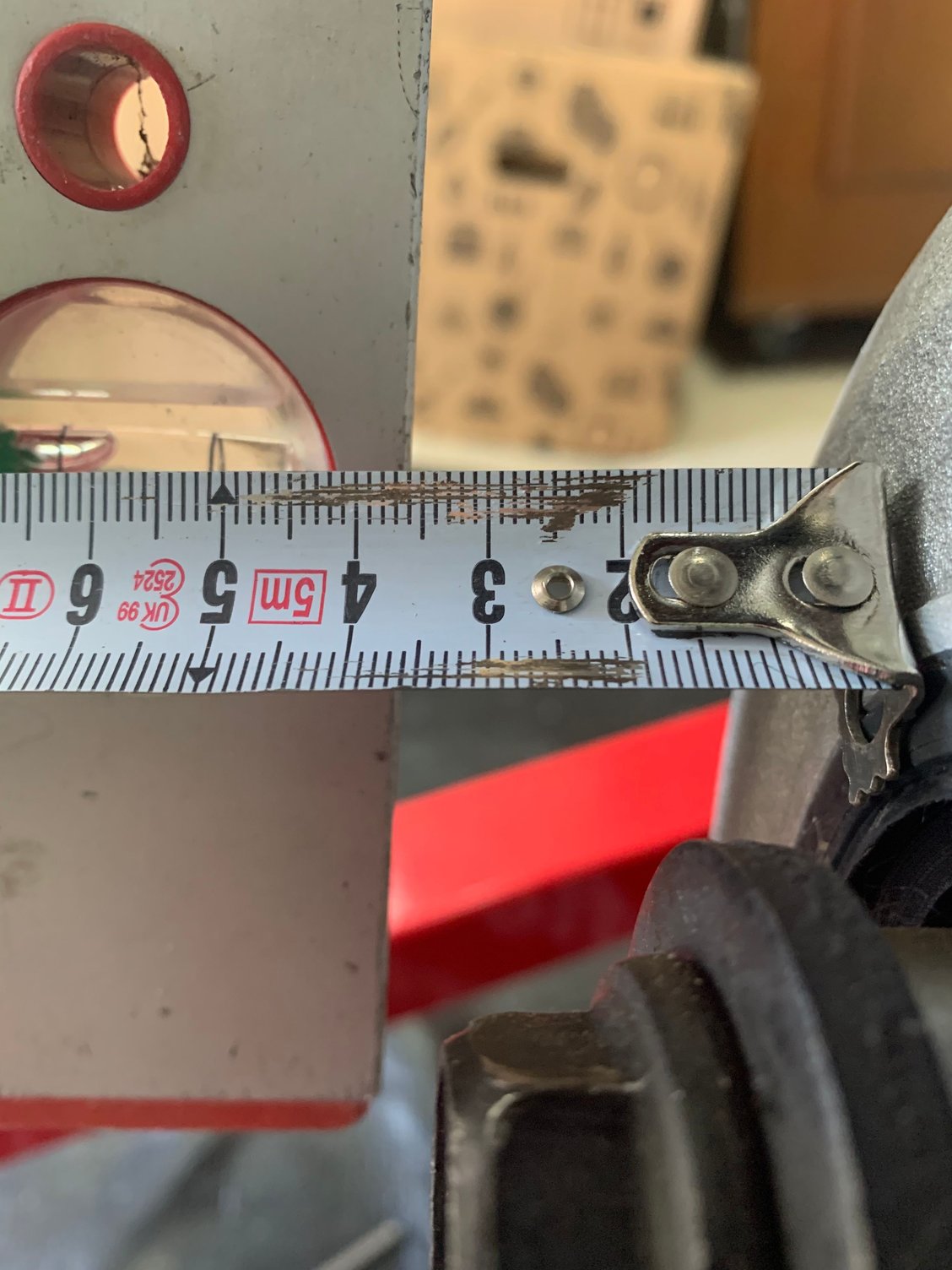

Hello,
need some help to find the correct balancer. THX !!
It is a LS3 engine with dry sump LS7 (including pump). The Balancer needs to fit the distance of the Whipple pulley.
What I measure is from outside Whipple plulley to crank, the distance is 25mm (0,0787402").
Could you please help me to finde a balncer. THX
Could this fit?
Link
LINK

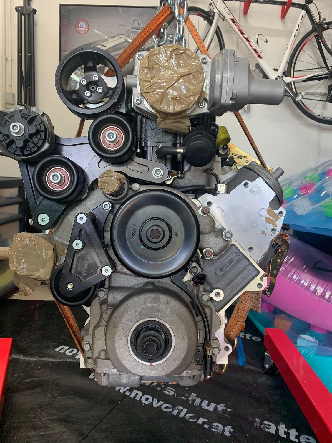

Old Aug 4, 2020 | 03:50 AM
LS3Whipple's Avatar
Joined: Mar 2019
Posts: 42
You can also look at ATI's website, they have all the dimensions of their different hubs and balancers. I wouldn't bother calling them though, their customer service sucks *****.
Talked to Summit, Whipple and ATI
A Y body ls3/ls7 dry sump damper with 8 ribs and no rear 4 rib a/c pulley is damper part number 918620N
now I need to finde the bracket for alternator with two belt-rollers ??? Servo can not be fitted, but for the belt there is a roller needed.
thx
