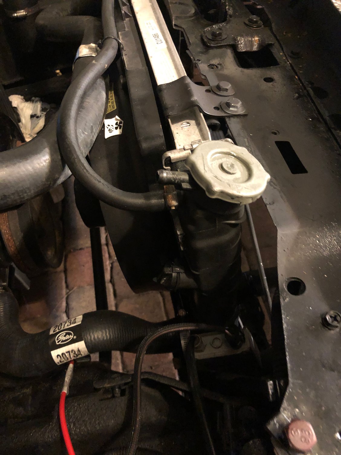

See ls1 fbody radiator
is the bottom nipple for steam port and top nipple is for overflow ?

, Bottom goes to your steam port outlet, top to overflow reservoir.

Those radiators work well, I’m using one with both fans triggered at once with a 40 amp switching relay. it brings down temps quickly.
