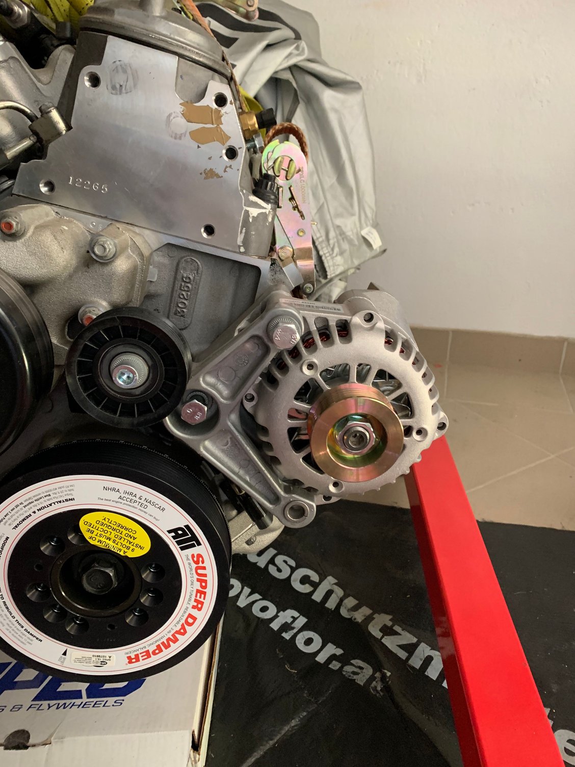

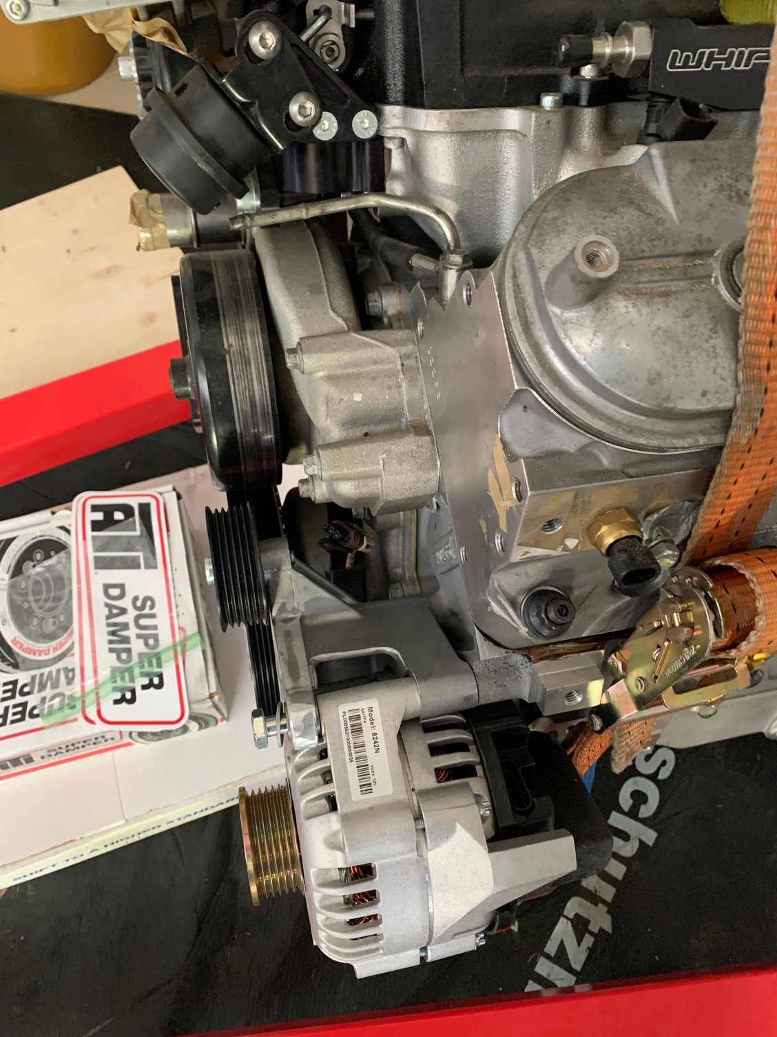

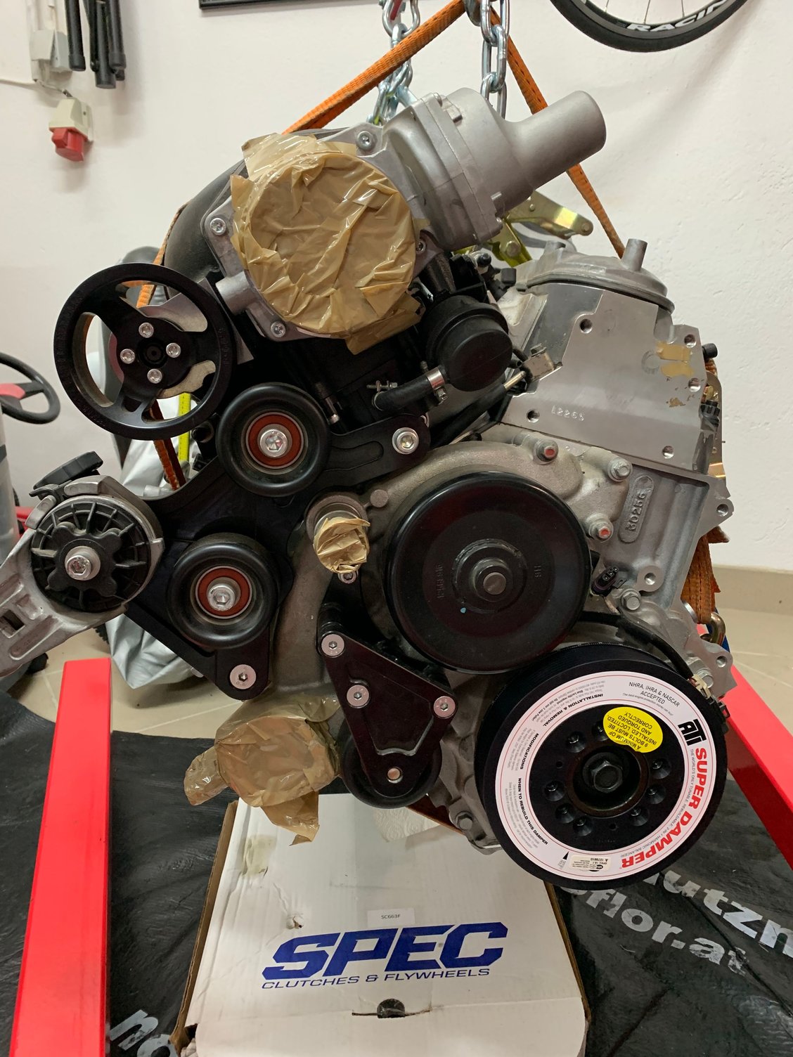

I am looking for a mount to fit the Alternator and 2 belt pulleys without the servo pump.
In my Cobra there is no place for the servo pump, only 1 belt pulley would not ensure the correct wrap of the rim around the balancer and the Alternator
A Y body ls3/ls7 dry sump damper with 8 ribs and no rear 4 rib a/c pulley is damper part number 918620N
Is there a mount out there or does it needed to be custom made ?
An option I think would be to shorten the Camaro mount to align the alternator and the belt pulley, on the mounts for the servo pump (valve head) a custom made adapter to hold the second belt pulley. ?
THX
this is a Camaro mount, does not have the correct alignement and a second belt pulley is need instead of the servo pump
