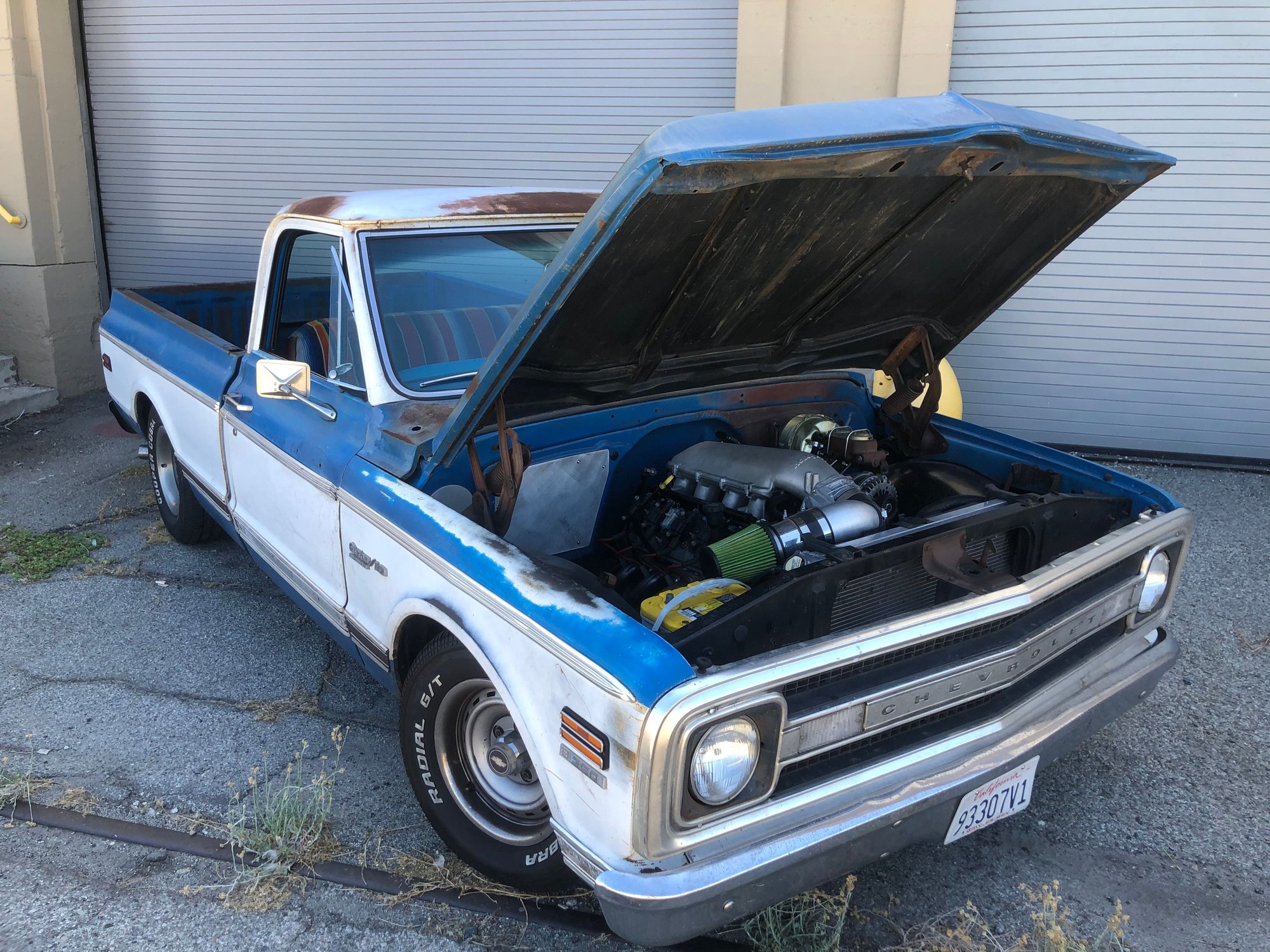

Hey y'all,
I have a 1972 C10 short bed with a L92 and TR6060 swapped in it. The L92 has long tubes, BTR stage 3 LS3 cam, LS7 MAF and a Holley Hiram 103 (yeah yeah I know not the best choice for power but damn she looks killer). When I was an auto (6L80) i had random lean codes every month or two, but only after long drives. I would clear them and they wouldn't come back on so I would just forget about it. My tuner (whose the guy in my area) swore and up and down that i have more then enough fuel, which I believe because it runs great and hauls *** at the top end. Weirdly though AFTER we swapped in the TR6060 (greatest decision ever) I have been getting Constant Lean codes. Sometimes its P0171 and sometimes its P0171 and P0174. The truck runs amazing and first we thought it was the OLD Bosch O2's being grumpy so we swapped them to Denso sensors but same lights. I am not sure if its a vacuum leak because sometimes only Bank 1 gets a lean code. I have a feeling it might be the Long tube headers leaking where they meet the cylinder head since the exhaust at the collectors had to be redone to fit the Tr6060. Are there any tell tale signs? I don't have a strong smell of exhaust in the cab or under the hood anymore then I always had.
Anyone have any thoughts on what it could be? Seeing that CEL is such a buzzkill when your bullying other cars and cruising having a fun time.
Pics for Attention
