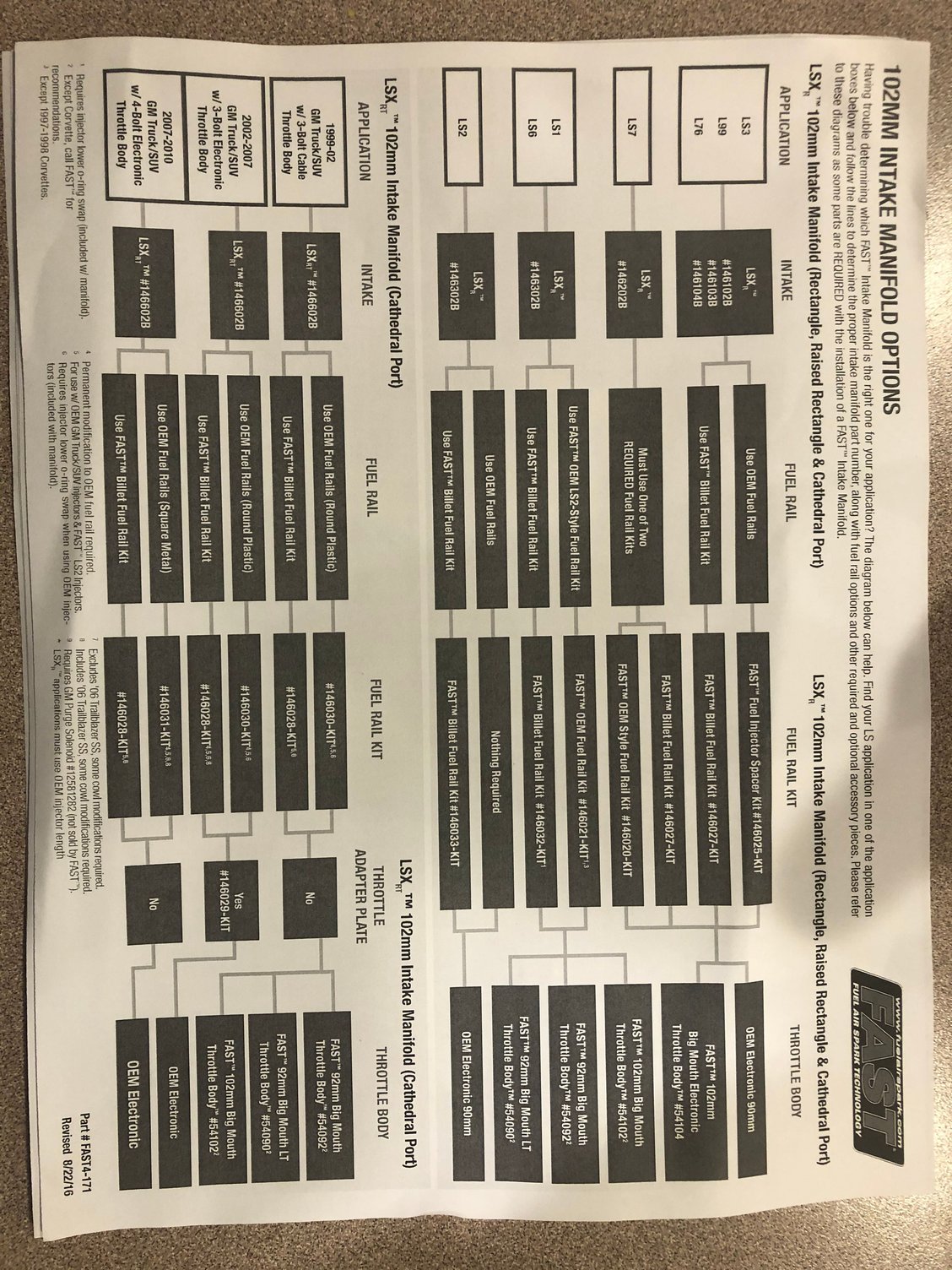

This paper came with the fast. Would be beneficial I think to someone. This is not on their website.
