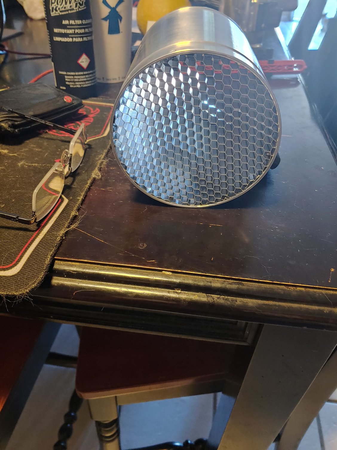

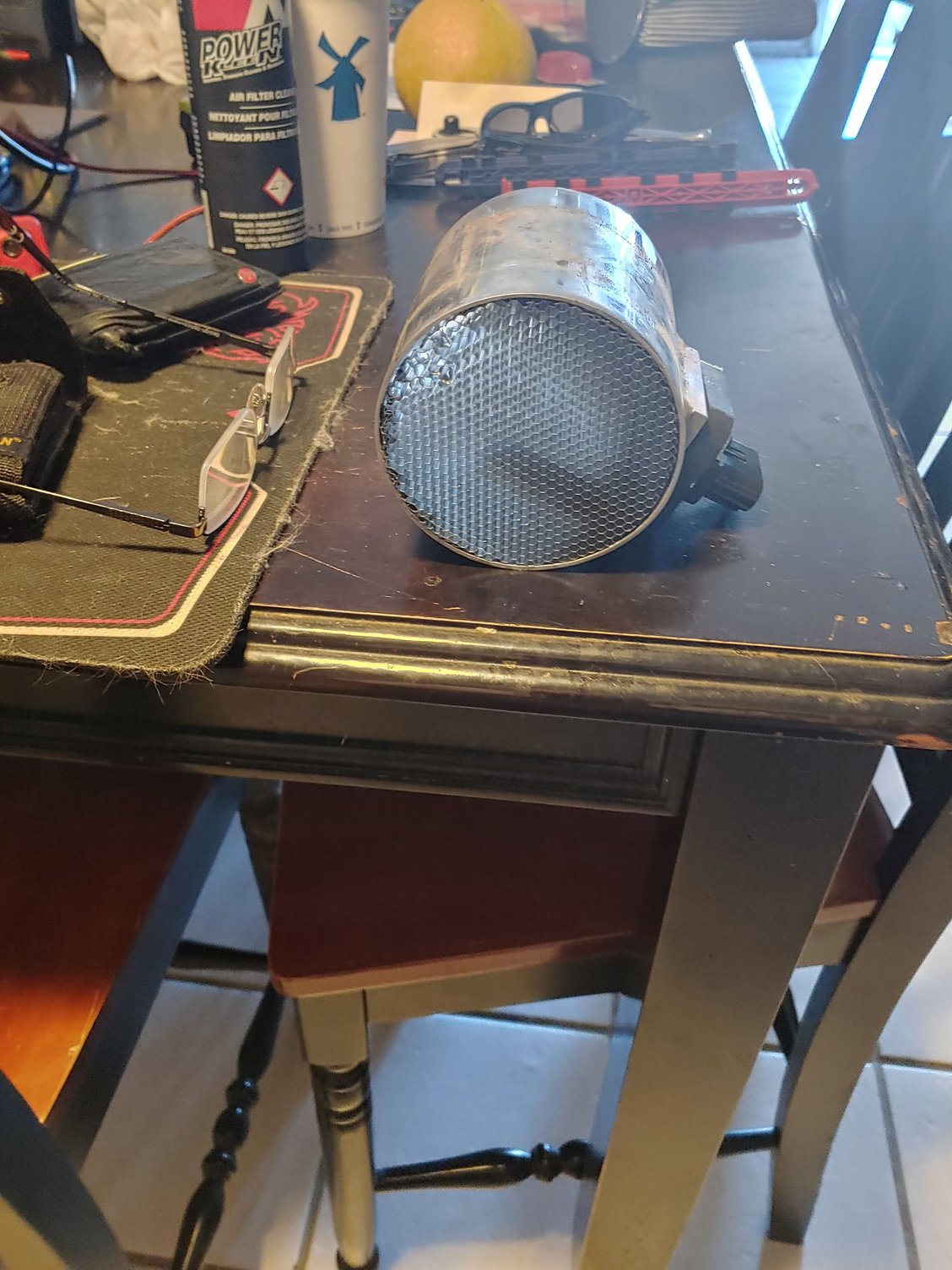

I am trying to make an intake that is larger than 4", but the only MAF housing I have been able to find it 5'.

I actually have a 5" screened MAF and couplers right now that I am trying to get to fit. I am asking about the 4.5" in case the 5" doesn't work.

I know. If it doesn't work, oh well, I'll go back to 4". Just need to replace the screen, and not mangle it getting it in this time. lol.
