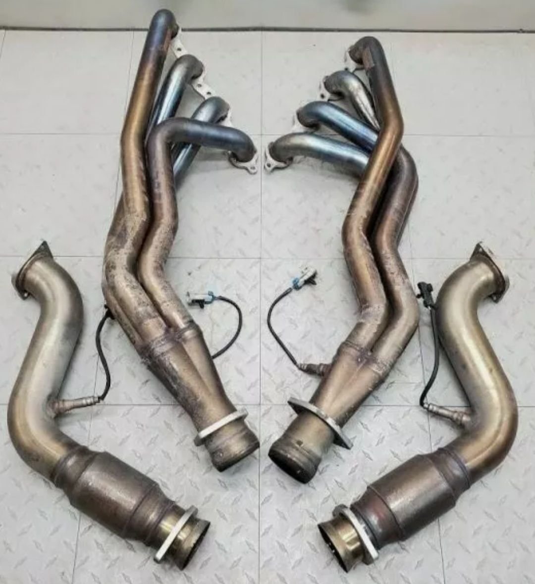

Was curious on your thoughts fellas. Im looking into buying used kooks headers with catted connections the car had 34k that they are coming off of. The do appear to have been wrapped. Should I be concerned? They will clean up im thinking really nicely.

They look largely OK to me; nothing obviously farkled. Although, the kinds of things I'd be most worried about, like cracked welds and warped flanges at the heads, won't show in a photo like that. One good thing though is that the collector flanges don't appear to have been overtighened: the clamp thingies appear to still be flat.
Have them ceramic-coated.
