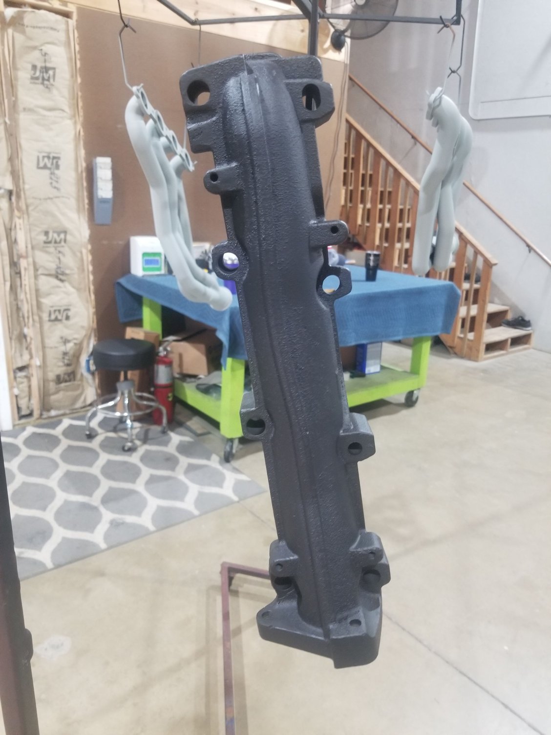

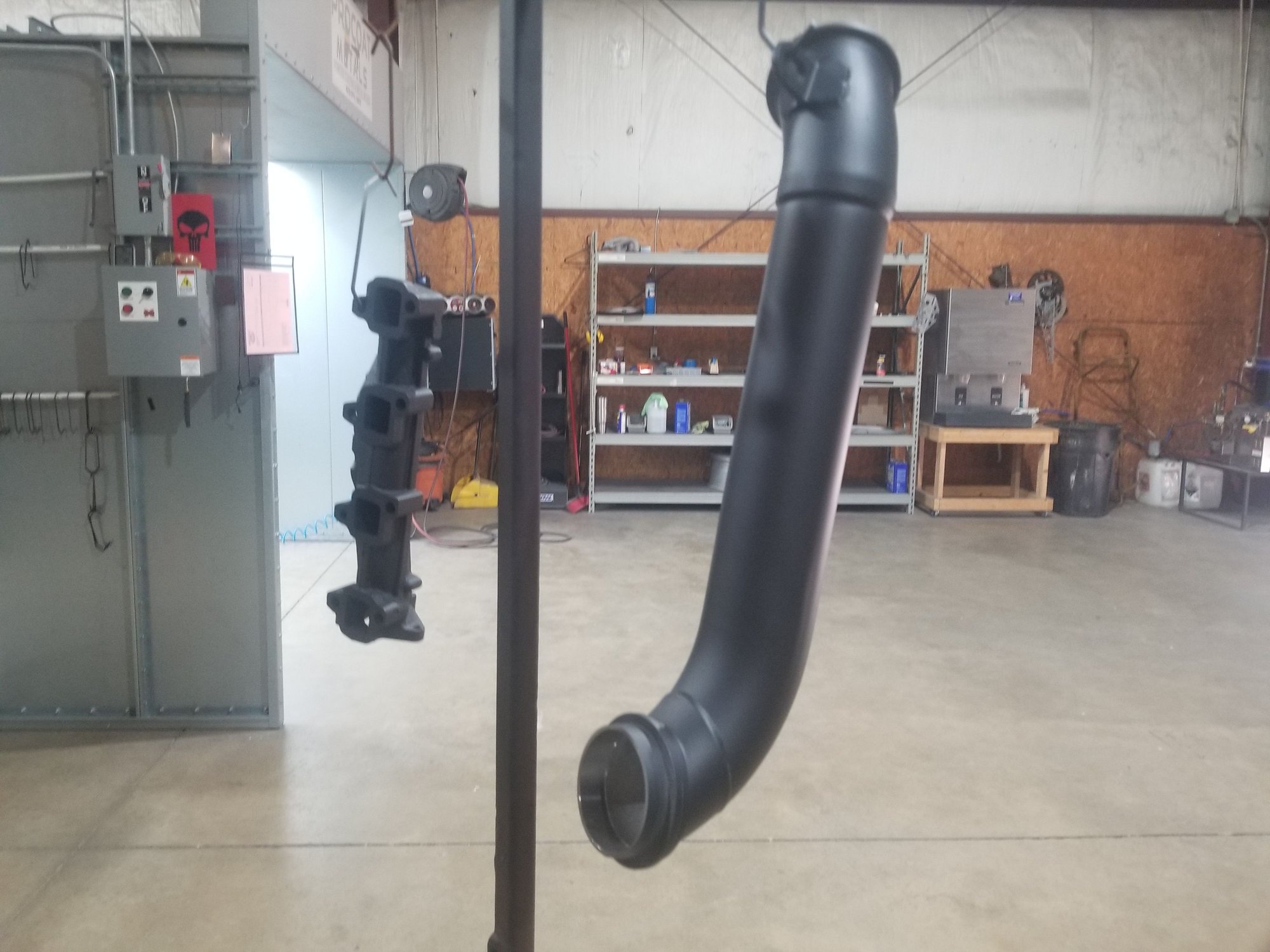

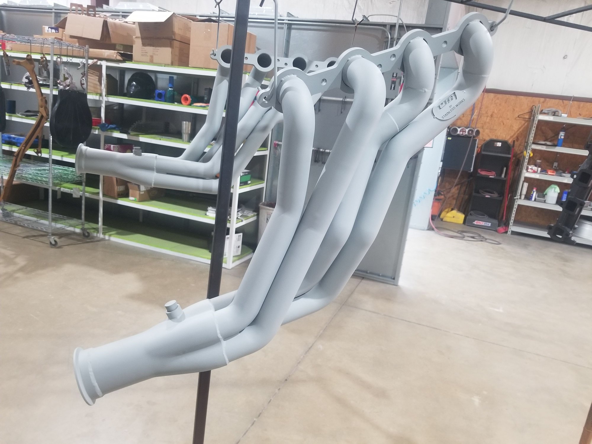

Got my headers for the hot rod and the driver's side exhaust manifold and a downpipe for the Duramax blasted and primed with the Zycoat. 8 hour air cure and first thing in the morning I'll hit them with color then bake for cure. I like the way the primer laid down, fingers crossed.

Headers and truck pieces are finished. The silver looks good but the black is super slick. Wish I would've done the headers in black as well. I just hope it holds up. Time will tell.
