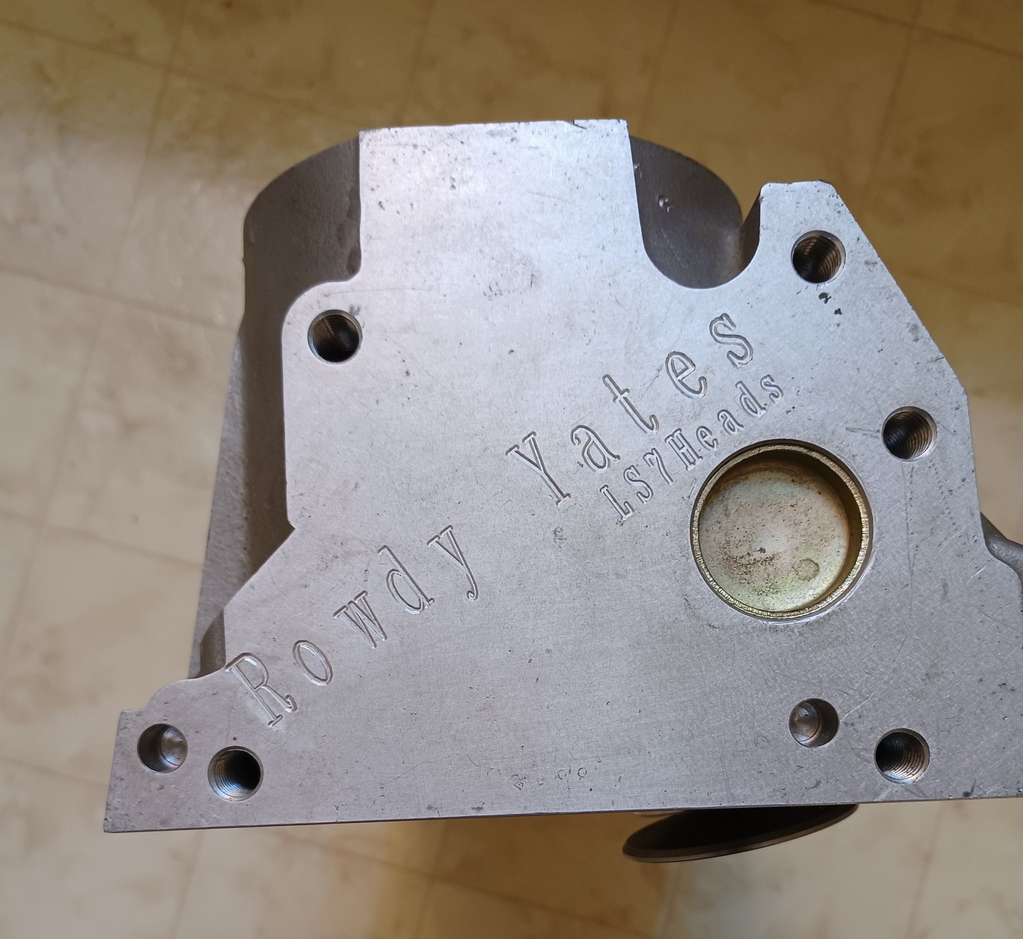

Launch is running a set of GM #17802752 heads. GM built these for a Daytona Prototype racing program. Quite a few of these pop up for sale on FleaBay and there’s another set currently for sale there by a business that ive bought a lot of stuff from. I can’t post a link. PM me if you want the link. Designed for small bore, high rpm race apps, about the only thing these heads have in common with an LS7 casting is the intake manifold mounting flange. Not a bad deal for the money. They come fitted with Ti intakes and exhaust valves, currently selling for $2k. I think Launch paid $1500 if I’m not mistaken? I’ve had some parts of these DP engines come through my shop, most of it hurt pretty bad.
Correct, and they fit 4.000" bore and all LS7 intakes bolt straight on. A few things.... the intake ports on the heads are raised about 1/8" at the bottom from the oe plastic ls7 intake. And the valves are inline like all typical LS heads but both intake & exhaust valves are splayed 5 degrees, towards the center of the bores for extra valve clearance / shrouding. I had no p/v issues with off the shelf JE FSR pistons, valve lift is .660 and cam is 243/250 108 with 30 degrees overlap.
The only small issues i had from memory is that all the bolt threads in the heads are imperial not metric like all LS heads. Even on the front of the heads for the accessories they are imperial, so i had to source the correct bolts so everything bolts up, including even the valve cover bolts. Even the header bolts are imperial.
The steam vents were also a different thread to typical LS, i had to source them from hydraulic fittings.
The heads also have o-rings on the intake ports as seen below, i left them in there and i'm running an OE plastic ls7 intake with factory green gaskets also, and it has sealed properly. If i had removed the o-rings i think it might have possibly leaked from the groove cut around the ports. With the o-rings still in place the factory green intake gaskets which are also wider than the o-ring, they squash down on and around the o-rings and it worked.
And you need tall valve covers. My proform covers literally just clear the rockers, and i mean just, i had to even push them upwards towards the intake when bolting them down or they'd hit the rockers. The heads also have hardened washers pressed in them for the head bolts which is a neat bonus. Here's an old pic when it was in set up stage
