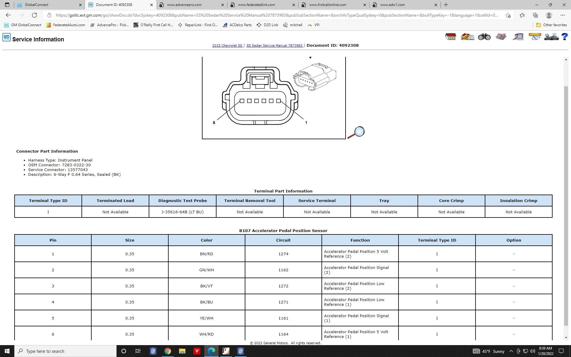

i live in Australia, and i have an accelerator pedal with part number 92256662, and i cannot find any information for its pinout to connect it to the E30 ECU
any help i would appreciate it.,

thank you for that info i will wire it asap.
