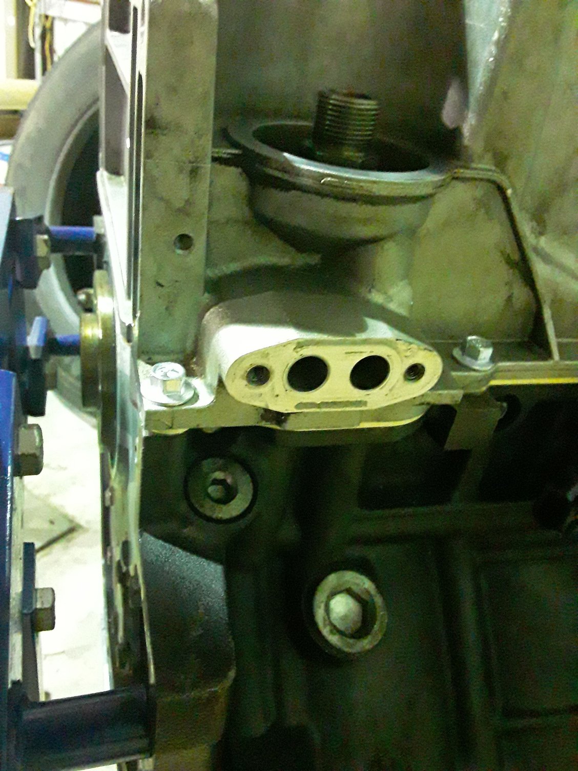

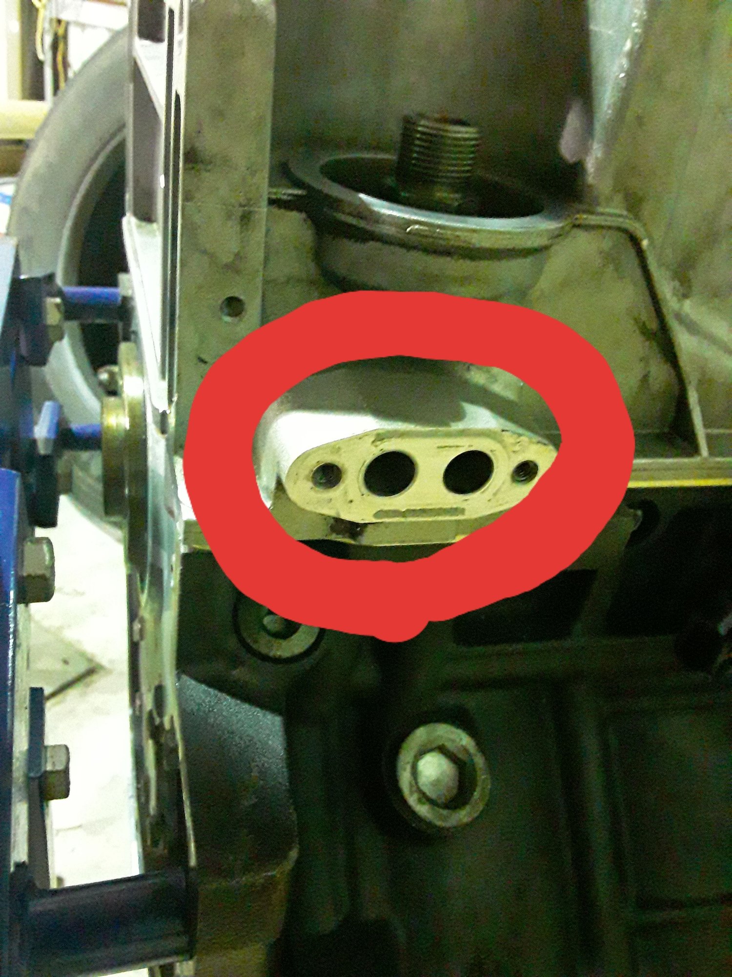

Question What is this?
I'm working on a 5.3L (LMG). I noticed some holes on the side of the oil pan, next to the oil filter. Do I need to plug these holes, or is there supposed to be something there? I didn't remove the engine from the vehicle. I just rebuilt it. I want to put it on an engine dyno, but I don't know if it can run with these holes open. What are my options?

Some vehicles have oil coolers and that particular oil pan is for a vehicle that uses one. You can still run it as long as there's a block off plate in place.

Right, oil cooler ports.
Stock truck engines like LM7 have a little plate thing (more than a plate really, but not by much) that you would need if you're not running a cooler. Looks kinda somewhat like this. https://www.ebay.com/itm/29388699380...=1645685073568

And when installing that block-off plate, DO NOT overtighten the bolts. It will warp easily.

I actually have a (spare) stock LM7 oil pan. I think it has that blocker plate as mentioned. I'll double check and see if I can swap the blocker plate to the LMG oil pan. Thanks everyone.

and just because it may not be obvious, you cant make one with a piece of flat metal. oil needs to flow from one hole to the other.

Great post here. The GM (or others…a couple manufactures make one) oil cooler block-off plate doesn’t simply cap those two holes. It directs oil from one side to the other.

Think of it as an oil cooler bypass it is a piece of aluminum that has a passageway that connects one hole to the other. If you have an oil cooler the front goes to the oil cooler while the other hole is the return from the oil cooler.

I checked the other oil pan. It does not have the blocker plate. I'll have to order one of those. I did not know that oil had to flow from one hole to the other. I appreciate that little bit of info.
While we're talking about oil pans...would it be possible to attach turbo feed/return lines to those holes? I couldn't tell if they were threaded or not. Since oil is designed to flow through there, it would be a convenient way to rig up some oil lines for a turbo. Just a thought...
