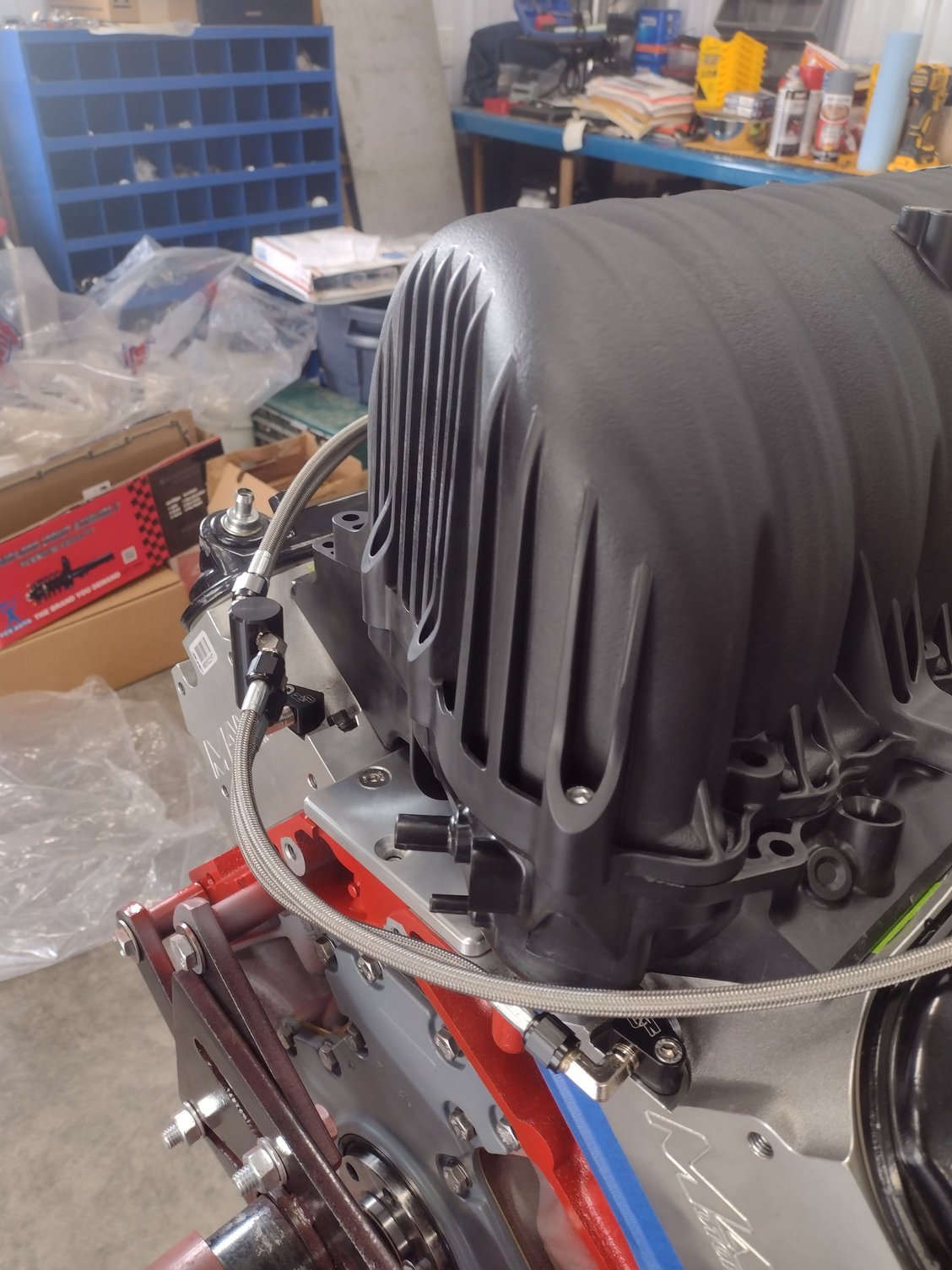

I just purchased the 4 port kit from nitrous outlet. Wasn't cheep, but none of it is. Cheep insurance I figured to help eliminate hot spots. Nice kit!

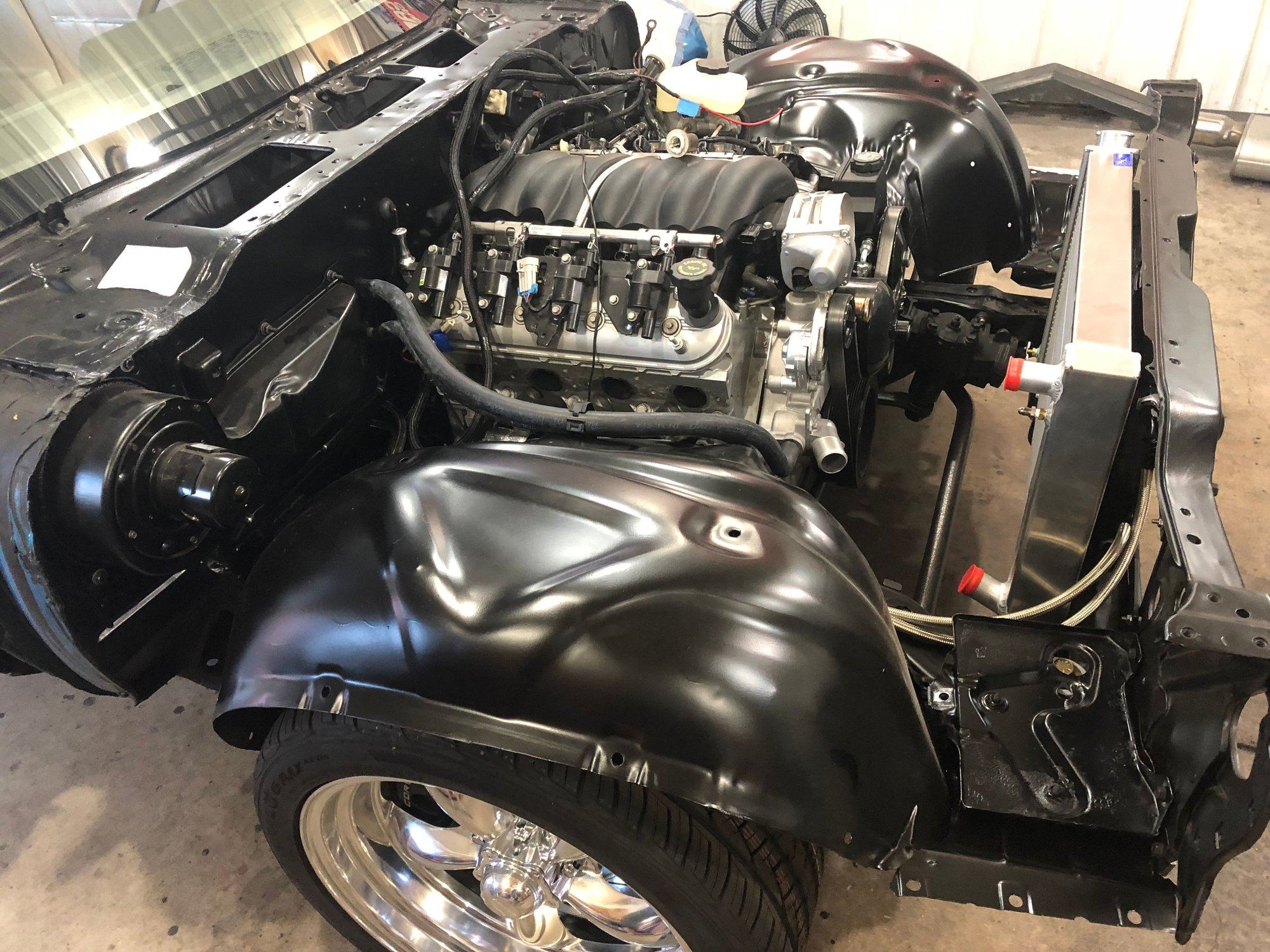

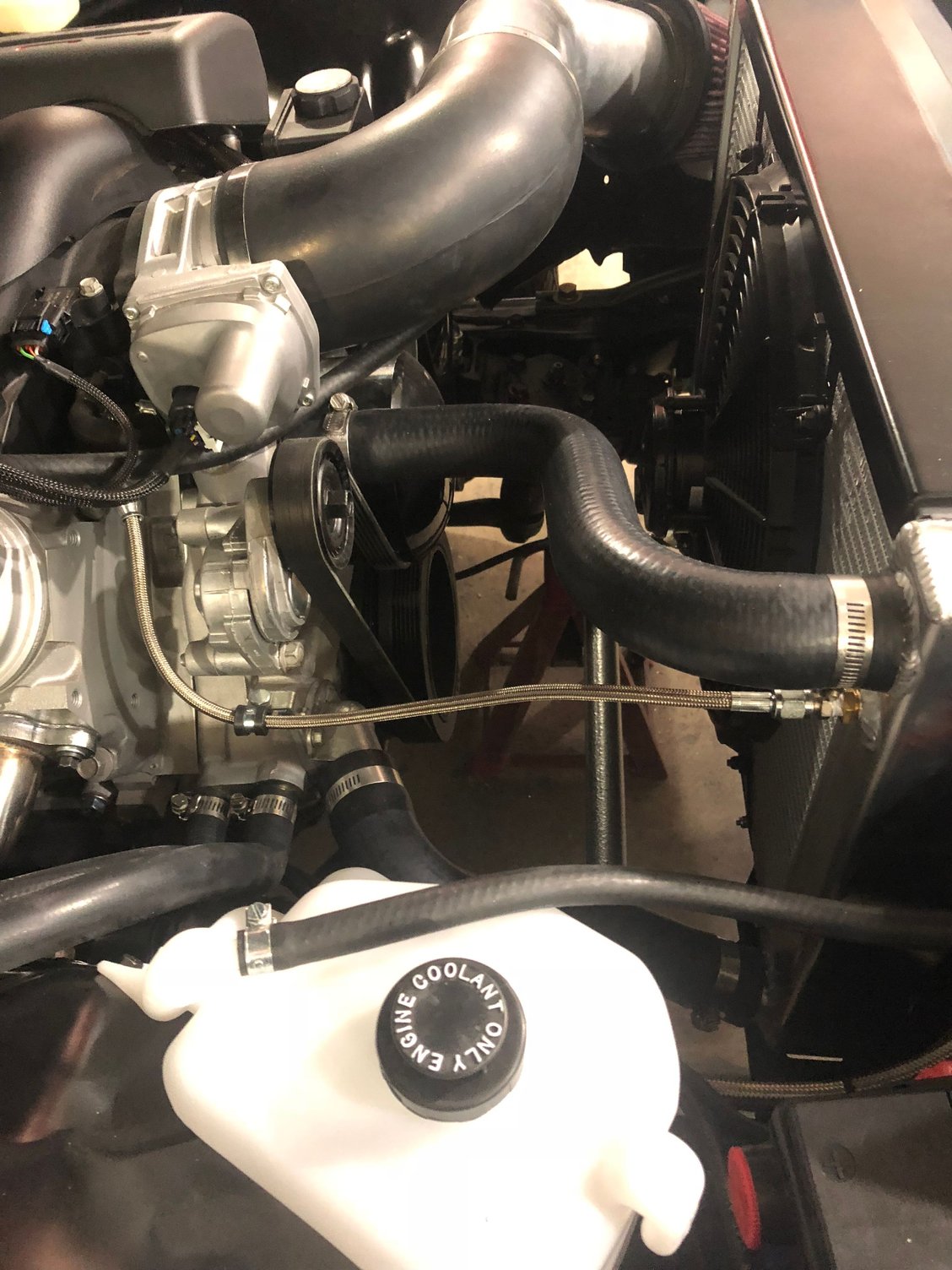

Maybe wouldn't work for you but I use a 2002 ? LS coolant cross over. But I clip off the outlet tube and drill and tap the right side block for 1/8" NPT. Then use -3 SS line from the port to the radiator. Pics aren't the best but you get the idea.
I don't do the 4 port just the two front ports.

Just mocked mine up. All seems well. Took me twenty minutes to figure it out, and hand tighten everything. I think it looks great and professional. Curious what you think is garbage about it? Is there something I should be looking for?

@getnit that actually looks really nice!

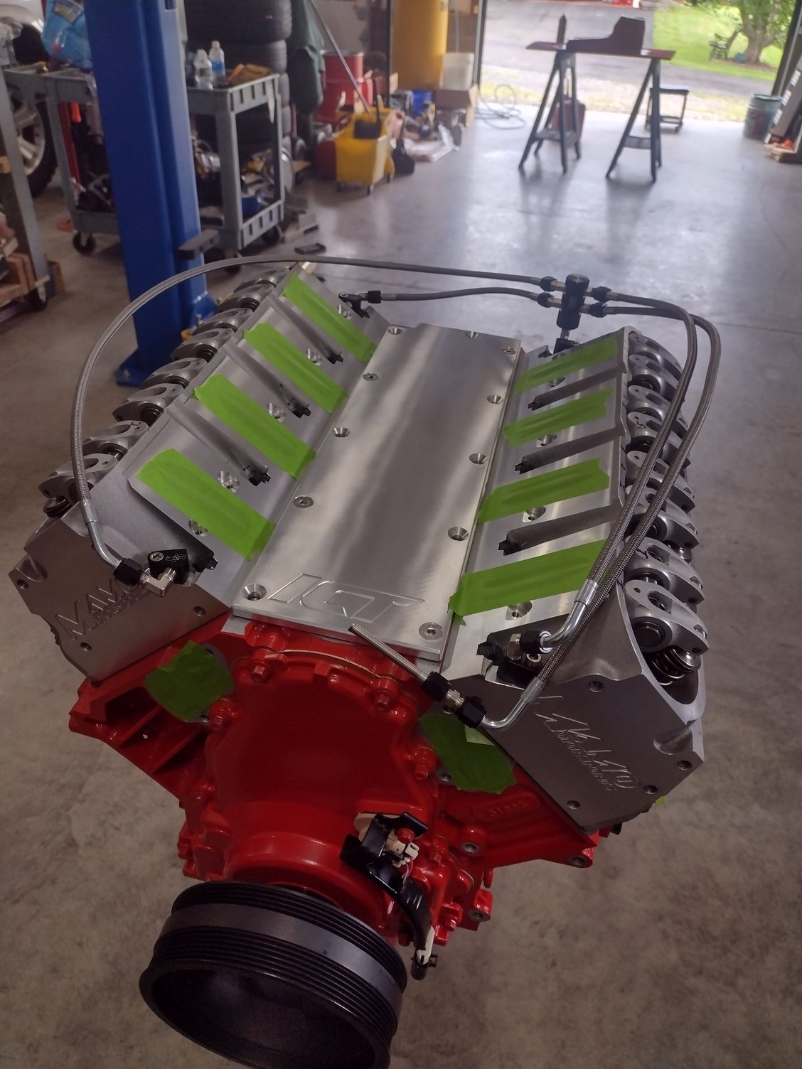

Has anyone tried to use the early OEM C5 Corvette 4 port system? Everyone said I couldn't use it on my old LS1 with 90mm FAST intake, but I did, and had no intake cracks or vacuum leaks. Maybe a machine shop could machine the valley cover down a small amount and the OEM 4 port could possibly work. It might be worth researching. Getnit, I see that you aren't running the later PCV type cover, so the machining would be easier with not having to work around that.....

The fitment on a car 102 intake is ****. The connecting tower is a pain to get the fittings in with no room around it and they all need installed in a specific order. The line that goes under the tb inlet on the manifold is all jacked up between it and the water pump...etc.
