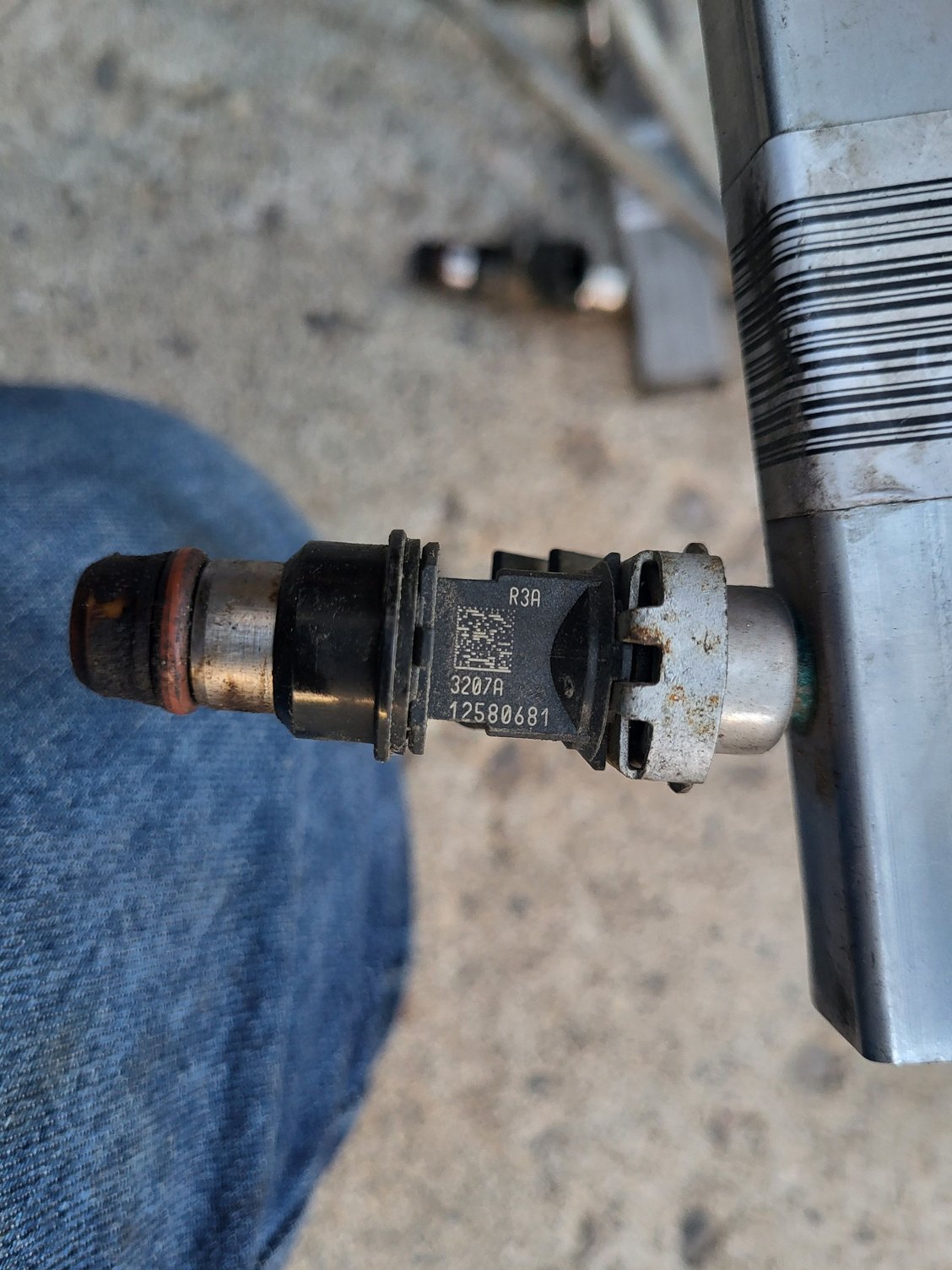

I'm nearly finished building my ly6 engine and have a question on the injectors that are currently in it
( pic attached)
Im wondering if those injectors will be fine as i have put the btr truck norris cam in and i think my injectors are 30#! Will these be ok?
thanks

How much power do you anticipate making?

I'm not sure what numbers I'll make with it just NA tbh,
I think richard holdener anticipated around 500 crank hp with that cam on the ly6, but that was just a guess as he hadn't run the btr truck norris in an ly6!
I'm just wondering if the stock injectors will work ok with it being NA.

In for results. I'm essentially using the cam motion version of truck norris cam. I'm either going to run LS3 or FIC 60# injectors but no one has replied to my thread. Cam motion told me 450-500ish hp is reasonable pending a few factors.
