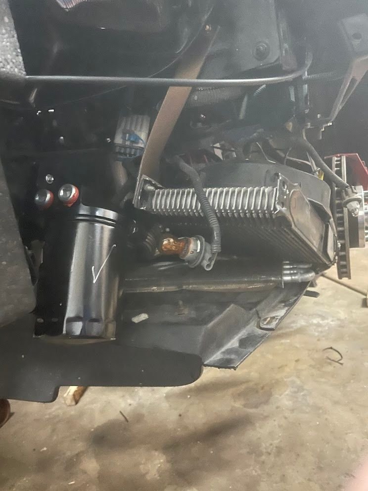

What about stuffing it in the bumper vents?
I put mine in this hole:
Looks as follows with the bumper off. -10an lines to and from.
I put a fan on it as well, 30 min stints at the road course and it stays nice and cool.
Just realized you said you want 50/50. This wont help.
