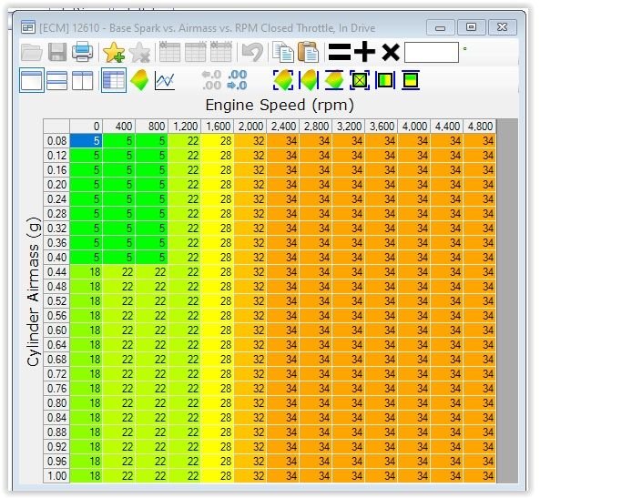

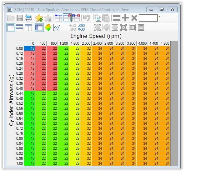

I took mine out for a test last night (0-20mph) - ambient was only 100. But it's definitely improved. Took it around the 'hood for about 30 mins and it held temps with/without a/c so long as I was moving at all. However, after pulling back in the driveway the temp slowly climbed w/ the a/c on.
It went from about 212 to 221 in 5-10min and as soon as it crested 220 it seemed to 'pick up steam' (pun intended). temps would rise faster, it's always done that at around 220 deg. Gonna have another look through the tune to see if there's something that stands out at that temp.
As far as my tune. I downloaded a copy of the stock 98 (which mine is) and has a more aggressive timing from what I've read from the factory.
the PO dropped the idle speed from 800 to 700
the PO dropped the idle timing from 22 down to 5.. yes 5.. it was very blatant. I have a feeling the PO was trying to get the exhaust note a bit more choppy, which it did... I may bump it a couple more deg as vacuum is a bit low - but the brakes still work.
(the PO tune)
(the stock from hpt repository)
I have the OG LS1 - stock heads, baby cam (comp 54-424-11) as I found out when I did the clutch/back cover a couple of weeks ago, and some shorty headers. As a comparison.
