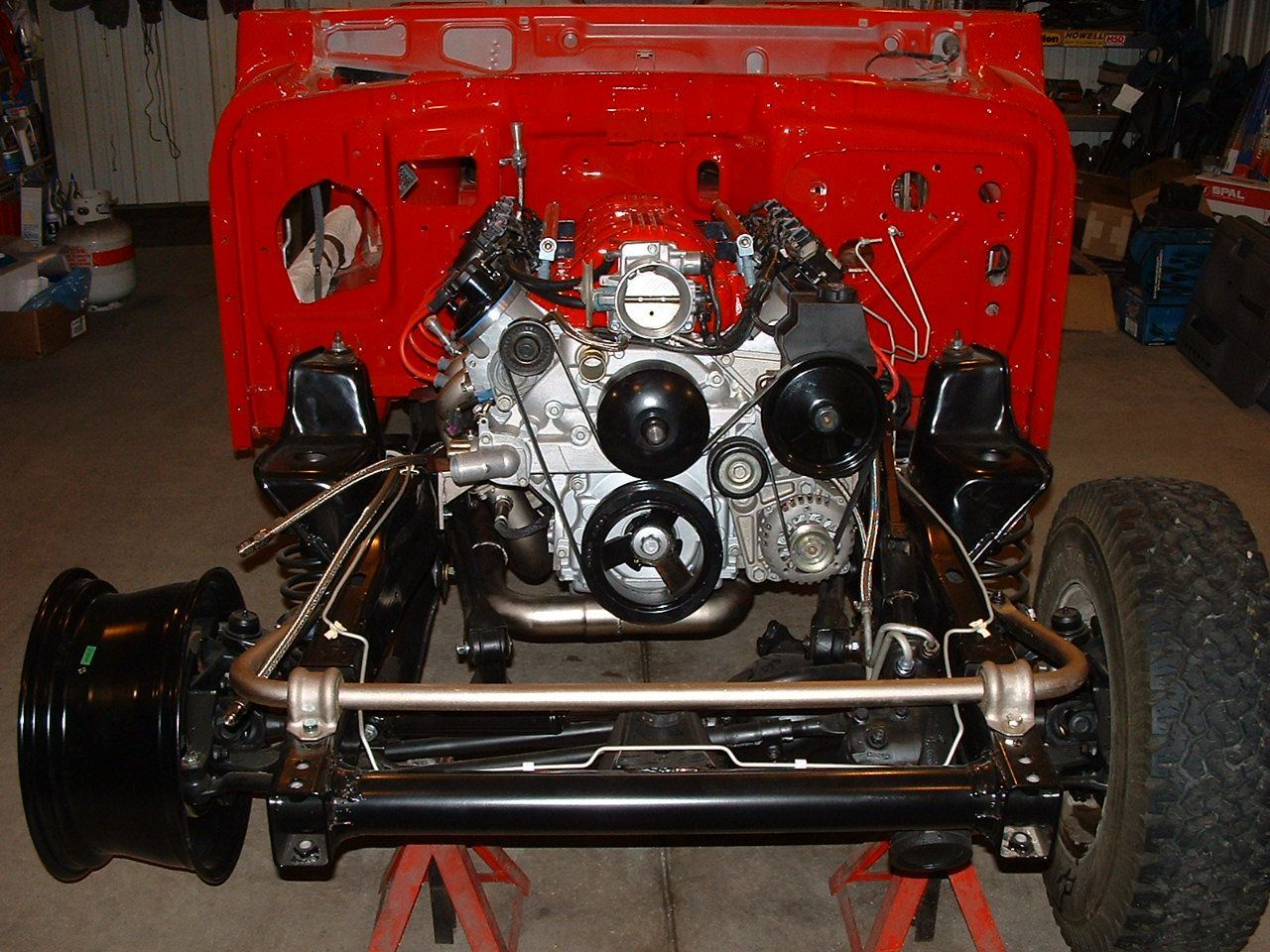

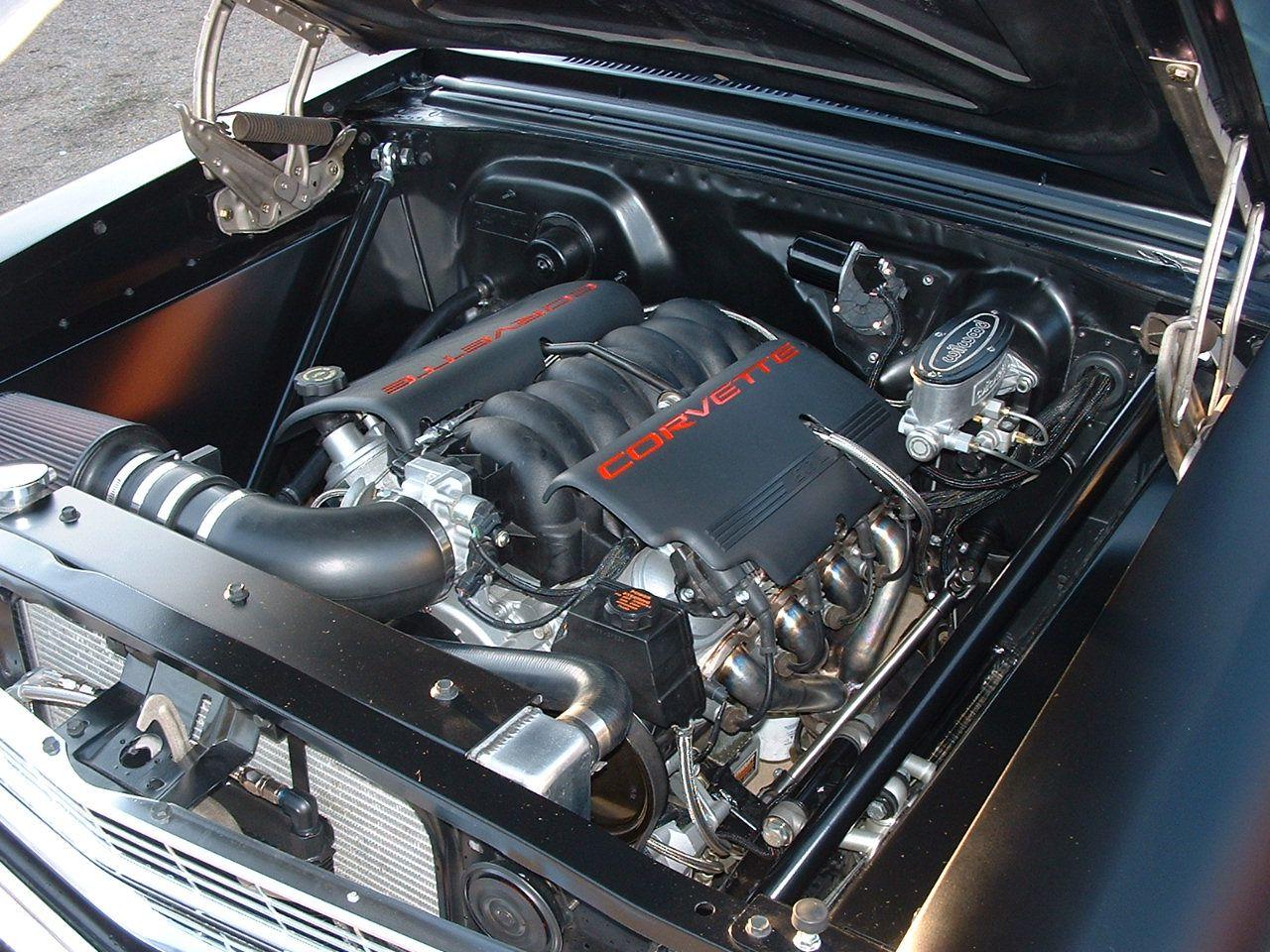

I like and use 2002 Camaro FEA components and brackets. Most stock GM FEA brackets have been phased out.
I like the 02 Camaro stuff because it's pretty compact.
