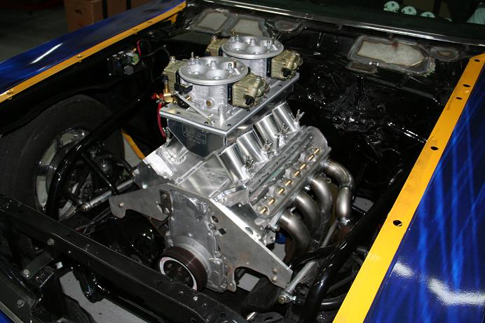

Here is a shot of our HRE Intake and Bassani/Sasser headers.
Heads are C5R CNC rough out by TEA and hand finshed by Don West
If you look close you can see the bolt boss below the header flange. This is for the LSX block.
Headers are 2 1/8 to 2 1/8 stepped.
We will start with the 1150's and play with other carb later. The carbs are Holley Ultimate HP's that were prepped by Ron Anderson at Marx fuel systems.
Robin

Looks pretty sick !!

Are they stepped? Looks like a real performer!

That is quite possibly the most beautiful intake manifold setup I've ever seen on a LS engine.

Very nice Robin.....what are the ET goals for the car?
