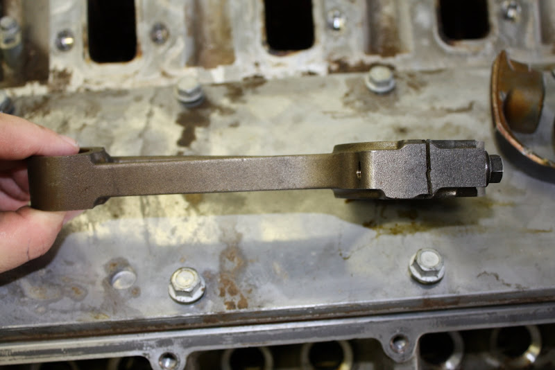

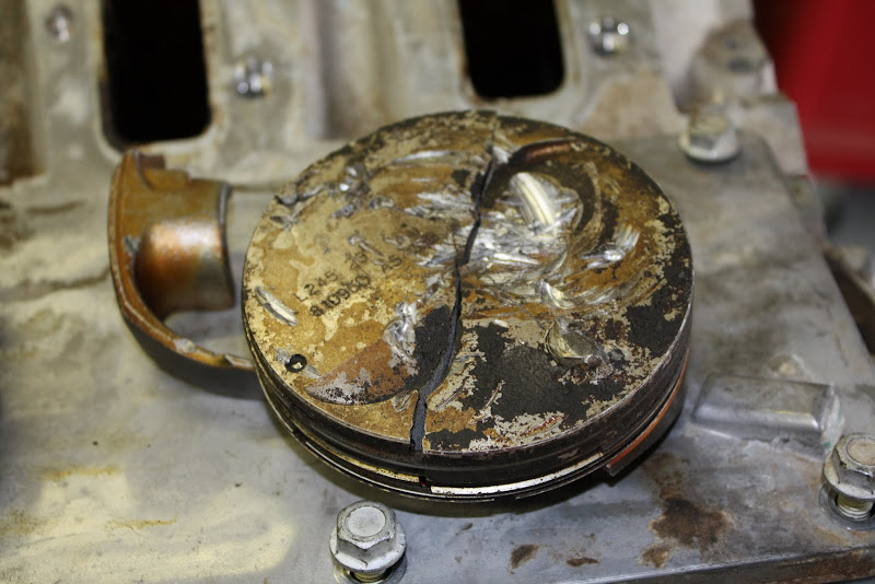

What can the stock L92 parts handle as far as power? I picked up an L92 that had the somewhat common valve problem which took out a piston/rod and head. The crank looks great but I will have it polished just in case and the cylinder only needs a hone. My question is, I am at the point where I do one of the following:
1) Buy 1 stock piston/rod set-up and do a stock rebuild, maybe some upgraded rod bolts
2) Buy 8 new rods/pistons, aftermarket and keep the stock crank
3) Buy a complete rotating assembly and rebuild aftermarket
I would like to keep this somewhat on a budget and I really don't care one way or another about stroking it. Since one head was trashed, I was going to pick up a set of CNC heads and run the VVT with wither Comps new phaser cam kit, or Mast. Down the road, I *might* have some fun with it and throw a small power adder on it, but nothing crazy.
So what are the safe power limits on the stock parts? I think I have read a couple times that the LS cranks are good to pretty high HP levels and some people have kept the crank and just done rods/pistons. Any input or thoughts on which route to go?

Since I have one destroyed piston,
and one bent rod,
At a bare minimum I need to buy 1 stock rod and piston. Or do I buy 1 stock rod and all new forged pistons? Or forged pistons and rods using the stock crank? Or a complete forged rotating assembly?
I would like to stick to one of the first two and save the $1000 on the crank because I feel that if I am realistic with myself, an all forged rotating assembly might be way overkill for my power levels. With my current LT4 build, I made the mistake of going WAY overboard on the engine, and never even came close to the power levels that it was built to handle...Oliver rods, Oliver billit mains, Cola crank, JE custom forged nitrous pistons, and the list goes on...
But what are the stock pistons/rods good for? What is the stock crank good for?
