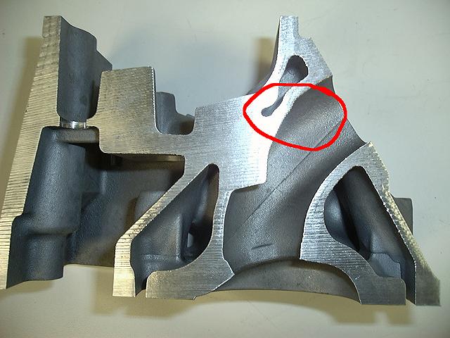

I saw a video about porting and it talked about l92 heads (streetkillz.net or something, the video is now gone). It mentioned something about a bulge that you aren't supposed to port out as it may cause premature failure. (Too little material and it may cause the guide to collapse)
I noticed discussion about a bulge in another thread.
Is anyone familiar with this bulge?
I could be thinking of something else but i cant find any bulges in my head.
I believe this is what they were talking about. (top pic and bottom pic)
I just got a set of ported l92s that have the bulge taken out. Is this something to worry about?

I think that bulge is the spring pocket,I have a set in my garage and will take a look.

We port the bulge out on our Stage 2 program. Smoothing the bulge out still leaves over .100" of port wall thickness. That's a safe amount of aluminum and none of our customers have had any issues.

Its the intake side you have to worry about. I know Michael At Streetkillz and have personally taken a look at LS3 head ports that have collapsed, due to large springs and big lift. Call the GMPP guy at Midway Chevrolet in PHX, AZ he will tell you all about the write up GM did and why the "AS Cast" was created. here is the pick of the intake port bump. Trick is to have a good lift and smaller spring load. sorry so late...lol

I've been running Richard's Stage 2 and now Stage 3 heads for 4 years without any issues. I run PAC 1521 springs.

Sounds like he has a good program, I'm not saying all LS3 head ports but when GM sends warnings to their GMPP sales men id take it as a solid source..lol

Like Richard/WCCH, we at TSP/PRC port or smooth it way down and have never had any issues or failures!

Mines ported out and has a 1.55" spring in it.

Well not to name the brand of head I was looking at, with the broken spring base....lol I have personally witnessed it, it is real. I will send Mike with streetkillz a E-Mail and see if he still has the picks of the head. I don't know if he will respond as he is overseas at the moment. And I will fuzz out any identifying head info as not to slam any one selling LS3 heads. As problems can happen to all of us maybe the cast was week in just the right spot.. who knows? I just would think it would suck to have this happen to one of my engines.
