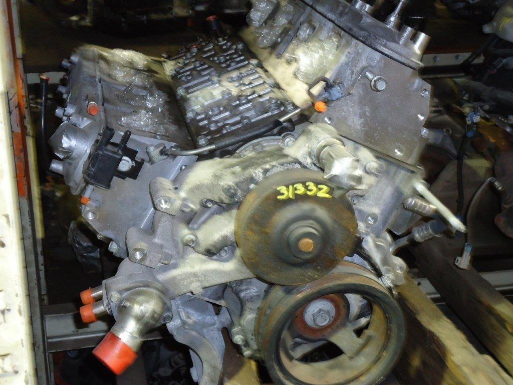

Hi guys, I have a opportunity to buy a l99 engine from a 2010 Camaro, it has about 15000 miles on it and I can get it for 3500$. The only problem is, It's missing all of the exterior components like alternator, starter, coils and all the brackets. I was wondering if there is a kit I can buy that would complete the engine.
Apparently there was a fire in the intake and I happen to have one at home so that wouldn't be a problem.
Can anybody look at the pictures and guide me on what's missing and on what I should do?
Thanks!

A fire in the intake would have me very worried about the internal condition of the engine.

I would pass on this one...
Fire in the intake also usually burns the oil off the cylinder walls on the cylinders that had intake valves open and causes rust in those cylinders... Doesn't happen all the time, but this is what I have seen on some other brands of engines with intake fires
Sorry for the bad news...
Usually, most yards treat engines with intake fires as pure core value only, not a running engine
Look at car-part.com and see how cheap L92's with intake fires are compared to the good running engines without fires
Also, if You aren't dead-set on getting an Aluminum block 6.2L, the LY6 6.0l has big L92-style heads and only VVT, not VVT/ DOD like the L99.
With a mild cam swap, You are making more power than an L99
