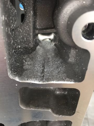

You need a bit of material removed to run 3/8 pushrods
Old Jan 11, 2016 | 07:24 AM
Mongo510's Avatar
Joined: Aug 2014
Posts: 29
Thanx DB, I was wondering about the PR holes, looks like a little work with the die grinder will take care of it.
I will have my machinist take care of the head bolt bores.
