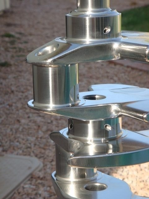

Pictures don't do it justice
I have a 4 inch Winberg crank, work of art.

They do make nice cranks, is that a fully counterweighted crank?
Yes, it's too bad that you will never see it because it looks so good.
