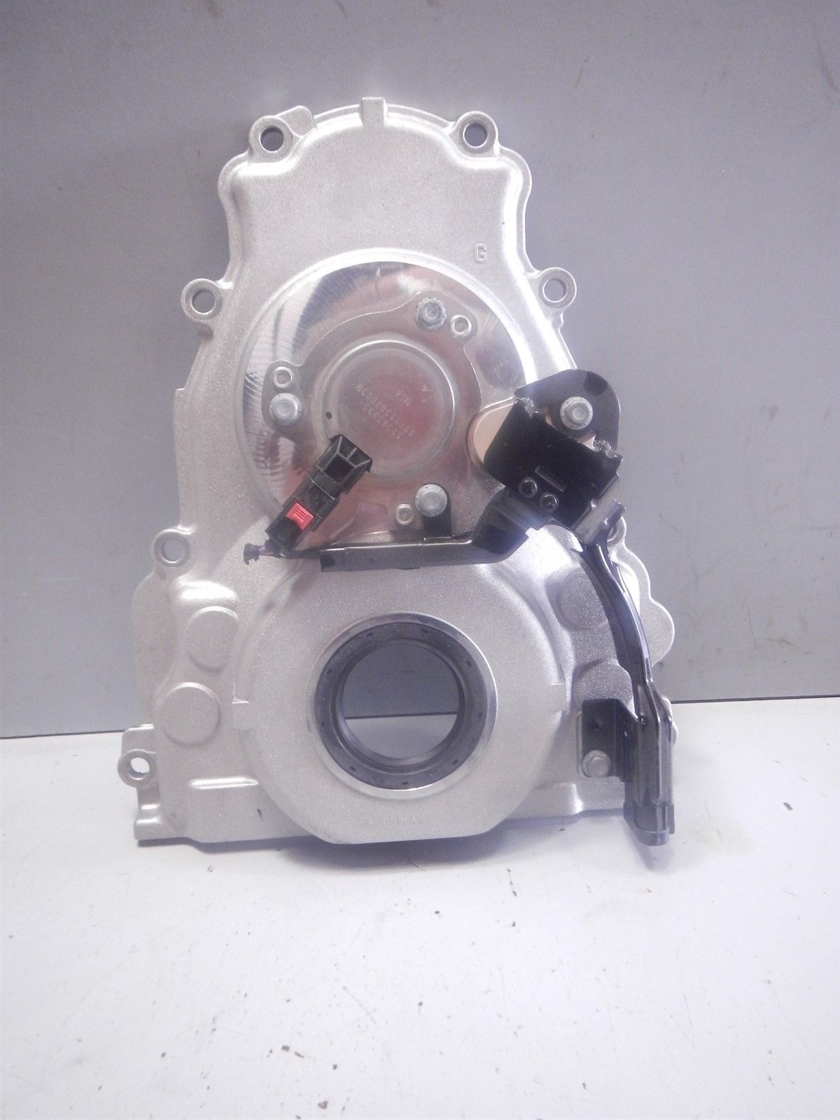

I think you're thinking of DoD/AFM. VVT never existed on these.
My 07 Silverado has AFM (but I tuned it out).
Old Feb 7, 2017 | 12:34 PM
steves86ta's Avatar
Joined: Apr 2009
Posts: 299
From: Cherry Valley CA
it has this timing cover

They put VVT on the later ones. Maybe '11? Not sure. The 4.8s also got it.
