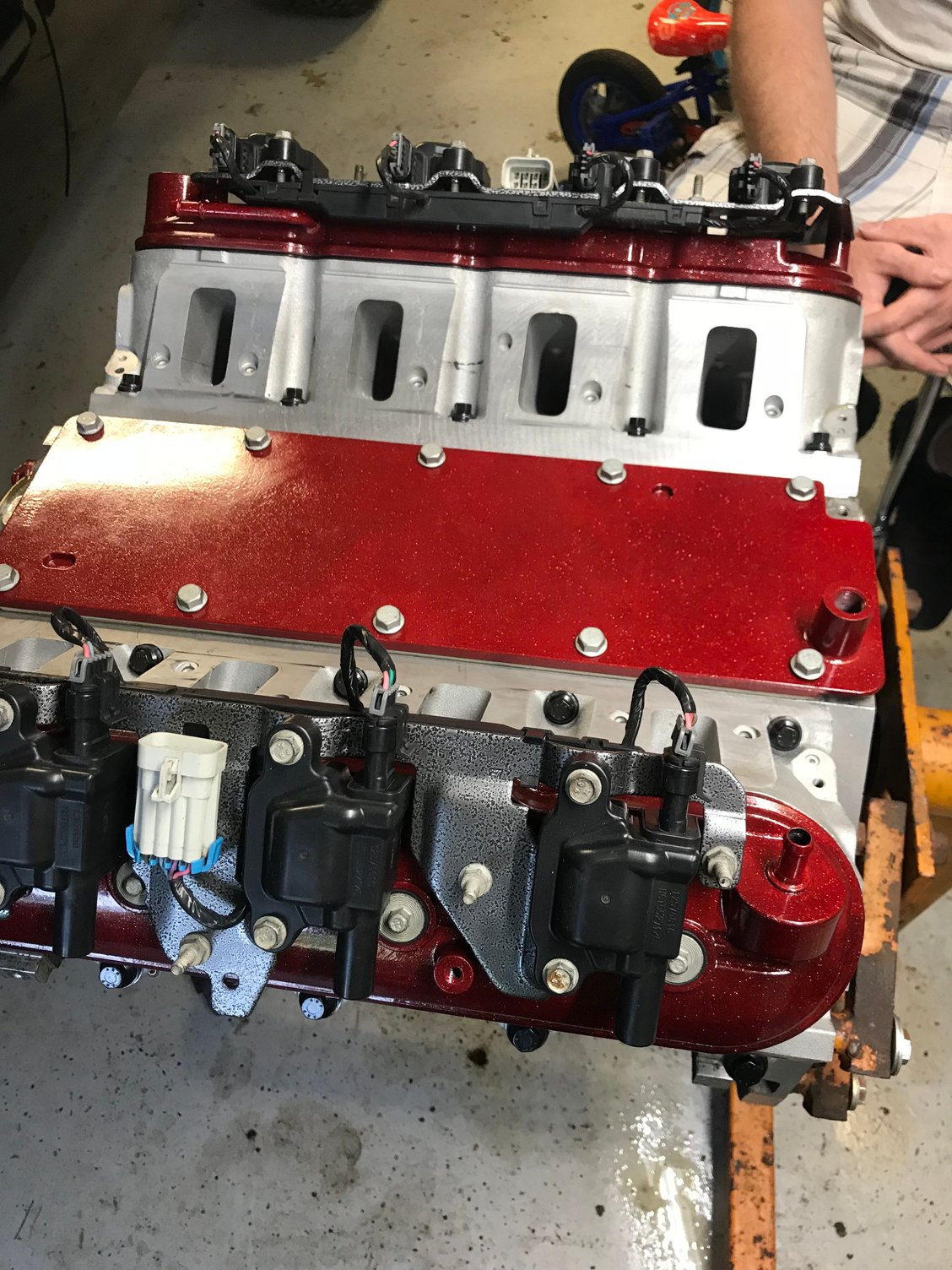

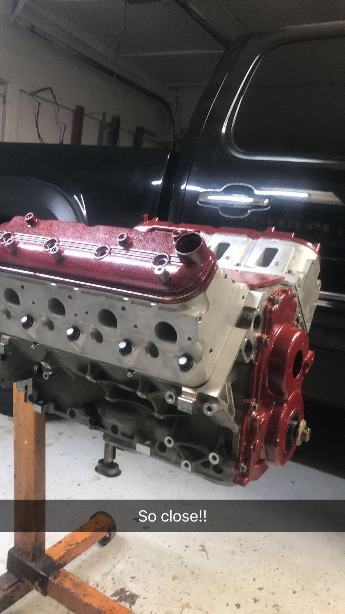

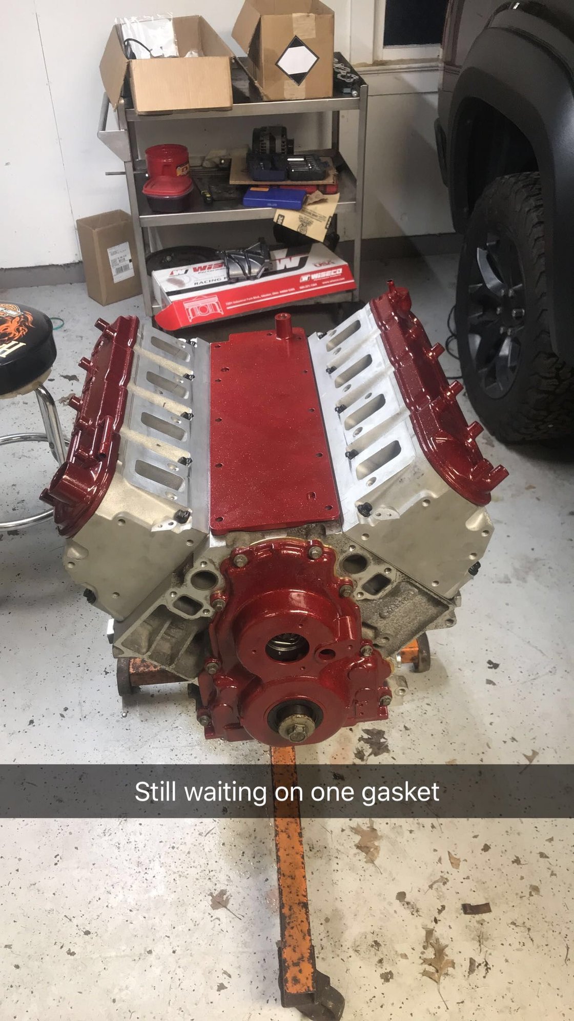

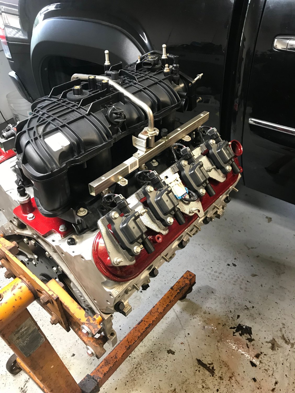

Still waiting on oil pan. Also need crank,cam sensor and vvt solenoid. Going to replace those while I’m at it since they are hard to get to.
Only thing left is oil pan and sensors. Also installed stainless exhaust studs.
Spotless intake.
Heads installed
The silver vein color is awesome!
Valve covers, ignition coils and valley cover installed. Also if someone is interested in a brand new valley cover let me know. Pay shipping and it’s yours.
