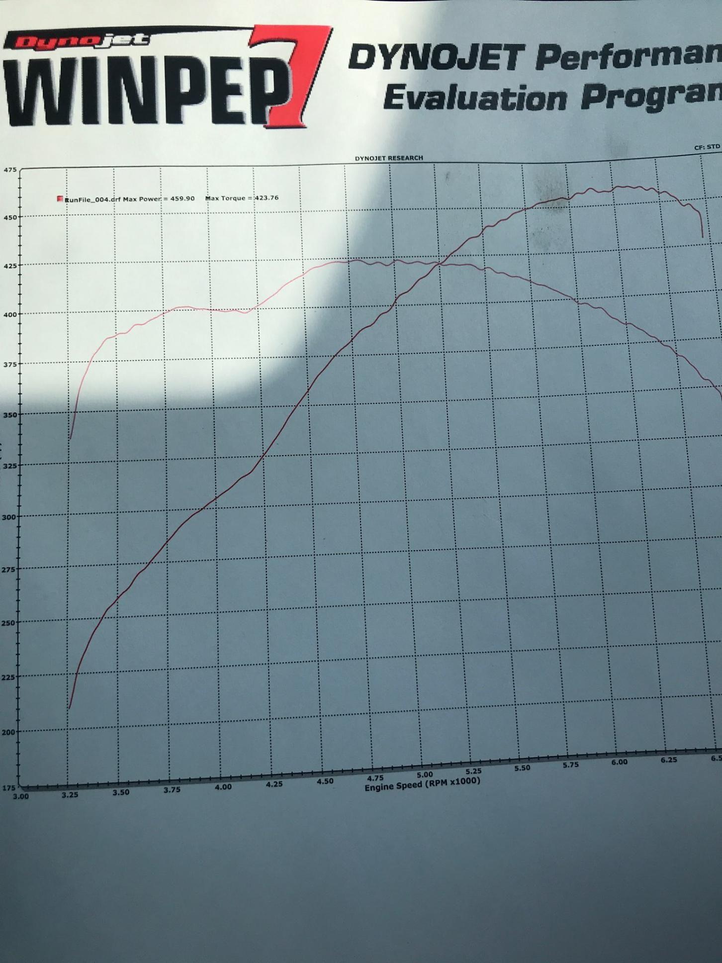

I figured I’d give you all an update. The car got dyno’d and Tuned last night. We are really happy with the end product. Rear wheel horsepower came in at 459.9. The tech said if it wasn’t so humid it would have pulled 470. Estimating 15% power loss in the drive trian that’s around 530-550hp at the crank. Even if that loss estimate is high we still gained 100 horse. The car is a real monster now.
Thanks for all your help! I attached the dyno sheet for your viewing pleasure.
