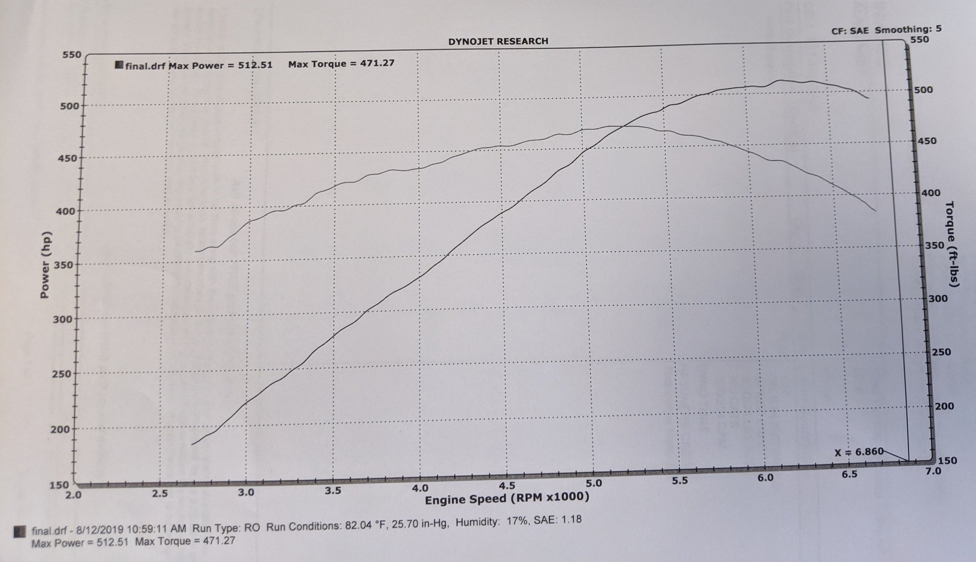

Keeping in mind:
LS 427
Low compression ~9.9:1
PRC Cathedrals 247cc
238/254
Target AFR (Not seen on sheet): 12.6
WHP: 512
WTQ: 471
Old Aug 12, 2019 | 02:05 PM
  #113
Darth_V8r's Avatar
Moderator
Joined: Jul 2014
Posts: 10,450
Likes: 1,873
Originally Posted by AndyTA
Keeping in mind:
LS 427
238/254
WHP: 512
WTQ: 471
Really, for low compression AND a baby cam (AS ls7'S go), that's pretty good. When you gonna hook up the blower?

Old Aug 12, 2019 | 09:10 PM
  #115
bortous's Avatar
Joined: Sep 2010
Posts: 2,898
Likes: 467
Damn that's pretty good without a blower and such low compression.
When you install that blower your top end will be insane.
Looks like that 238/254 116 LSA +3 cam is as good as I was expecting it to be.
If your comp was 2 points higher I reckon you would have made another 30rwhp.
Hope you are happy so far.

Update:
Quick run down of the mounting:
Everything is bolted on. 3 bar map, upgraded fuel, fan/shroud combo, etc. Plenty of threads about how people mount this, but I kept my stock radiator, and removed the condenser for now, simply because the Condenser line was pissing me off, so I told it to **** off. I fabricated a shield for the impeller as I have no filter - the shield is pretty "all-encompassing" - however I'm sure it's taking away a lot of performance, the impeller is facing the radiator. A nice little bi-product of this is... I cut out a section of my radiator shroud to make room for the head unit, which leads to lowered engine temps because the impeller is sucking air through/around the radiator. So when I step on it, my engine actually stays around the same temp or actually drops a few degrees. I found this pretty hilarious. Again, probably killing performance, but it's what I've got going on right now.
Some perfomance tid-bits:
I hit 120kPA @ 5200 RPM - so about 2lbs of boost on the F1X - Because I'm tuning it right now, I don't want to nail it. Slowly working my way up the RPM's. This is about what I would expect from running a 14 deg. overlap cam, low compression, and the largest pully they offer (5.25"). I'll crank it to 6800rpm later on once I get my AFR down correctly - for now, I've set the timing in peak areas down very low. 9 degrees at WOT on highest g/cyl, and 13 just above and to the side.. The rest is normal. Long story short, I'm predicting to make about 7lbs of boost up at the very top. SUPER Modest/conservative, I'm sure my engine is pissed about how over-built it is and what a ***** I am.
Regardless, **** starts to get squirrely real fast on my 315 Toyo Proxy's out back. 1st gear is essentially useless the moment I hit around 3500rpm, but then again, that was a problem even before the F1x, but probably more so around 4800rpm.
Second gear starts to spin badly past 4000rpm. I'm extremely happy with the cam selection (thanks Bort) as this is exactly what I wanted. It is very friendly down low and I'm sure the real monster will continue to sleep until after 5800RPM's or so.
I'll keep everyone updated on what I end up tuning this thing to.
Thanks for reading, and I welcome any thoughts/feedback,
Andy

Andy!
Been waiting to see how you are going with your project.
Glad to see you are extremely happy with the camshaft I specified for you.
I am surprised at 3500rpm the engine is already going crazy. Haha
That camshaft will pull to 6800rpm without an issue.
I hope you have a stout valvetrain and everything matches. (Unlike my engine if you have read my thread)
Once you get the boost working properly you should have a very flat power and torque curve from 3500rpm+
The pro chargers just keep pulling in the top end.
