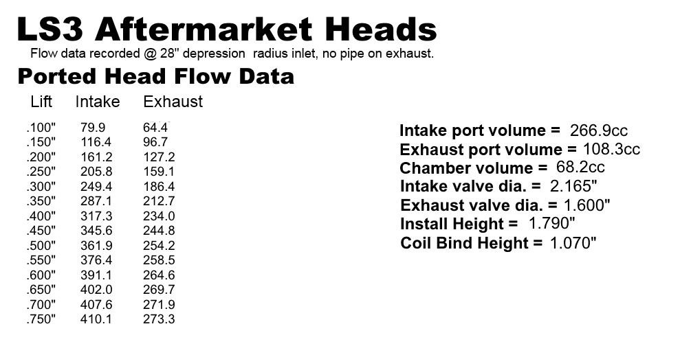

Speaking of heads... Jake, what made you choose a aftermarket LS3 head over a aftermarket LS7 head?
The LS7 heads seem to hang on longer up top in the RPM band over the LS3 heads....
Old Jun 18, 2019 | 09:59 PM
JakeFusion's Avatar
Super Hulk Smash
Posts: 11,258
Likes: 146
From: Pace, FL
I'll just leave this here...
I am making a change after waiting 18 weeks for my heads. I cancelled the order. Going a different direction.
