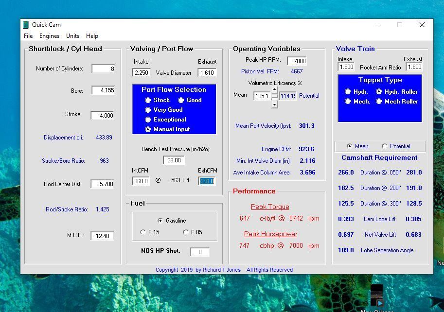

Interesting, playing around with it to see how close my cam is or it is to my cam. I have it if you dont get it

All the white boxes are where you can input variables or make changes, you'd need all that info.
Valve lift is set by the software at .563

Need your .550 lift flow nunbers.
Strange that it will not allow you to put in max flow numbers or a range unless its configuring that internally. Also allows for the choice of engines and makes, using LQ9

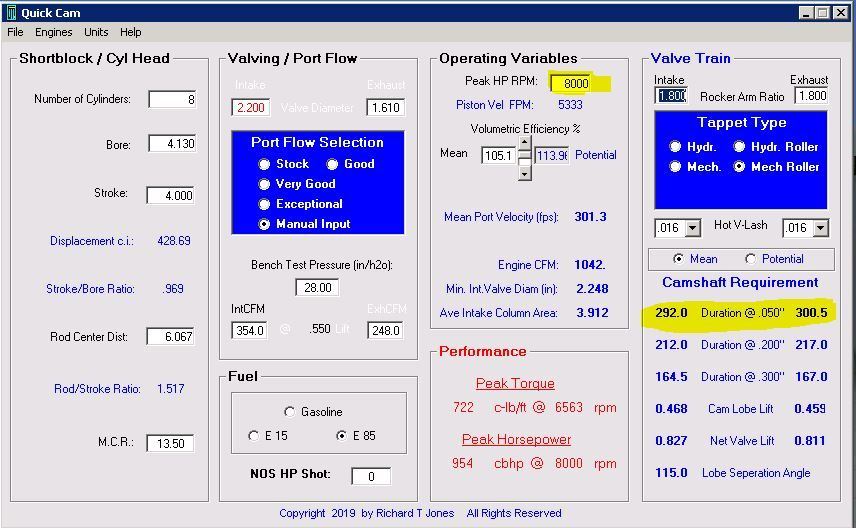

Bore 4.130
Stroke 4.0
Rod length 6.067
Compression 13.5
Valve sizes 2.20 / 1.61
Flow @ .550" 354cfm int and 248 exh
E85
Power peak from 7200-7500, maximum rpm 8000
1.8 rocker arm, solid roller....
Thinking 258/276 on 114...

Wonder how accurate this is, seems to like big cams

To max out the combination in a drag racing application I don't think the duration numbers are too far off. Would be nice to solve backwards from cam specs to get horsepower but I think you need to buy the software to get that function. I don't believe for a second that a 280/289 cam on 114 peaks at only 7500 rpm though.
I'm guessing the flowbench numbers we're giving you are inflated vs what would give better simulation results.
Those are well over 2hp/cube. I'm shooting for ~1.8 with a much smaller cam.
Thanks for running my numbers.
