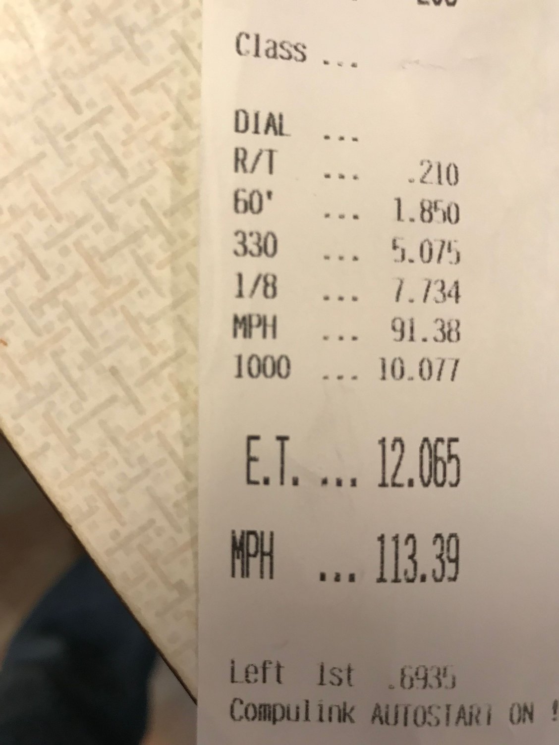

At Pacific Raceways (SIR) Seattle I ran my first and slowest run at 12.8! No hook up at all!
Each run got better as I relaxed and learned. FYI, I am not a racer.
best run was 12.06! Almost perfect! If I break into 11’s I need a roll bar, harness, battery cut off, etc. no thanks.

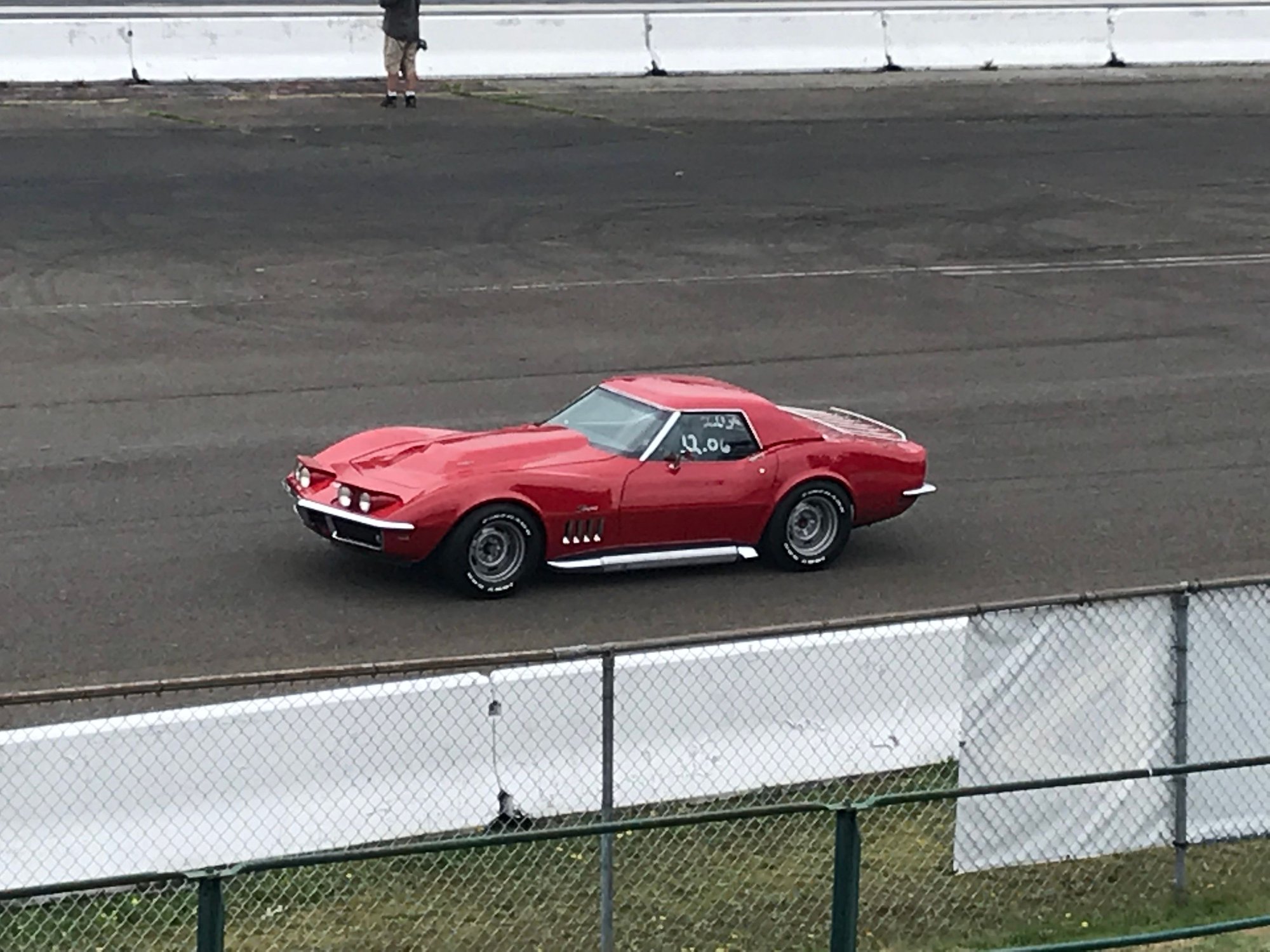

Pre tech inspection
Did you know C3 headlights pop up at 110+MPH if vacuum is not hooked up?LOL!
No words. Just numbers!

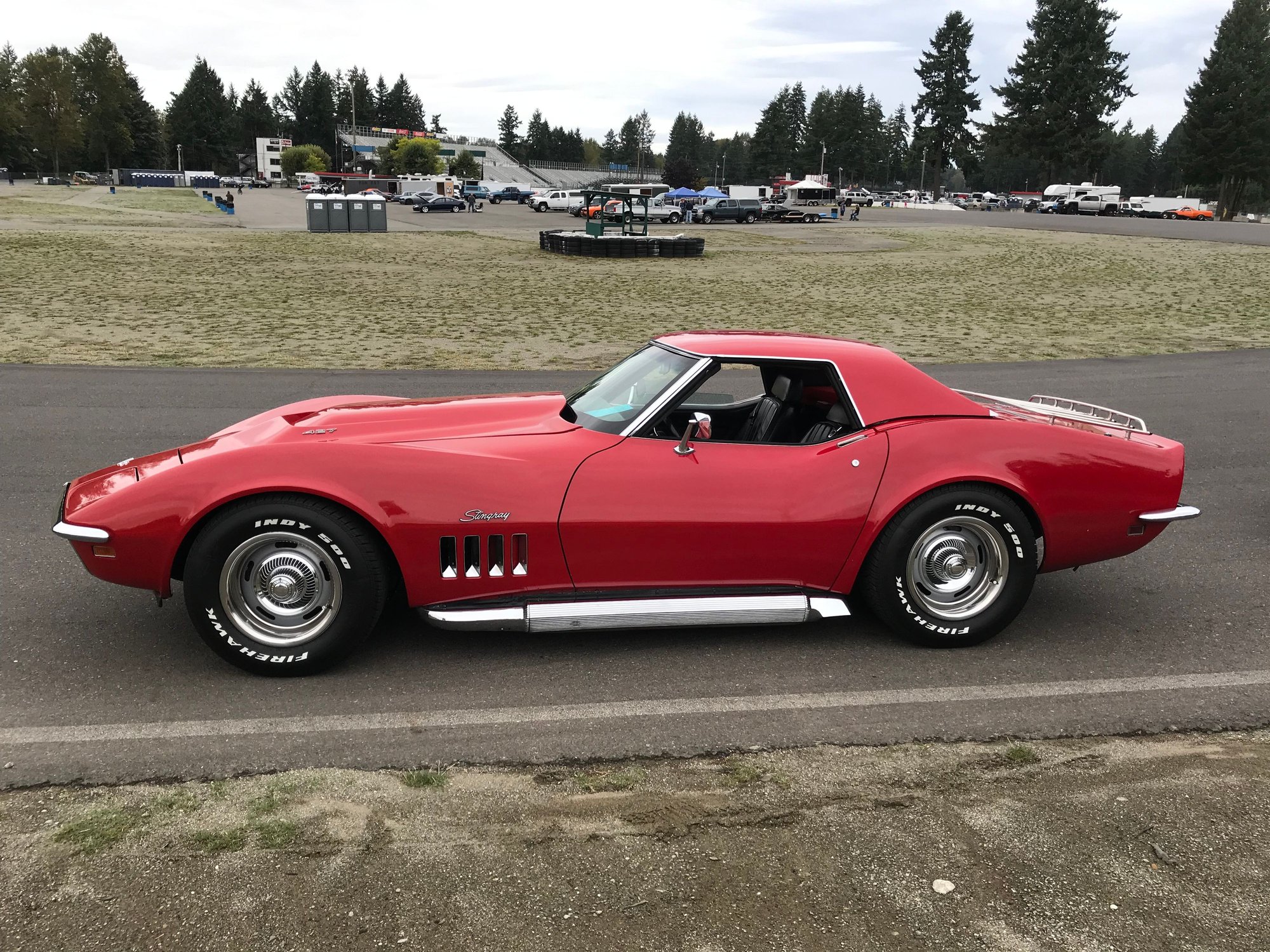

She has a GM connect and cruise kit.
Crate LS7, 4L75E tranny, GM wiring, computers, and GM hotrod tune. EG all nanny software turned off, no key fob, etc etc.
Rack and pinion steering, VBP performance street suspension, 3.73 rear end, spicer U-joints all around, half shaft loops, cryo treated slotted rotors, all rubber brake lines replaced with steel braided and aggressive pads. Internal fuel pump and baffled tank.
All work done done by me with help at times from friends and family.
Otherwise stock!

I would say that you got a bit left in that.
Your 1.85 60-foot time indicates that you could have as much as .3 second to shave....if you wanted to go there.
Eventually.....you gotta go back; if for no other reason than to get banned from the track!

Awesome looking Vette, you did a great job. Racing with headlights up?

How does it sound with the side pipes? Did you find headers that fit the side pipes or custom fit or stock type manifolds?

No, I do not have vacuum hooked up to them and at 110 MPH the air pressure pushes them up! Doh!
I manually put them down after each race!

The LS motor sounds a little odd at low RPMs but when I get on it she lights right up and sounds great!
The headers are the Camaro headers off an LS7. I had the side pipes cut and fit at the collectors. Also had the O2 sensors added there. The side pipes are factory BB pipes.

Lookin' GOOD! Which width 17" rims did you go with? Tire size? It looks like they fit just right!

17x8 Chrome Torq Thrust 2 with a 4" back space. Tires are 255/50/17!
I struggled. long time but finally did it. After I added the raised white letters from
tredwear I was pleased with the look!

Thank you Scott! It looks like they fill the wheel wells just the right amount. Any rubbing issues?

None what-so-ever. I have a VBP performance suspension and rack-and-pinion steering as well as being lowered!
