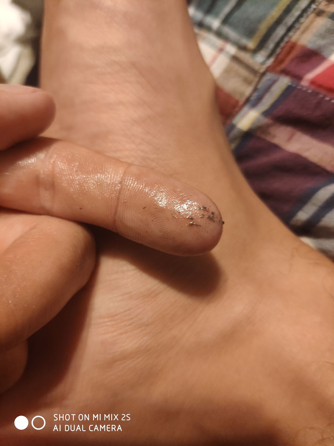

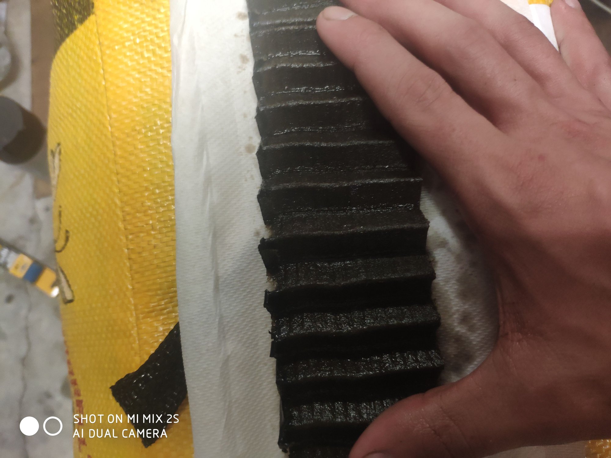

I got the filter off and to my eye everything looks good but I figured I'd post it and see what you guys think.
This is what I able to pick up with a magnet.
This is the filter media. If you guys think you need better pictures of it let me know.
