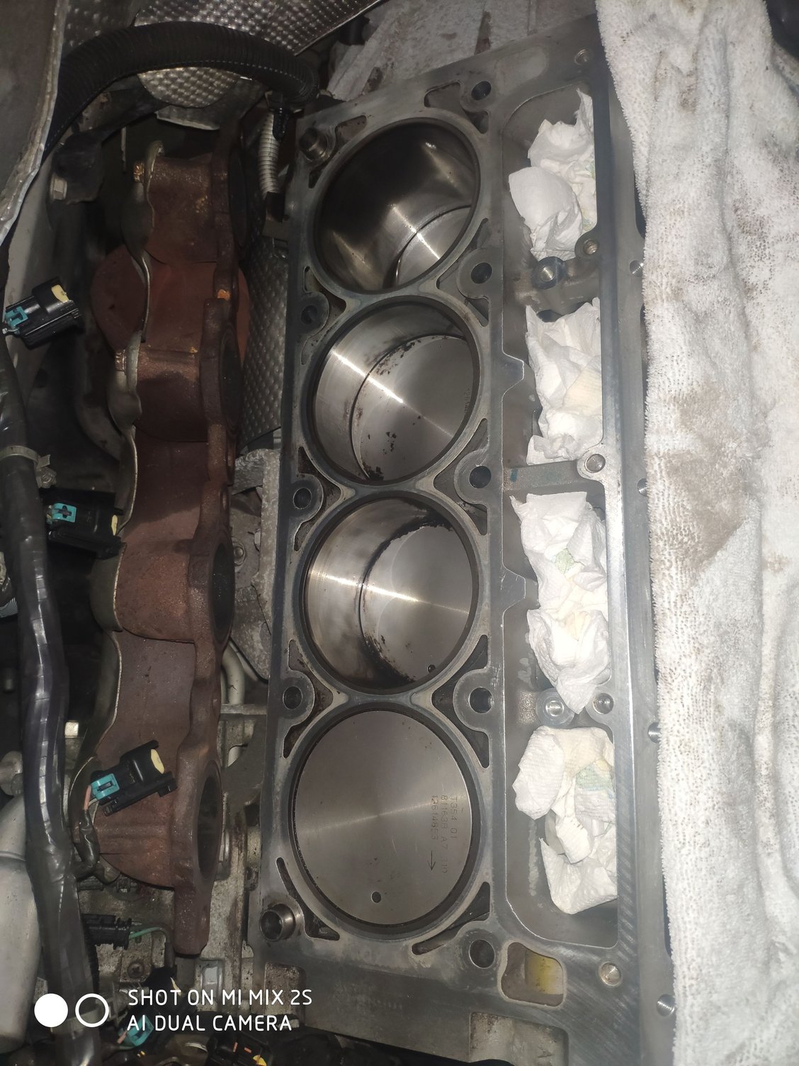

Is my block clean enough

Getting ready to install heads is the clean enough or an I in for more work. I am planning on cleaning the pistons a little more too.

Are you going nitrous or boost? The gasket seal is as good as your block and heads are clean. Mine looked about the same, I razor cleaned them and used carbuclean with a scrub sponge and I stock bolts and ls9 gasket and it hold just fine with 200hp shot thru it

REmember to blow out the bolts holes with compressed air.

I'm not running any nitrous, just a cam and I'm using arp head bolts and ls9 gaskets.

The question should be are the surfaces flat and true enough?

The block I can put a straight edge on and the heads got machined

Your good, run it!
