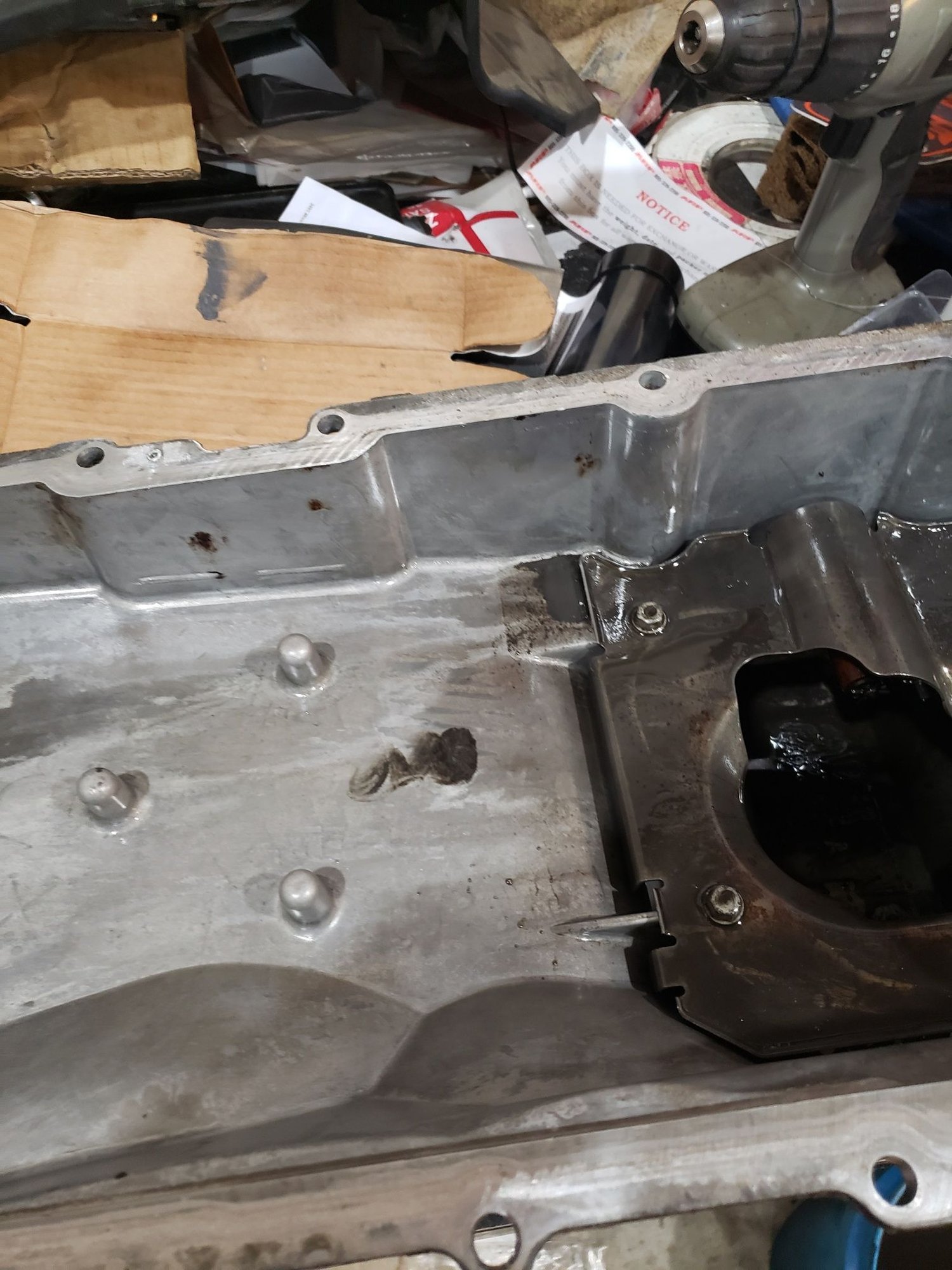

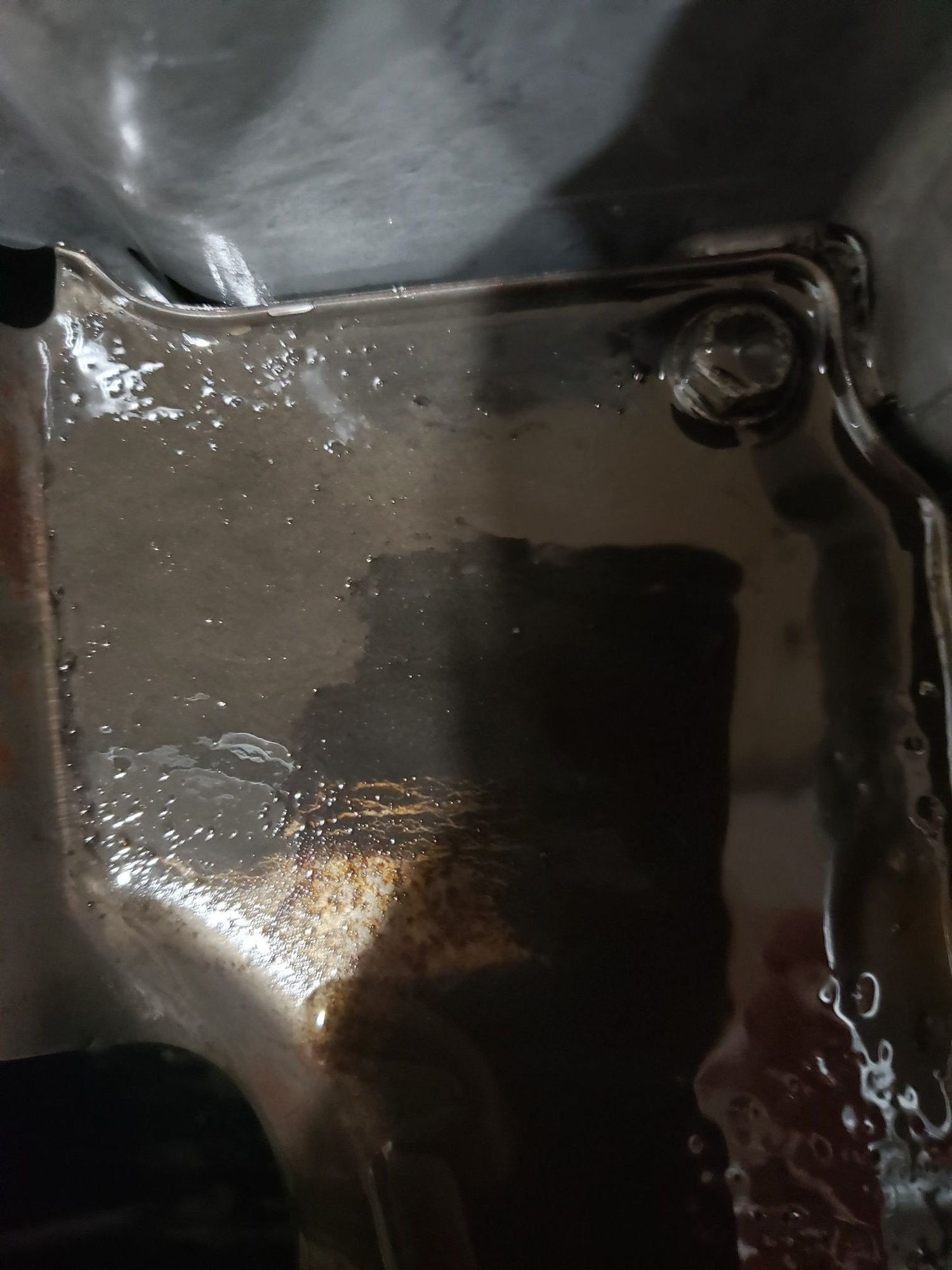

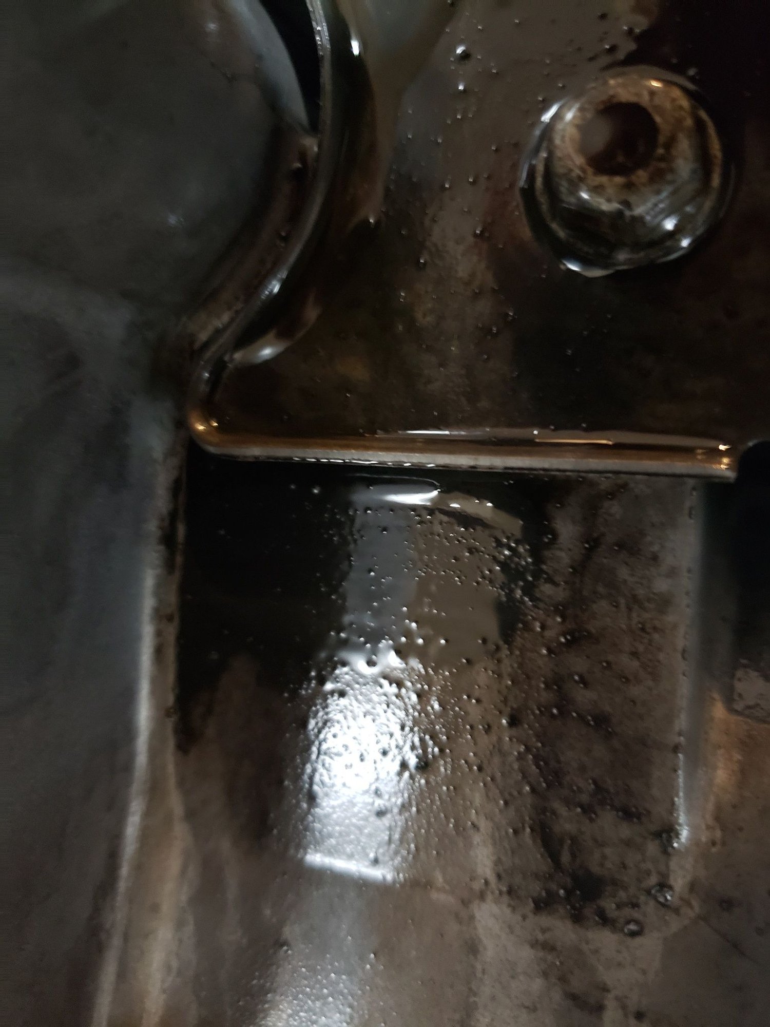

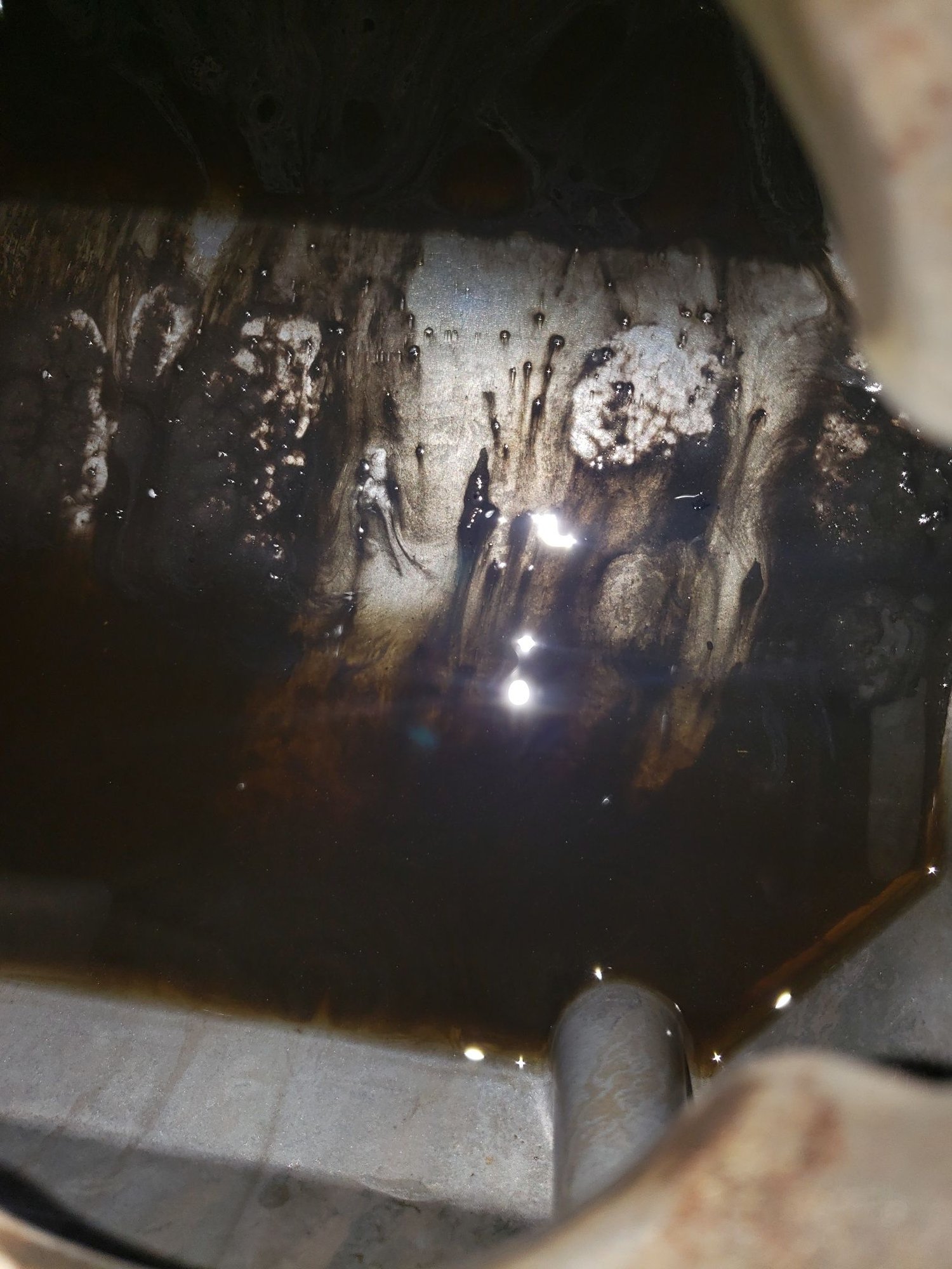

I will try to make my long story short, did a DOD delete, texas speed cam, lifters, push rods, oil pump etc... upon start up of delete, I only had bank 1 run, bank 2 was power but no ground, after a lot of codes( P0172, P0174, P0 352, P0354, P0 356, P0358) I found bad ground to coil packs bank 2, somehow all the gas that went down the cylinders must have washed the oil off the bearings, I drained the gas/oil and put fresh in, ran that 10 minutes and drained to see if I had metal shavings, see pics, what do you think, lots of trash...

Originally Posted by 07silveradolt
on a manual gauge, it is 30 at start then bleeds off when the loop closes and goes to zero, there is no pressure after the initial start...
Just thinking out loud here:
1) To truly be at 0 psi once you warm up, would take an absolute shredding of your bearings - like, no pressure (resistance to flow) at all.
2) if 1 was true, I would expect MORE metal in your oil pan - your pictures to me don't do this theory much justice
3) Does it drop to 0 psi the moment you hit closed loop? Something tells me you have an issue with grounds or some other electrical gremlins
But something loosely related: Those areas where it looks like you have metal on your pan - the bottom of my pan looks the same way - bunch of little permanent bumps etc, not actual metal.
Are yours actual metal you can pick up by hand/wash off? If so, then yeah, that's a lot of mess...
yeah, so over the weekend, I did get a chance to check things out, and you are correct, the bumps in the pan are the casting crap, looks like metal at 1st, filter was clean, but only had about 10 minutes run time on it. and at cold start right at 30 psi for about 230 or 30 seconds then drops to zero, if I keep my foot on the pedal I can keep pressure, which made m e thing spun bearing especially after having gas in the oil.
