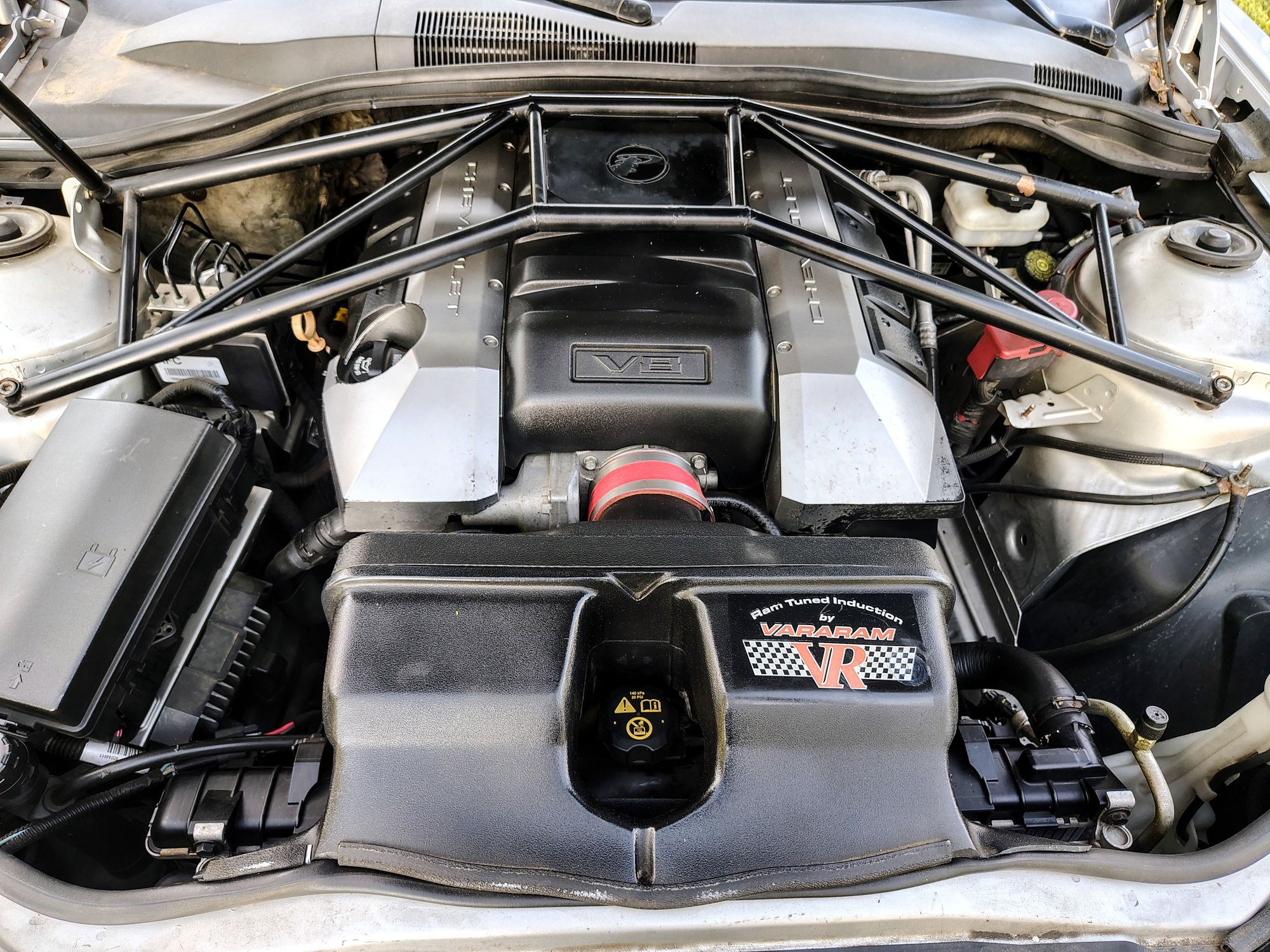

I'm running a 6.2.ls3 with a did delete an vvt delete an eldbrock 2 peace timing cover tsp delete with a pig tail that goes from 5 wires to 3 wires an a custom ground vengeance's cam 3bolt timing gear in a 2011 ss2 camaro.long tube headers no cats x pipe 3 in exhaust an I have to have the computer tuned.an it's 6 speed Hurst short throw shifter.ram air intake ari under drive pulley 40 over spec stage 3 clutch an I changed the AC Delco altinator with a new one an it was bad car went stupid I took it off an put the old one back on an new battery.now I have prolonged crank no cam sensor signal a knock code an cam sensor code I changed the cam sensor didn't help the car runs as good as it ever has but still have a long crank an codes an the car has 390 gears g force outlaw axles it has everything I don't know what's wrong trying to fig it out

Old Sep 4, 2025 | 08:16 AM
RB04Av's Avatar
Joined: Dec 2017
Posts: 2,190
Likes: 977
You say "long crank":
Does it start up right EXACTLY half the time; and the other EXACTLY half the time, it will crank forever and not start the first time you turn the key, but cranks right up IMMEDIATELY the 2nd time you hit the key?

It's starts Everytime but the first time u crank it it takes longer to start an it might backfire alit before it starts an after that it starts faster but still not as fast as it did before it spins alot longer now

OK, so it's doing EXACTLY what I said then, right:
First time you go to start it up, EXACTLY half the times you try, it cranks forever and a half, and only spits back into the exhaust, if anything; but then you turn the key again, and it starts RIGHT UP? And EXACTLY the other half of the time when you go to start it, it starts like normal?

Yea that's allmost all right except it never starts as fast as it di before it spins over longer but yea close any thoughts

Since you said you changed out the cam sensor, it needs a crank relearn.
It behaves like this because it knows from the crank sensor which cyls are at TDC, butt DOESN'T know which half-rotation the cam is on; so EXACTLY HALF the time, it tries to fire off #6 when #1 should be firing, etc.; each of those pairs of cyls that come to TDC at the same time, butt only one is firing, while the other is just closing the exh valve and opening the int. EXACTLY THE OTHER HALF of the time it guesses right the first time. Although I don't know the EXACT logic the ECM uses, apparently it's smart enough that if it knows that it isn't sure about the cam signal, and it doesn't start the first time you hit the key, it guesses that it guessed wrong, and changes its guess to the other cyl of the pairs at TDC at the same time; and lights right off.
Kinda the equivalent of dropping in the dist 180° out in the old SBC, except EXACTLY half the time.
When you get your tune, let em know that it needs a crank relearn first.

That's why this happens. Replacing it changes its output signal, and the ECM may have to relearn its coordination with the crank sensor. Until that's done it can be confused.
