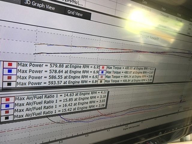

Older PM. Factory intake is good as long as you stay inside the *factory intake RPM window*.
https://www.instagram.com/p/BnKJ5amn..._web_copy_link
Thanks for sharing! I suspect the additional cubic inches will reduce the RPM window quite a bit.
