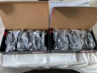

Brand new Brian Tooley springs are in.

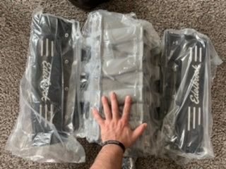

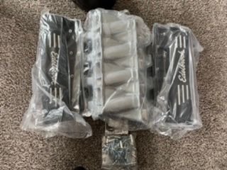

Massive cross ram intake from Edelbrock. Should produce great torque in my heavy Denali.
