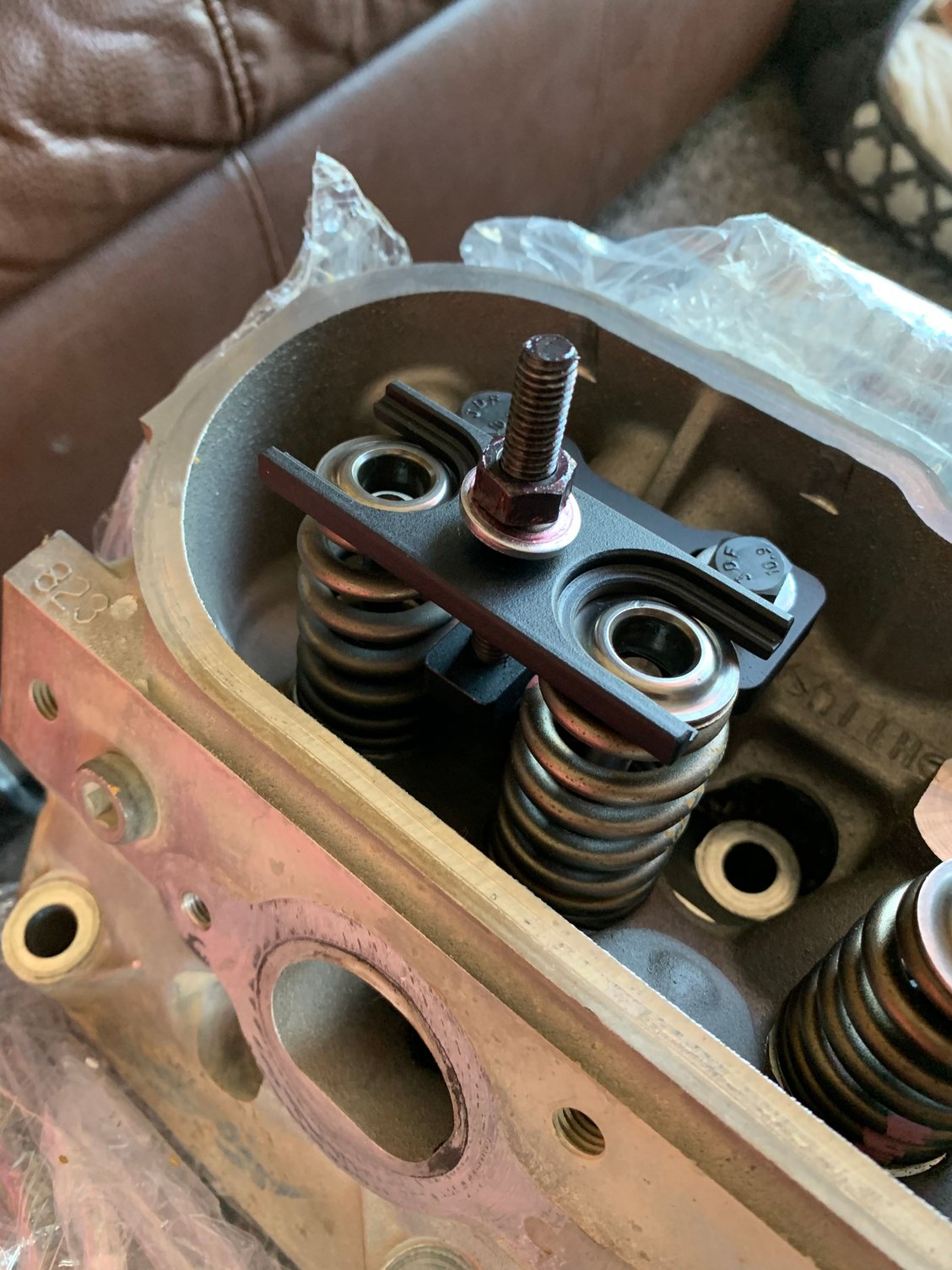

Default 823 Head breakdown
Got my 823 heads cleaned and disassembled. Super easy and straight forward. Used the LS valve spring compressor tool from Bluegrass Performance.
got the heads wrapped up and ready to be sent off to Frankenstein to let them work their magic.

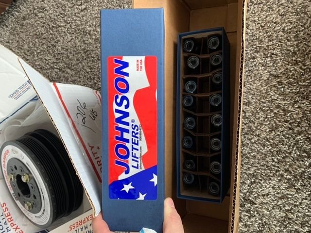

Adam, were those lifters available at the time of ordering or did you have to wait on them? I could not find Johnson lifters anywhere a few weeks ago.
Old Jul 13, 2020 | 05:57 PM
  #87
Adamjs24's Avatar
Joined: Feb 2020
Posts: 60
Likes: 12
I ordered mine from Brian Tooley Racing, but they did tell me that Johnson was behind, because of all of the shut downs, so I waited I think about a month or so before receiving mine.

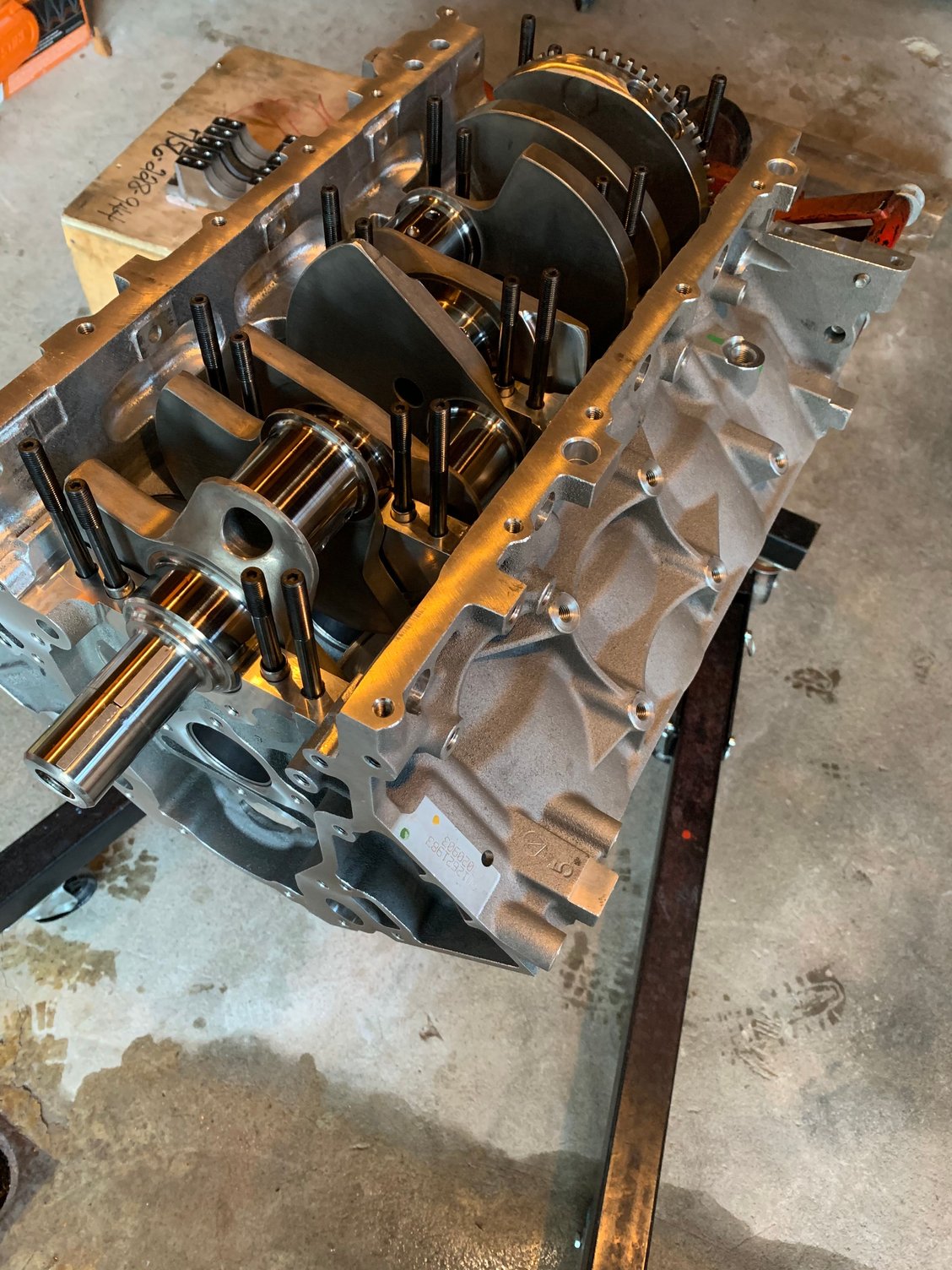

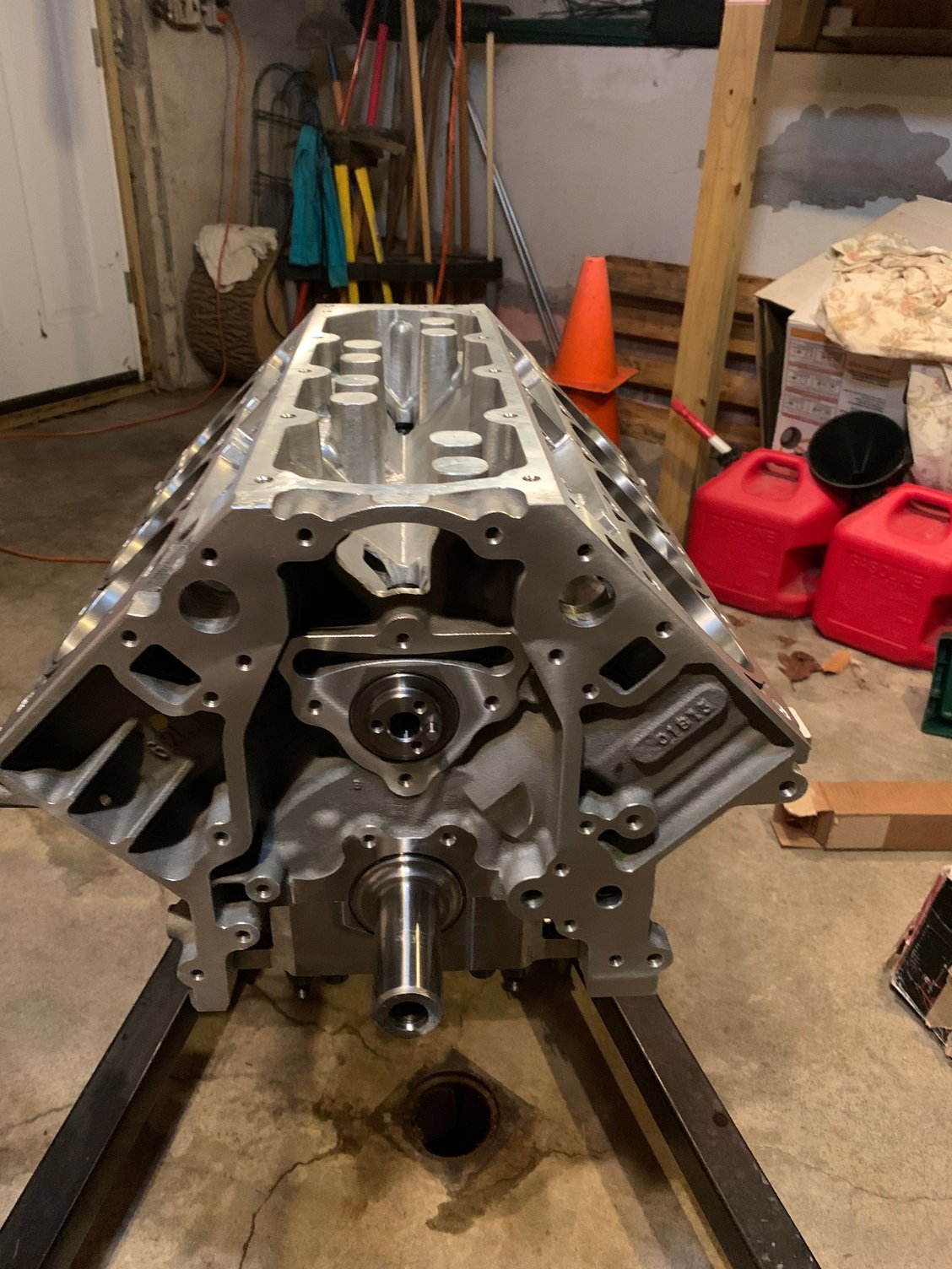

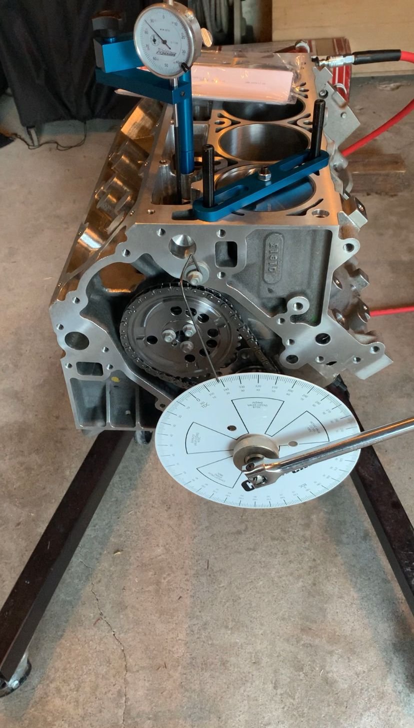

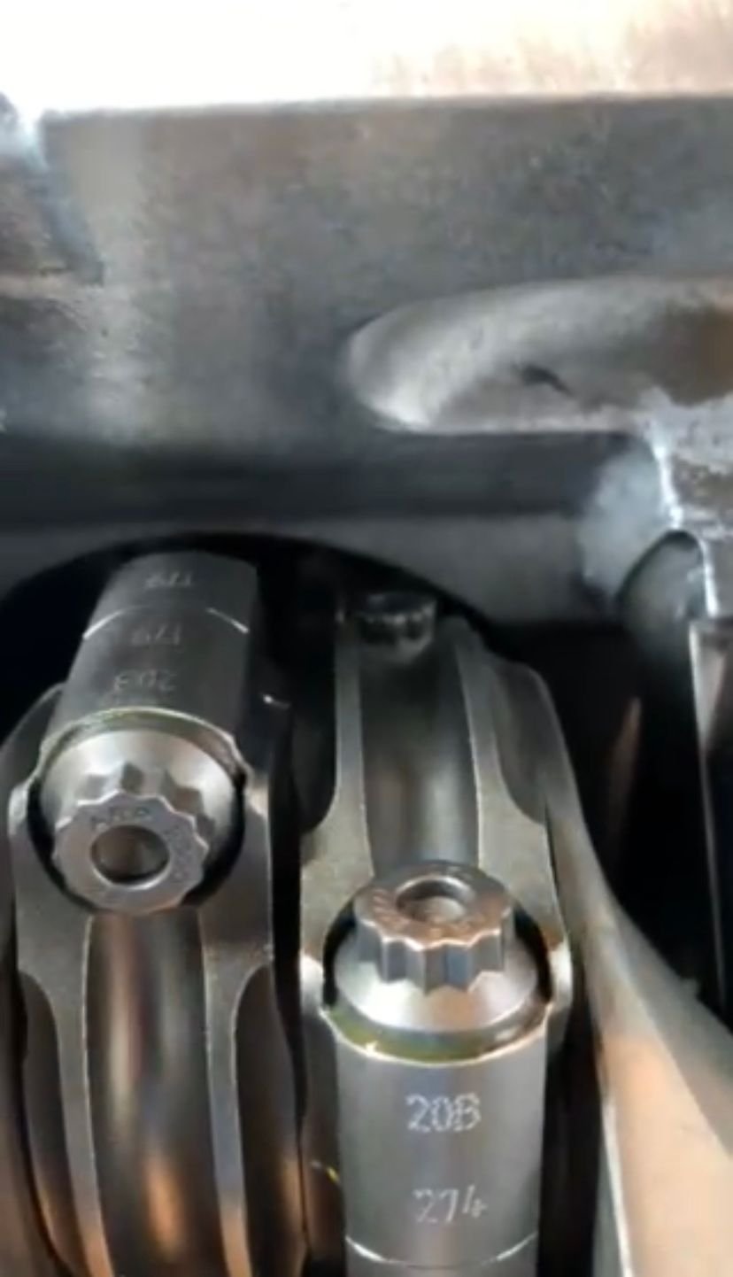

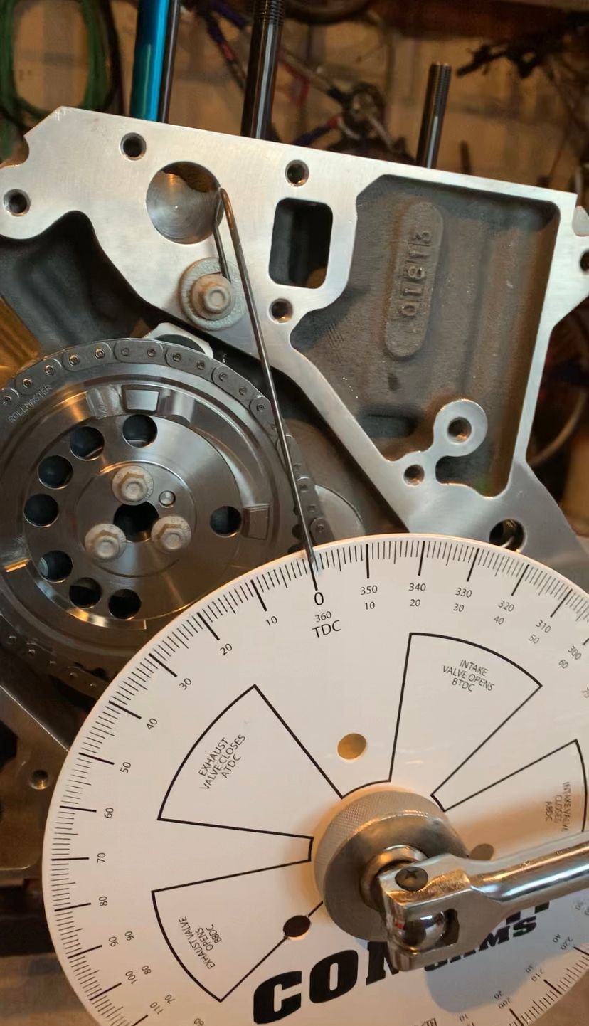

As you all know, life happens, and builds always take longer than we expect, especially with this covid bs year 😵

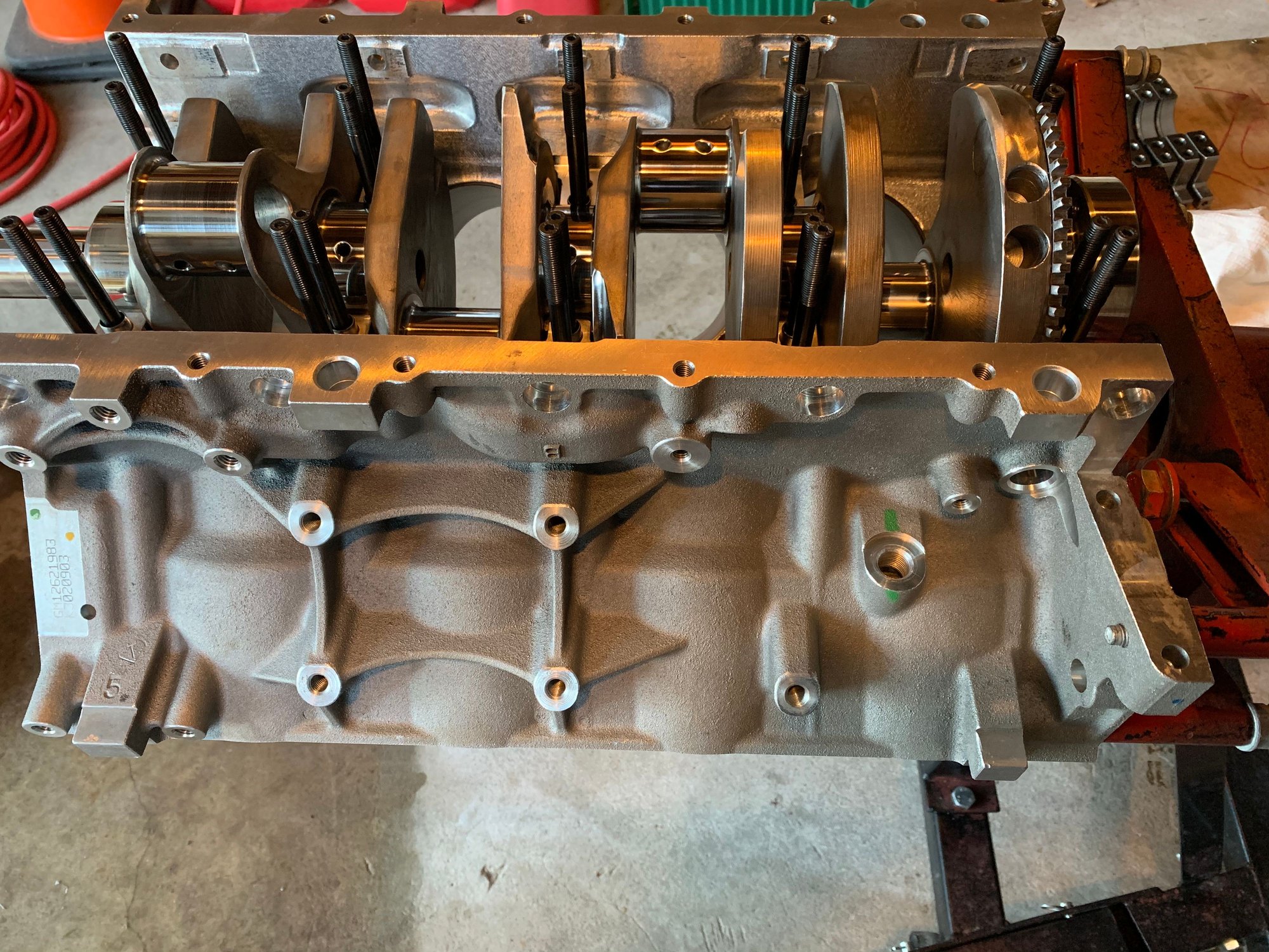

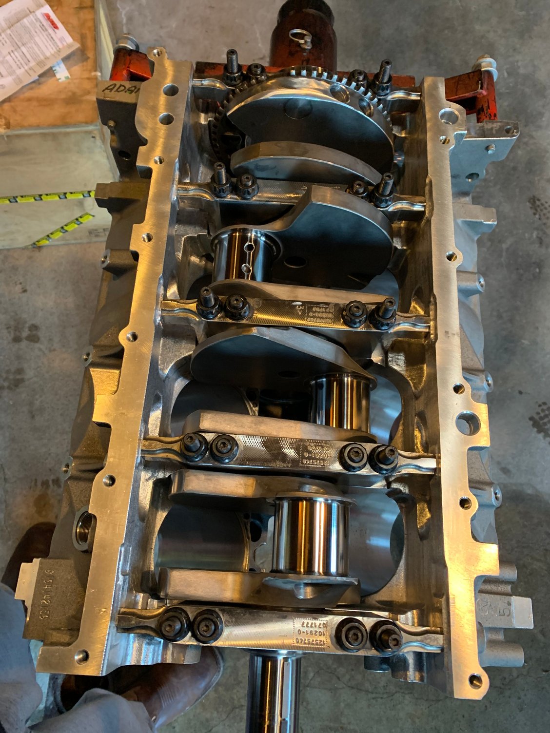

So What’s new? Have the machines block. Have heads back from Frankenstein. Everything has been cleaned and I’m doing assembly now.

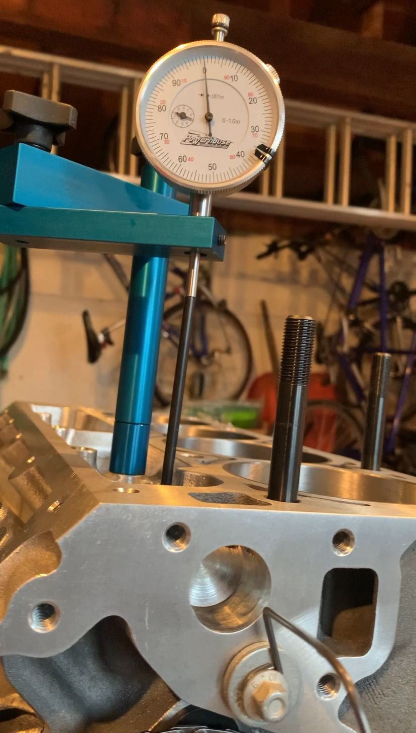

Currently degreeing my cam and getting a bit frustrated. I have the comp cams degree kit and i and getting and intake center line of 107.5* the card states for 109* intake center line. And I doing something wrong? Is this just stacked tolerances adding up? I’m going to re-degree to see if it changes. Cam specs are 219/235 .607”/.621 lobe separation is 113 and it is ground 4* advanced.
here are some pictures of progress

Attached Thumbnails L92 Stroker new build-47a0d66a-46e7-47a8-82df-794445966712.jpeg
