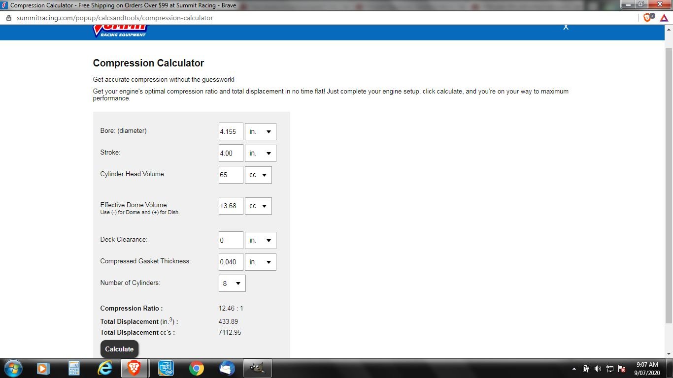

Cool. So unless i'm missing something it calculates as 0.040 head gaskets needed for 12.46:1 CR which is more than decent.
Send a screenshot of the measurements you are using.
I'm getting 12:6.1
I'm getting 12:6.1

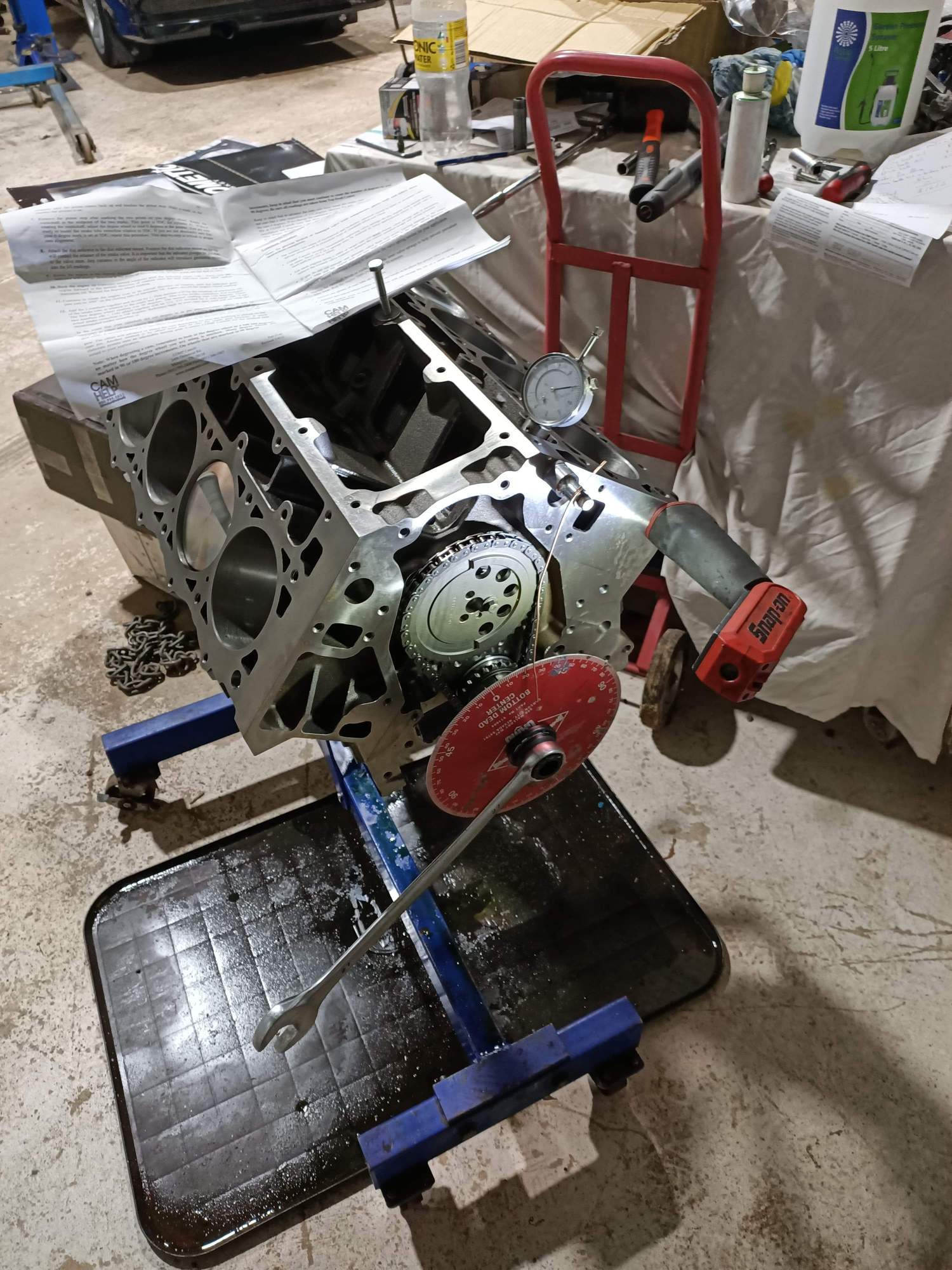

Guys, I got some updates.
I will post pics later on as I have quite a few to show.
Camshaft degreed in almost perfectly to 109.5 ICL. (110 ICL is stated on the cam card)
My builder also wants to install a 4 point steam kit too.
Heads are on the engine too and look great.

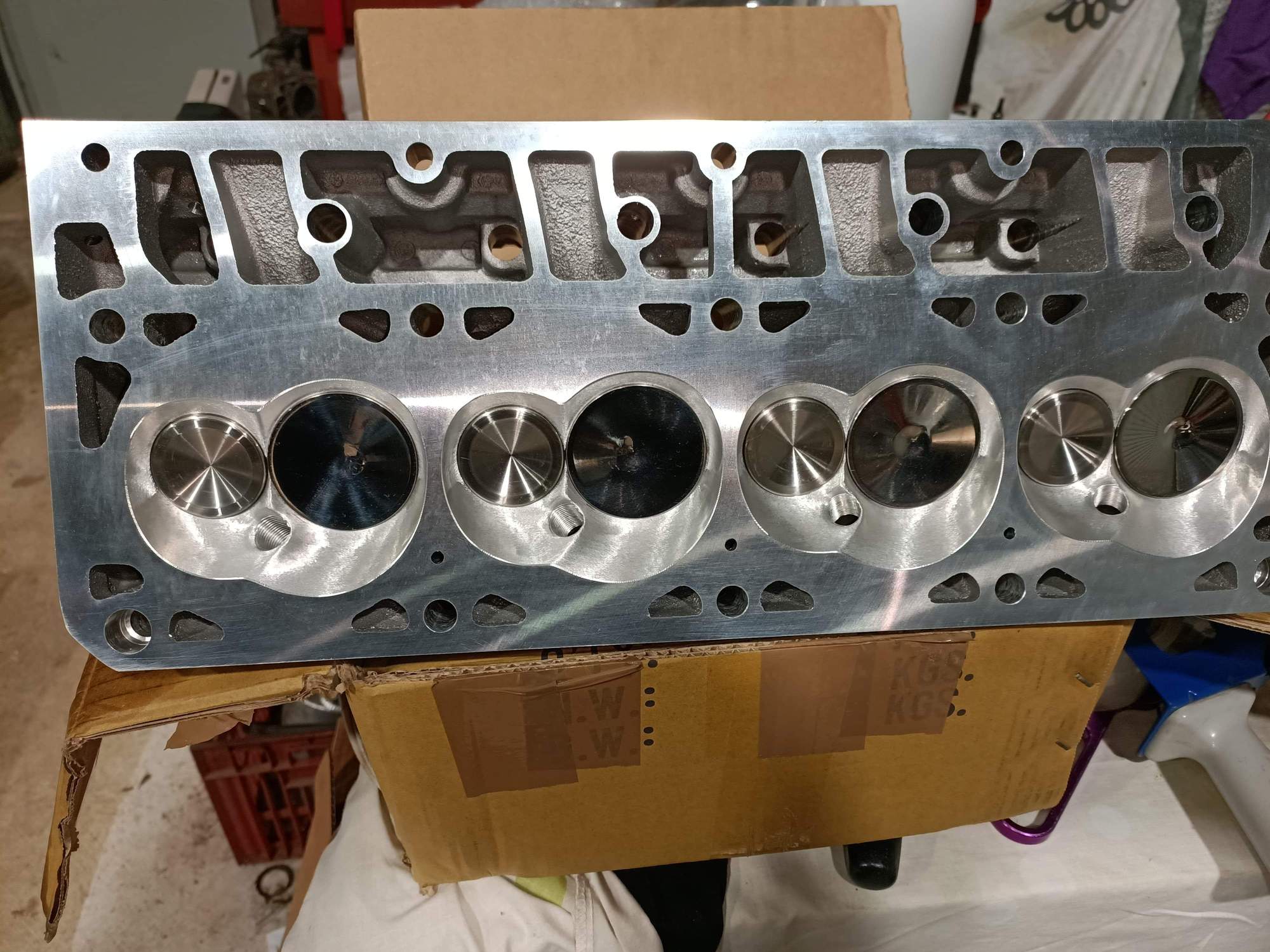

My builder also said, Tony's work is like magic.
He studied them before he fitted them and he was super impressed with the attention to detail and the artwork done on the ports.
He hasn't seen anything so meticulously done.
It's rare to hear him say he is impressed with something.
It's good news.

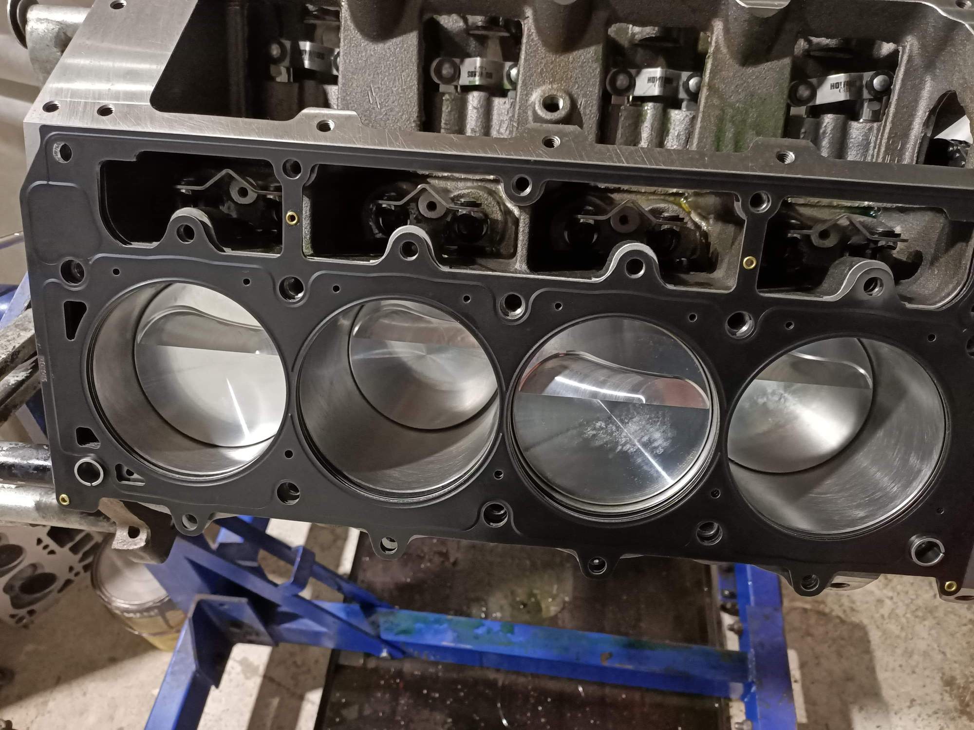

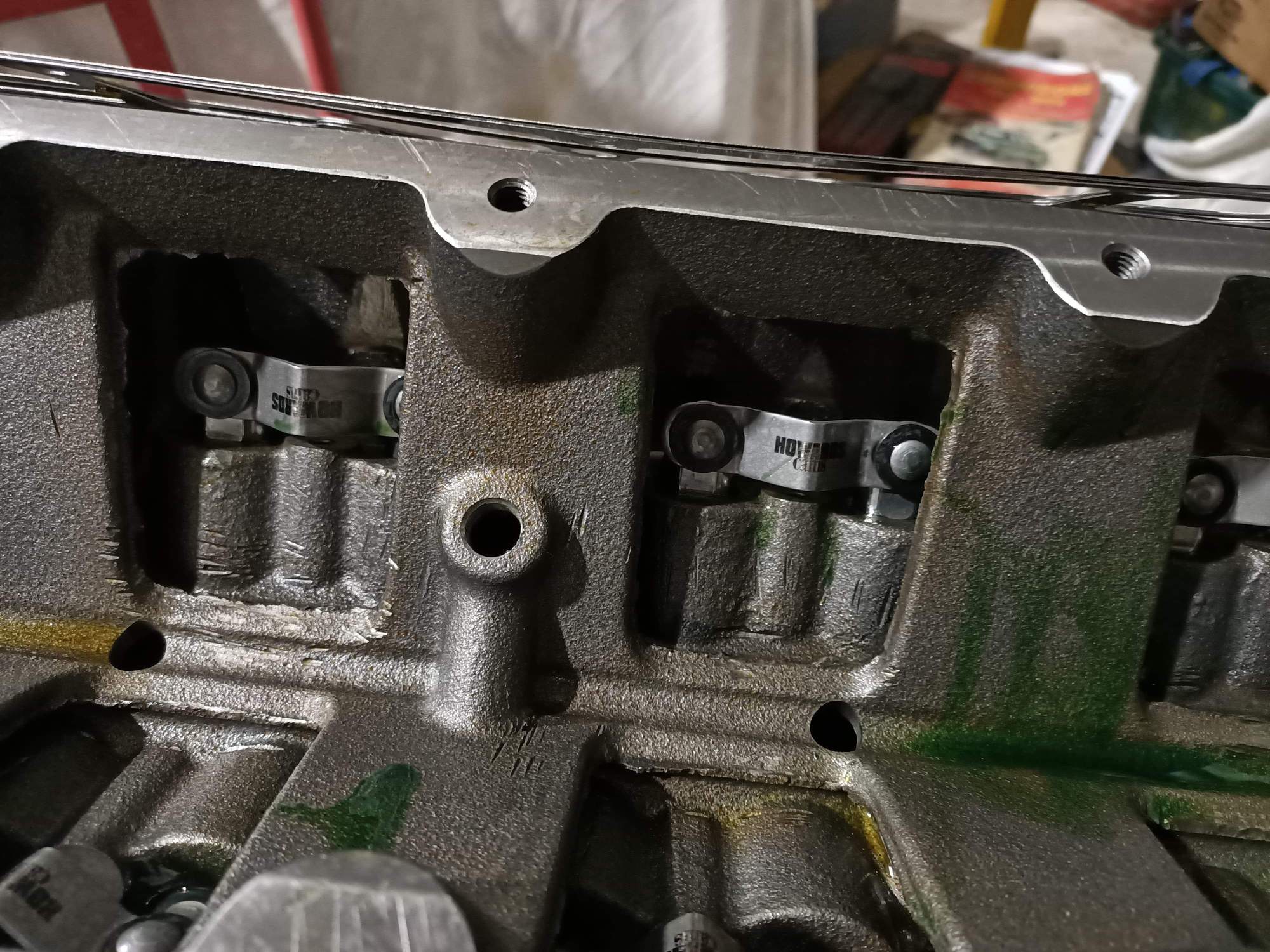

Here are some pics of the engine of the current work:

Have you tried to remove the link bar lifter from the window bortus? I'm curios if its even possible.
Old Jul 14, 2020 | 08:34 AM
  #555
bortous's Avatar
Joined: Sep 2010
Posts: 2,898
Likes: 467
I have not seen my engine as in those photos.
They were from my builder.
Looks like the lifter hole at the front has to be slightly modified as per Dart's instructions.
I wonder if you can get axle oiled lifters in that body the Dart Block requires.

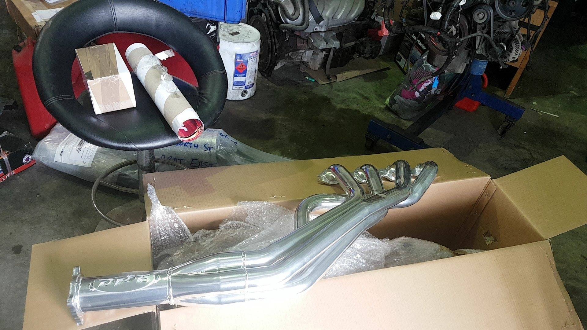

I thought to include a pic of my nice 1 7/8 Diflilippo Ceramic coated headers:

Looking good man.

Also compression ended up being 12:46.1.
A .040 gasket was used after all.
Not a .051 as originally stated.
Looking good man.
Thanks,
You were right with the compression too.
