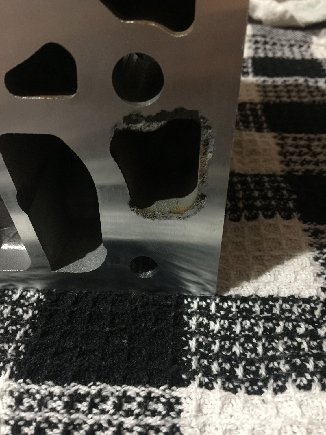

Looking for a little advice. Just got a set of 243 heads back from CNC porting and I noticed pitting around one of the water jackets, I hadn’t noticed it before dropping them off. Wondering if there’s enough there to still seal or if I should look into building the area back up.

who did the work?
i would imagine most places would tell you something was up with your heads, and they couldn't use the core.

Ehh very close to the head bolt hole, probably should be welded

Lay a gasket on it and see.

I think a gasket sprayed with copper gasket spray should work just fine.
